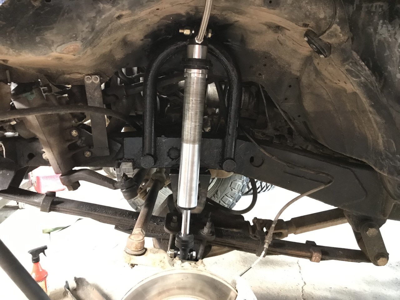

    Fronts are both in and test drive complete. The difference is astounding...the black magic that goes on in these must be only second to the black magic that happens in an automatic transmission. They flat out work

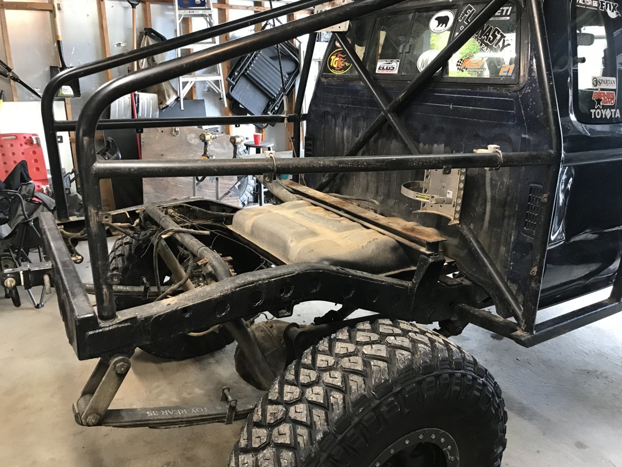

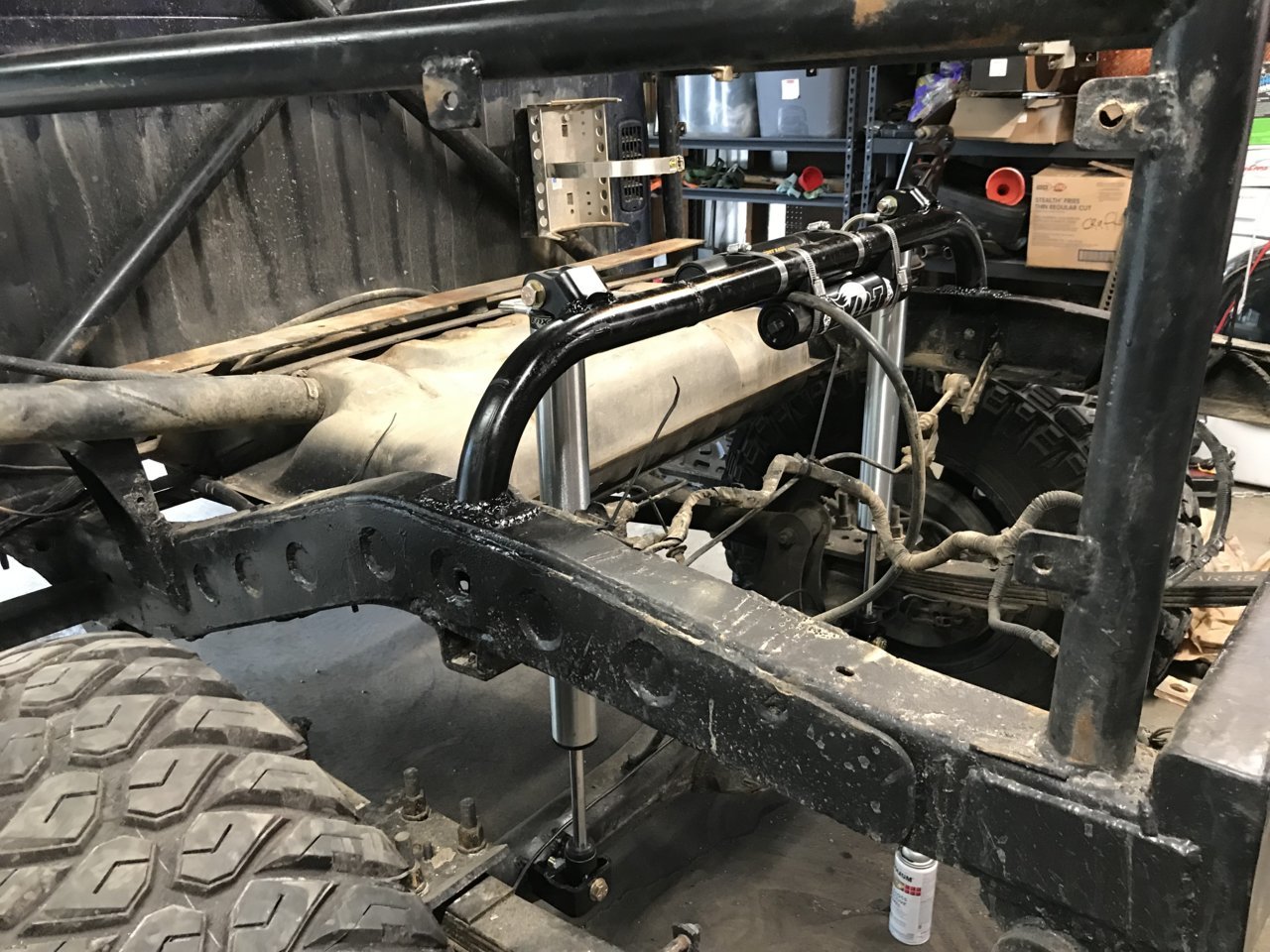

    Taking some stuff apart today and redoing the rear shock mounting for the fourth(?) time since I’ve owned the truck

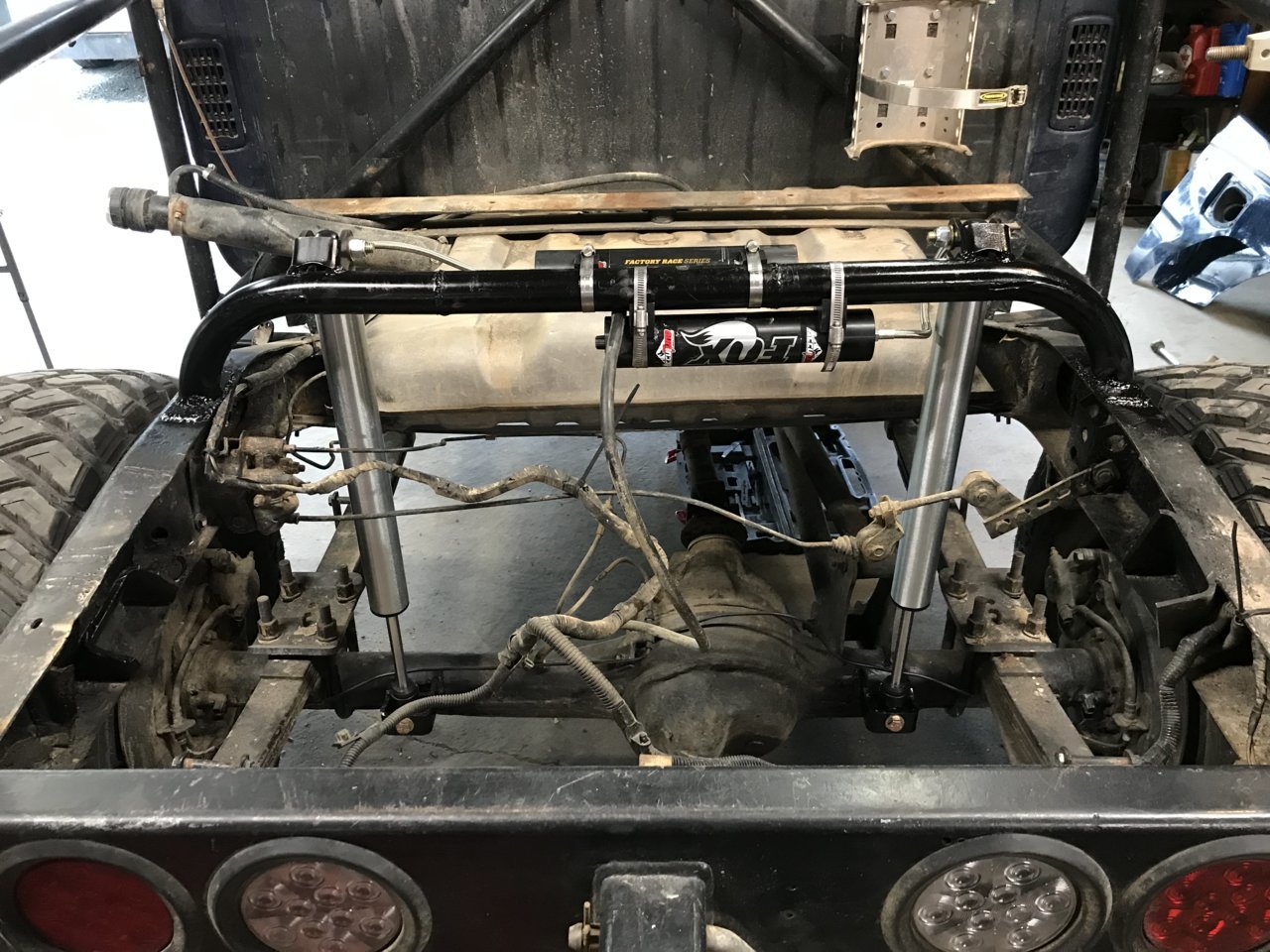

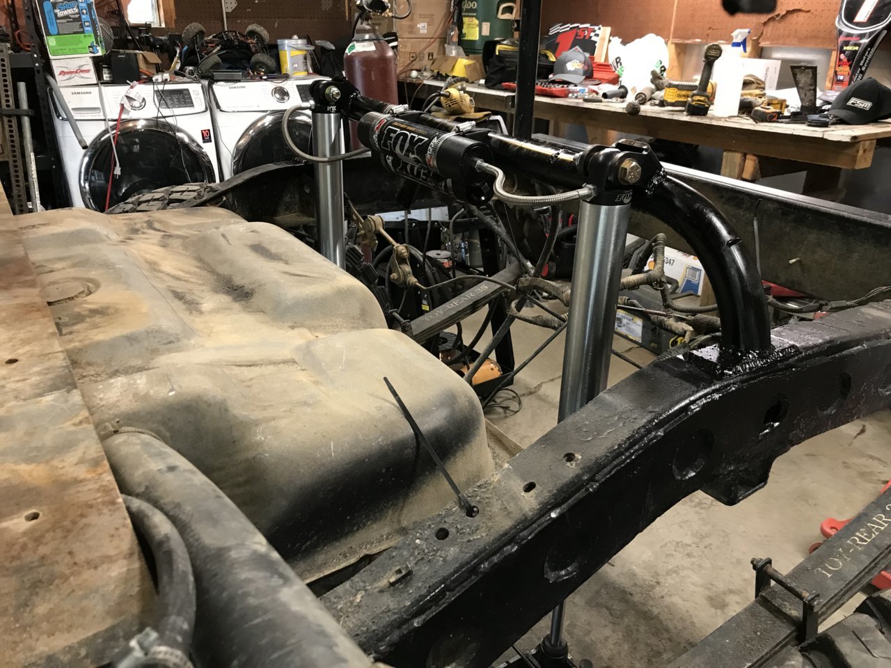

    Yep, moving the shock bar to the top of the frame and using some Barnes behind the axle lower mounts to bring the shocks up and out of the rocks some. Also getting the shocks straight up and down like they are supposed to be. Giving up my completely flat bed deck but it’s worth it

    Shocks are in! Just need to set bump stops and limit straps now

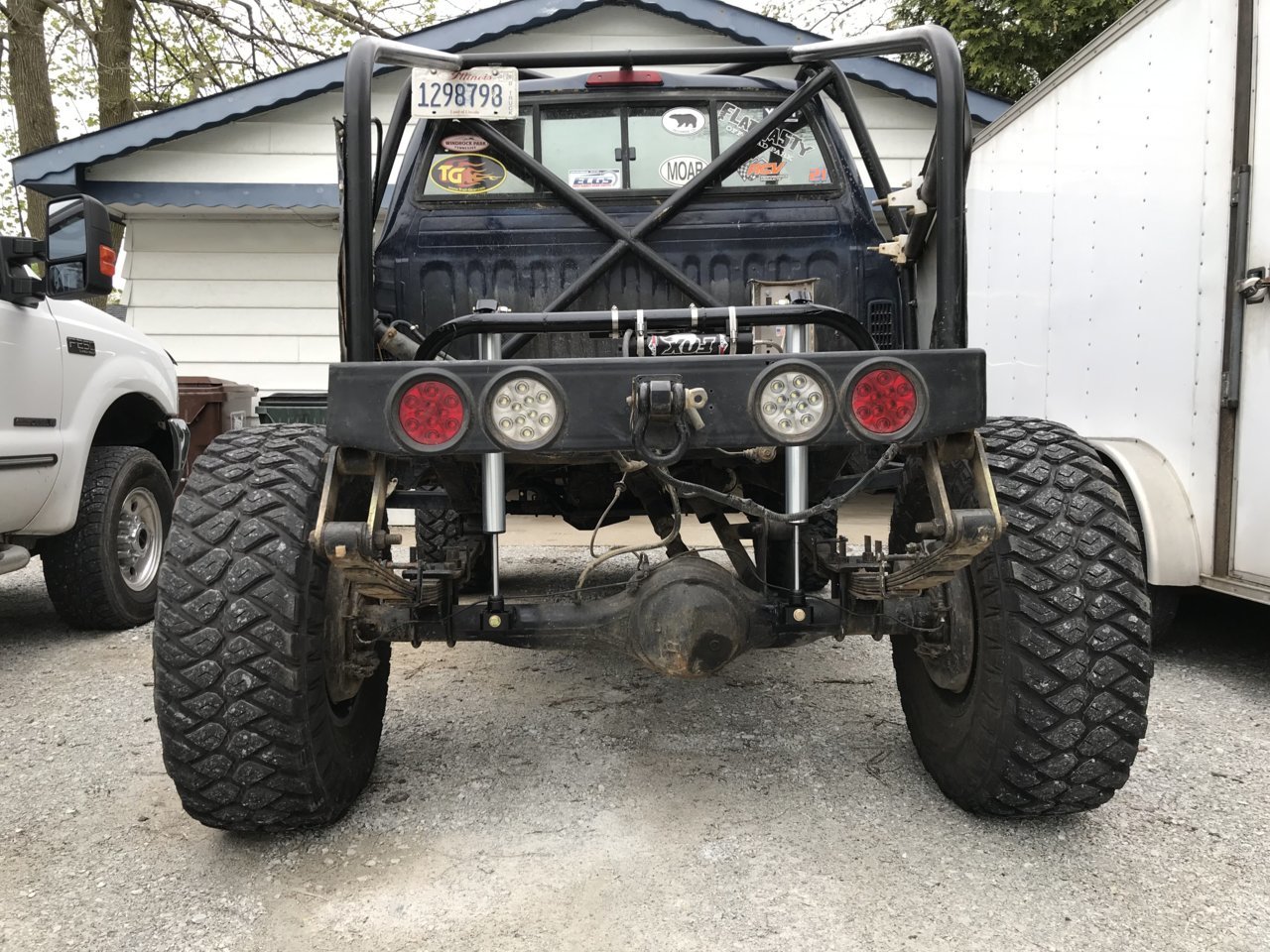

    Truck rides wayyyy better than it ever has before. Accutune and Barnes4x4 were both awesome vendors that got me what I needed with helpful advice and shipped quick!

    Barnes 4x4 is awesome in terms of product and their customer support
    I love the truck :thumbsup:

    Thanks! I’m super happy with their behind the axle brackets that are double shear and keep the eye perpendicular to the axle

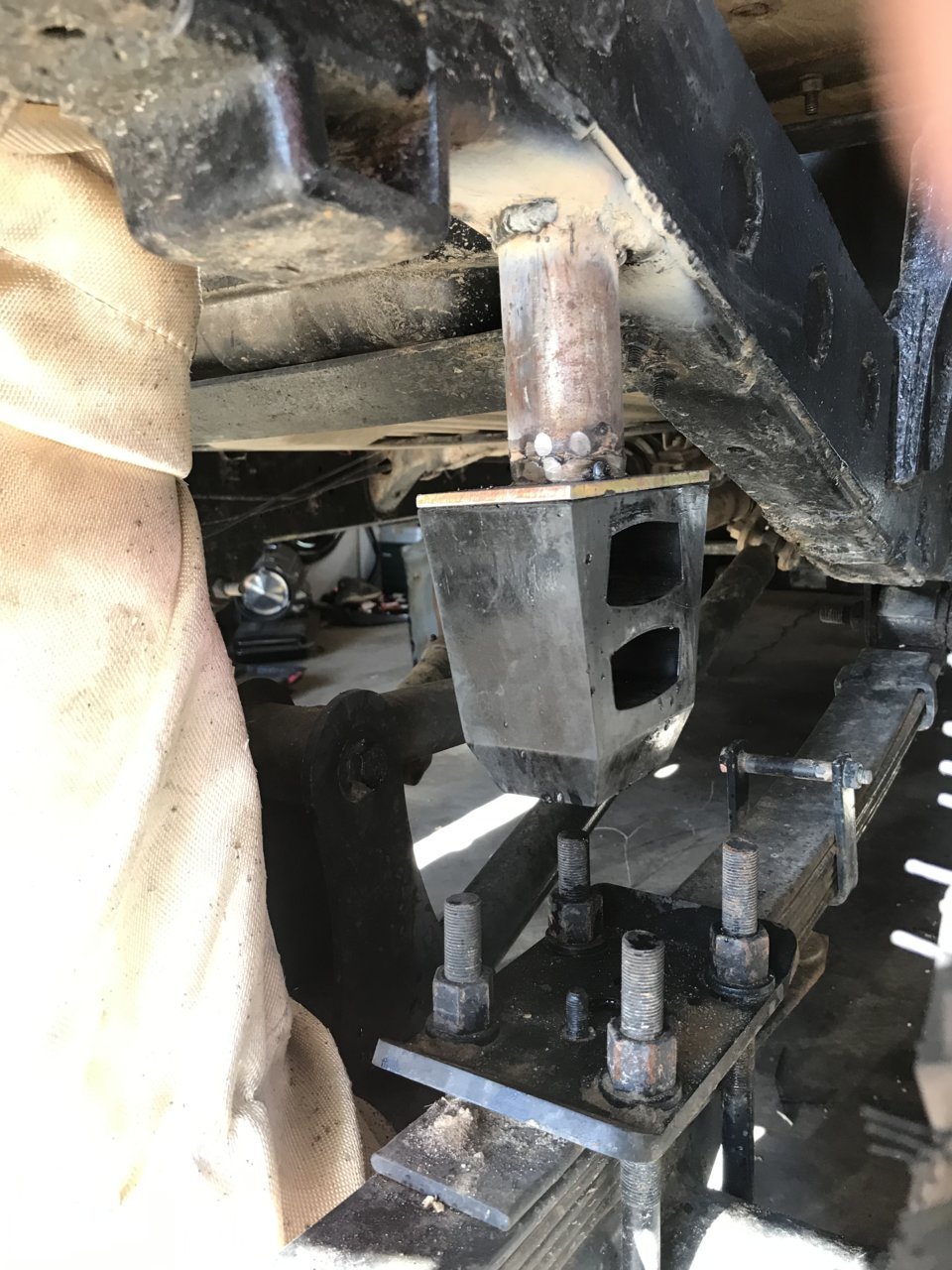

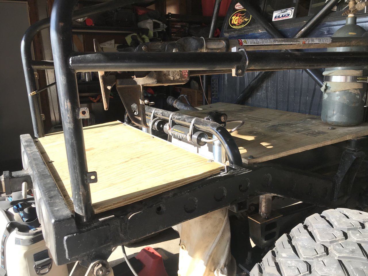

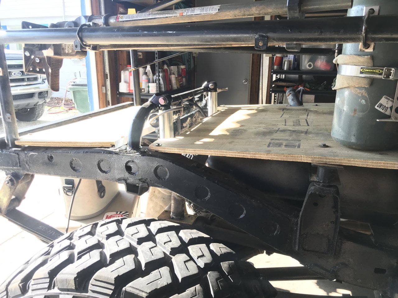

    New bed floor is done. 3/4” treated plywood with some aluminum angle for center support. I thought hard about changing things up and adding lockable storage in the bed deck behind the axle but this was $12 so...here we are.
    And one bump stop is burned in, just need to knock the other side out this week. Only had these on the shelf for 3 years before I did something with them. :rolleyes:

    Bump stops are welded in and painted. Limit straps will be here next week and I’m all set.

    Would you even need limit straps? My front shocks are way the hell too long and the spring stops unloading way before the shock Max's out. Or is this for when it's taken off some sweet jumps hurled into the air with all 87hp?
