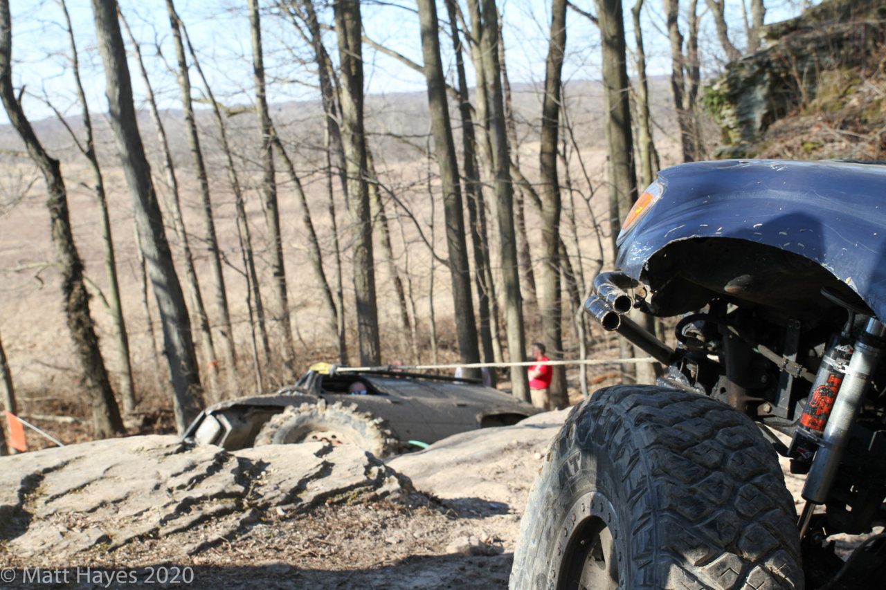

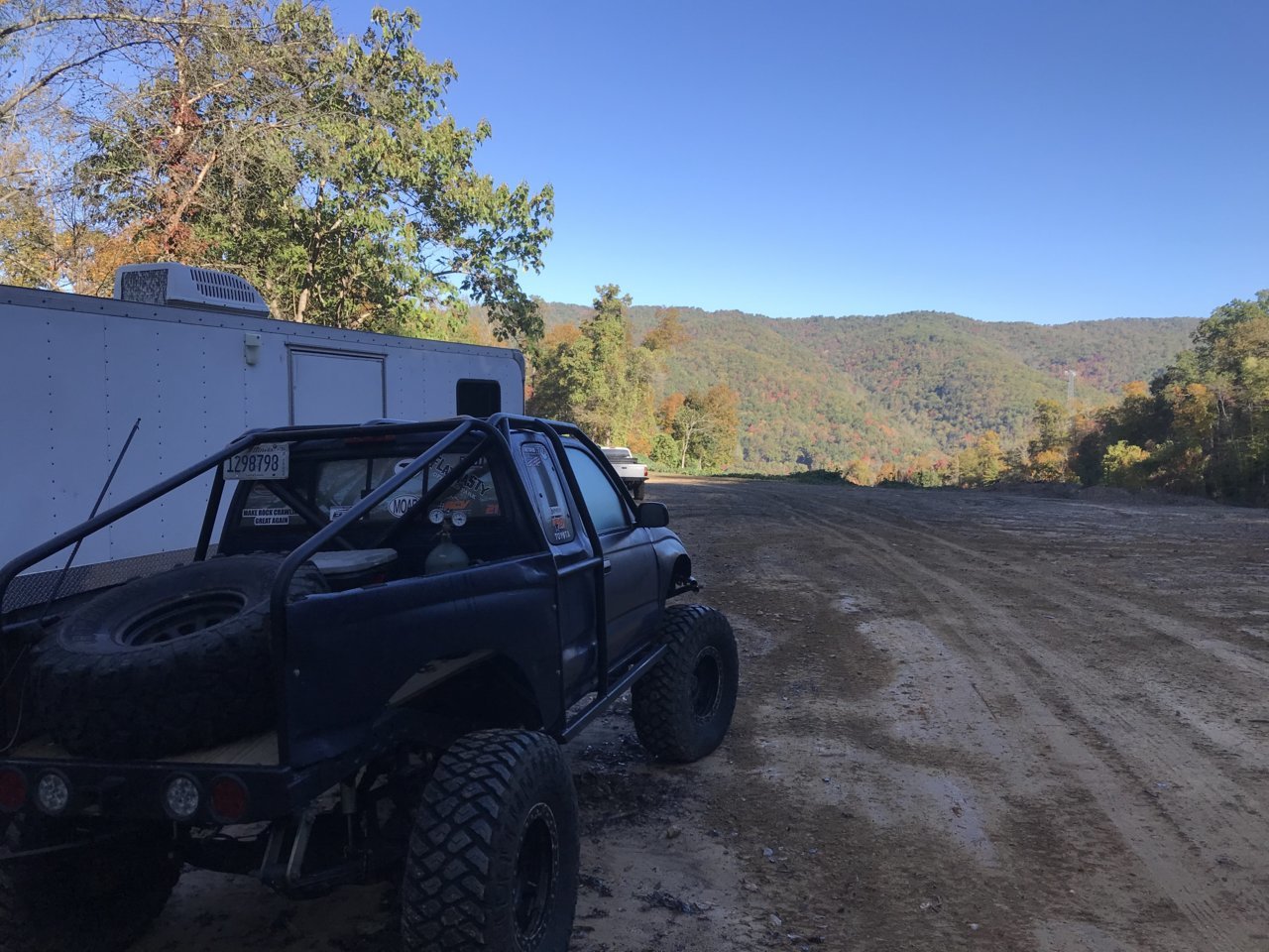

    Went on a couple trips to Harlan and Flat Nasty, took very few pictures as usual but had a great time on both. Made a road trip out of Harlan and hit some distilleries along the way home. Great way to spend a week in KY during October
    The trailer works awesome and sure is nice for heat retention. So far I've taken in refugees on both trips and hosted a party during a rainy night at Flat Nasty. A propane Buddy Heater is the ticket for heat compared to running the generator and electric element heater.

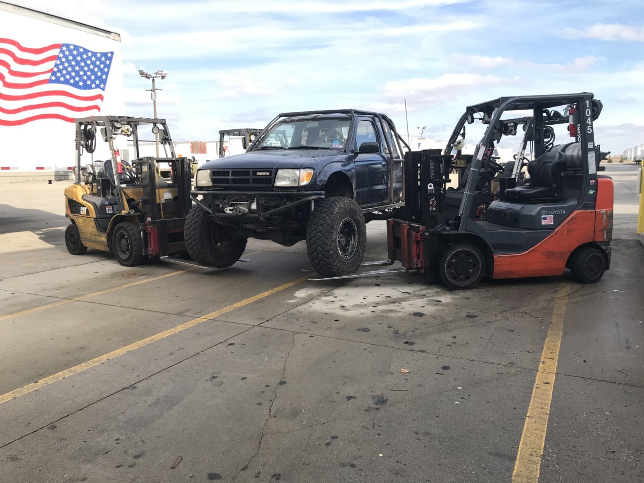

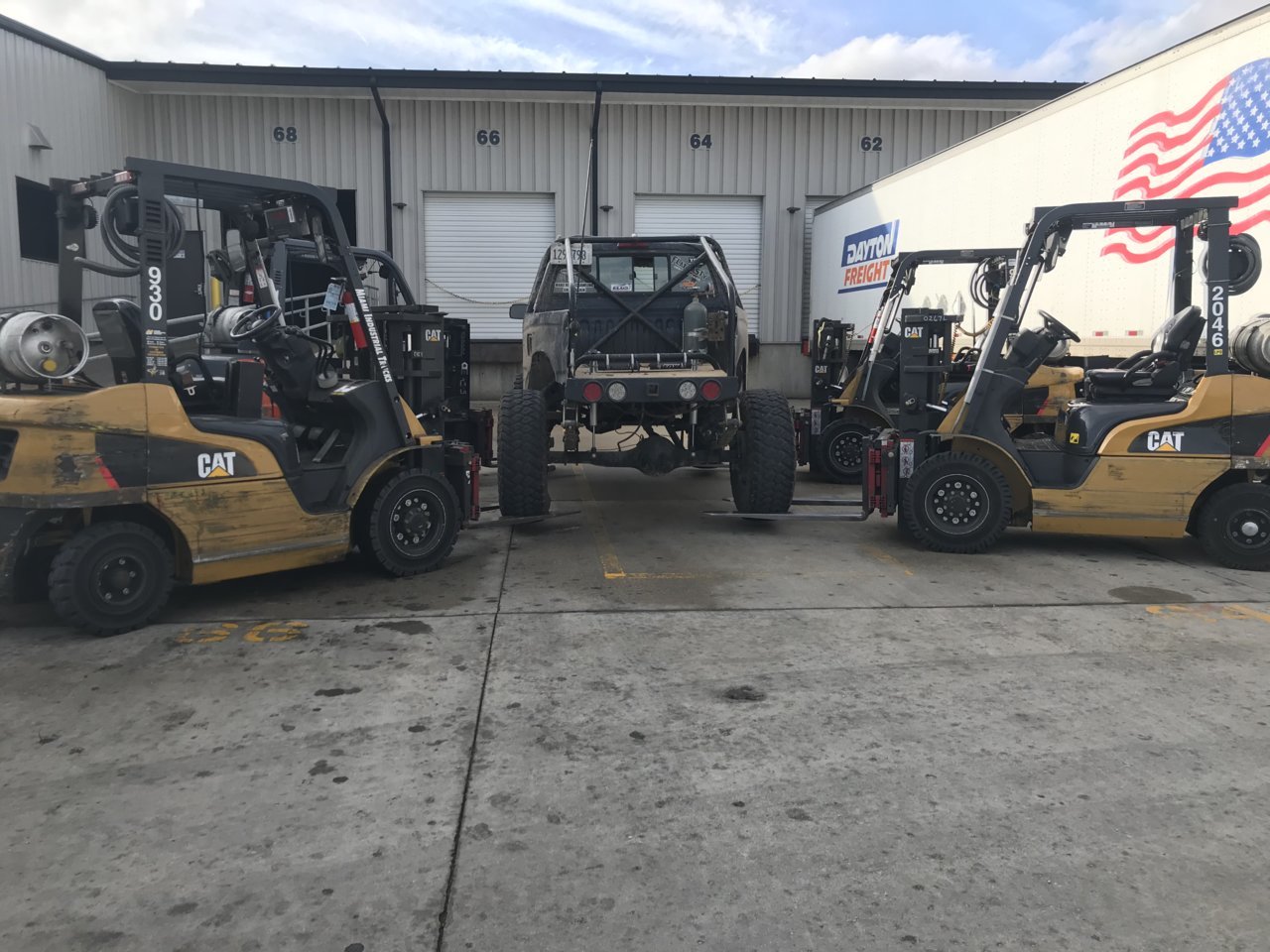

    Needed corner weights for shock tuning and I don’t have race scales...so this seemed like the next best option and free.99 at work. Truck has gotten fat. 4490 without me in it...apparently the 80 axle and 17” beadlocks are heavy compared to 15” steelies and the stock tacoma rear axle that I had last time I weighed it.

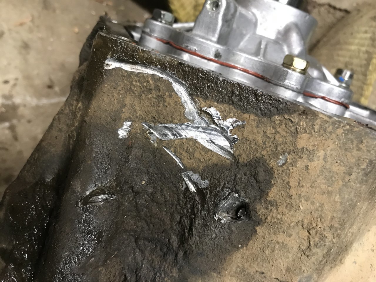

    Driveshafts double as nice sawzall’s...Fortunately I had a spare case in the garage to swap in for this one.

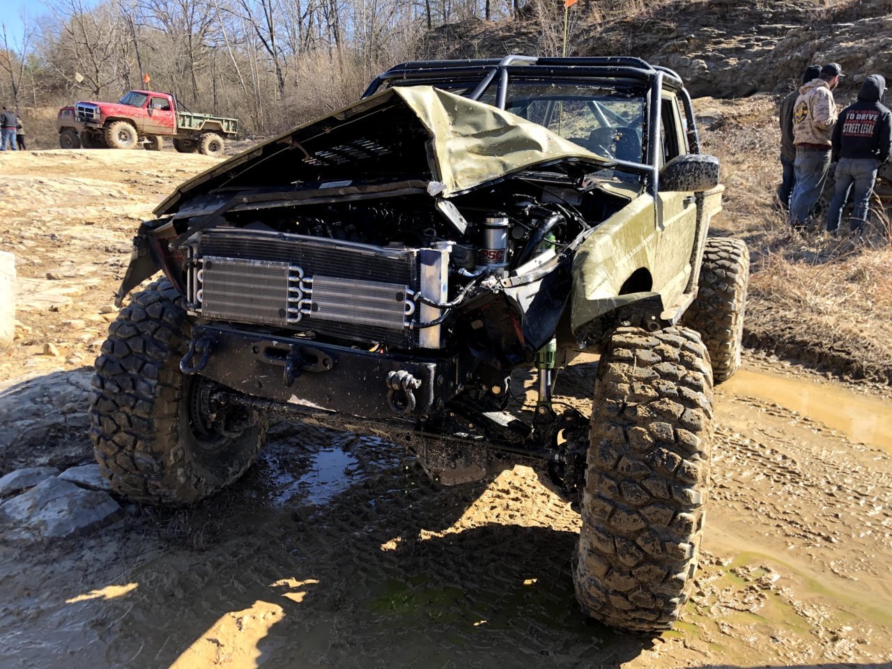

    Where are all the pics of this alleged carnage fest?

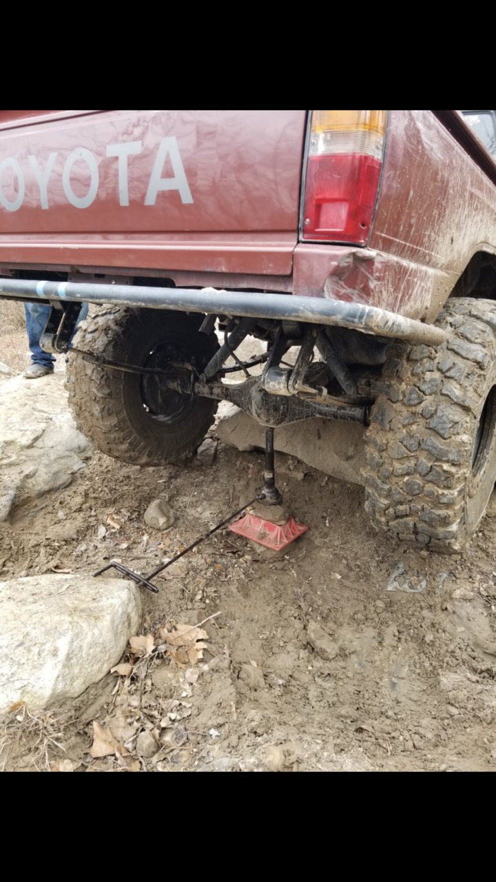

    I broke driveshaft bolts and it turned into a sawzall as they broke. Found all the heads so it wasn’t a full on Todd maneuver but they were 10.9’s I had picked up from Menards in college. Lesson learned on oem bolts only.
    Was hearing a funny noise from the RF when I drooped out. While I was under the truck today I noticed the frame was 75% broken around the shackle hanger so that explains the noise as it was peeling away from the frame. Pain in the ass to fix since the frame is so thin and it had pulled apart a decent amount.

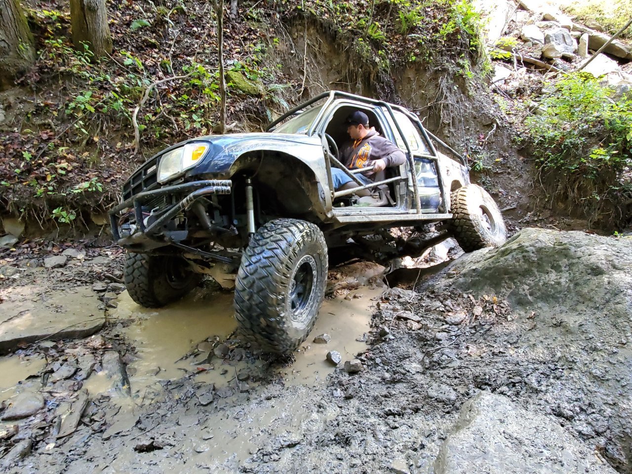

    It was the trail behind the quarry where you broke winch line a couple years ago. Made us all it’s bitch. Toyota bottle jack and a couple rocks came through to save Rome

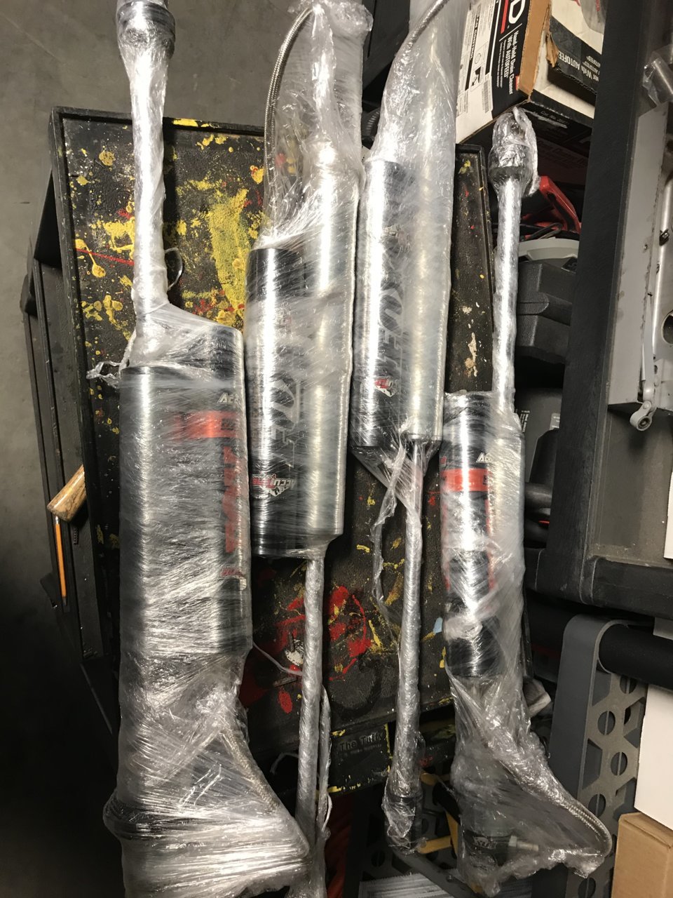

    Shocks are headed back to Accutune for a re-valve. Having them soften the rears up a touch. They ride great with a little weight so a little adjustment should do the trick.

    Things are starting to move and a box of goodness showed up... Definitely valved softer than originally delivered so I’m hopeful the Tacoma will ride even better now. Accutune was extremely appreciative to have corner weights

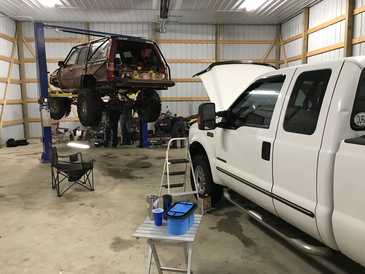

    Pulled the tcase again, the one I originally installed had some funny vibes and wasn’t shifting well at all between low and high range. Fluid came out super nasty after just a couple trips around the block too so I think it may be rusty inside. Another used case installed and it’s 100% better. 2.5 hours from the driveway shuffle to get in the garage to pouring a beverage watching the shootout at KOH.
    Checked off some odds and ends last Sunday while it was warm too.
    -New gear oil front and rear on the Tacoma
    -Changed the engine oil on the Tacoma
    -Installed the revalved shocks on the Tacoma, it rides even more awesome now
    -Added friction modifier to the Ford’s rear axle to calm down the LSD when the gear oil is hot from towing.
    -Changed the gear oil in the front axle on the Ford
    -Dropped the pan on the transmission, installed a new filter and exchanged fluid on the Ford

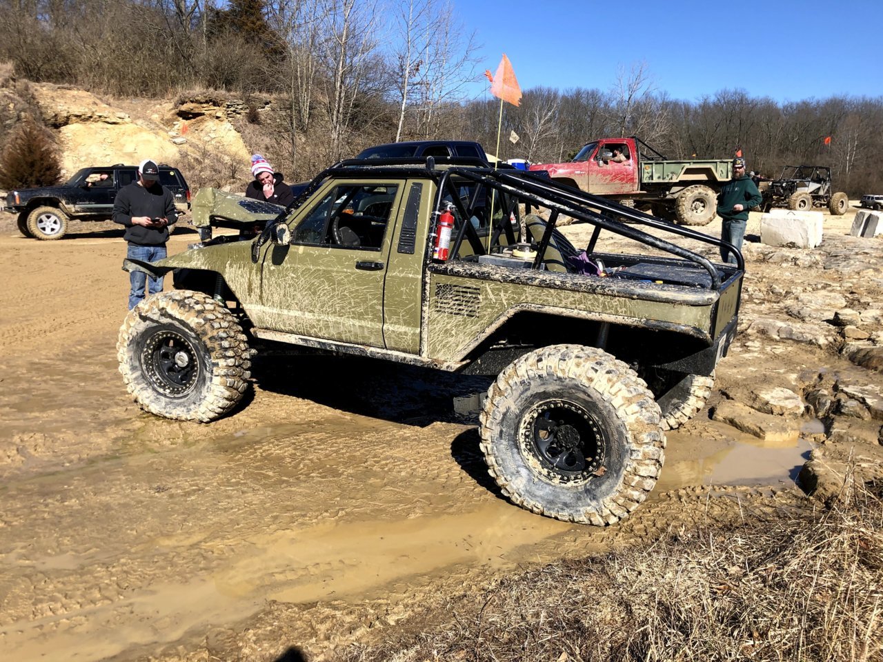

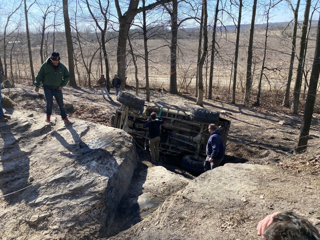

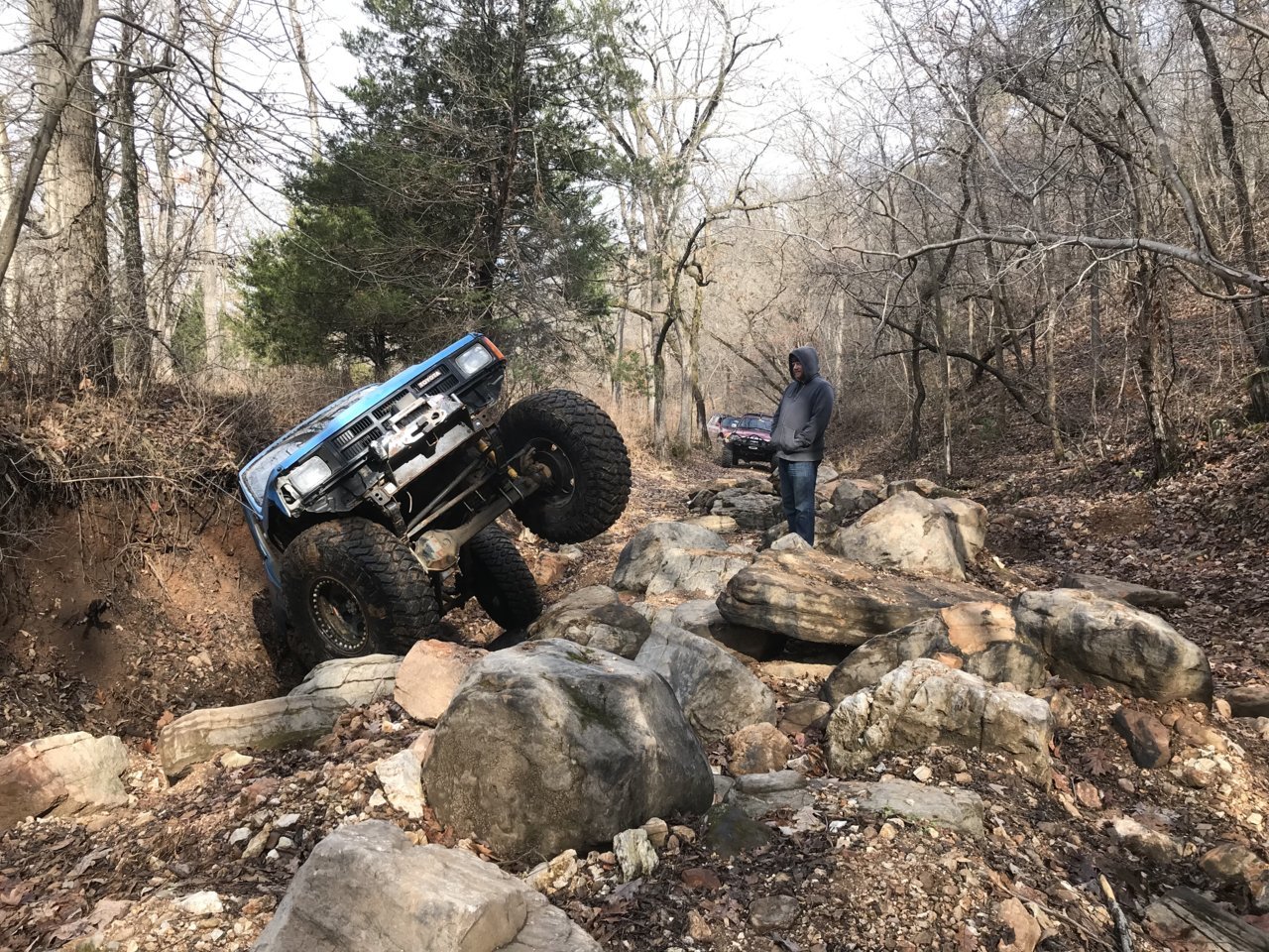

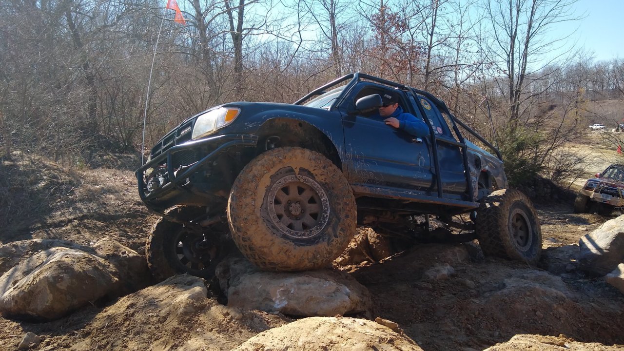

    Went out and wheeled the badlands with some full size guys. Drove the Tacoma there and back. Had a great time and it felt good to shake the Tacoma down before Moab.
    This ledge has a tendency to deny even guys on 40’s.... Sometimes you just get lucky
