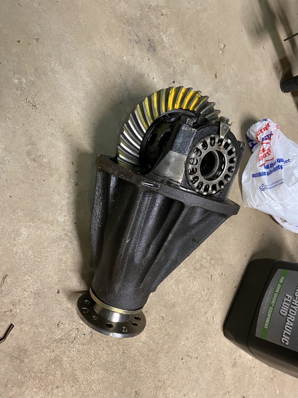

    Making progress....

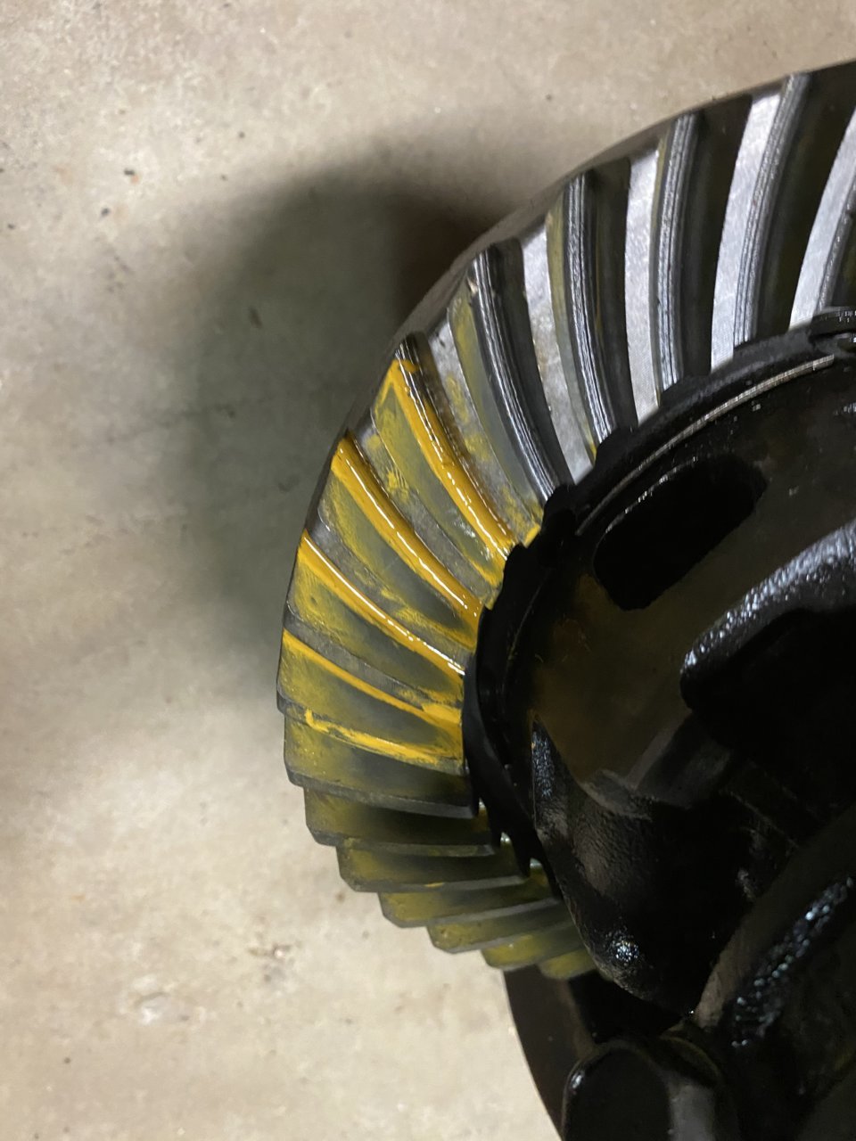

    Gears were a motherfucker to get set up. Took a .090 stack under the pinion to get the depth right. Normally is no shims to .020. Only thing different this time was Yukon gears instead of Nitro. Anyway...still got to a nice pattern eventually.
    New wheel bearings and hub gears are ready to go together tomorrow night. One spindle was full of water and had wasted the wheel bearings since June. I had some oddball IFS hub conversion gears that used a thinner outer gear/clutch. One of the outer gears was cracked and of course the OEM spare I had was too thick to disengage the inner gear. So I ordered some new chromoly outer gears from TG and picked up a new chromoly set of inner gears from RCV on the way home from work Friday.
    Turns out 4 years of deferred maintenance catches up to you and gets expensive!

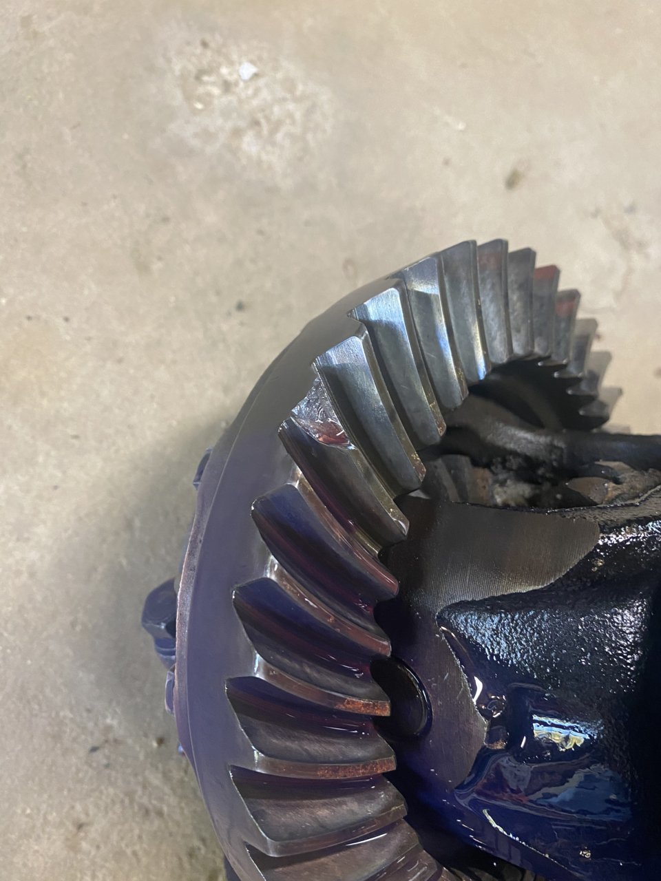

    Turns out it was definitely time for a new third. The chipped tooth is new since welding up the swapped carrier in June. Got 15 years out of this one so that’s hard to complain about!

    What gears do you have, 5.29s?
    Do you have the TG wiper seals? Are they really resueable like they claim? I love mine so far, just need to know if that's something I need to rebuy. Tearing the front end apart will most likely be my first piss the neighbors off project in my new place, whenever I get one.

    Yeah 5.29's. Definitely reusable based on how beefy those things are going in. I was on felts before so I don't have any time on them to be the authority though.
    This has been the fix everything I did as cheaply as possible in college type of rebuild. New wipers and rock rings from TG, new wheel bearings, all new gaskets/seals, and repacking the birfs.

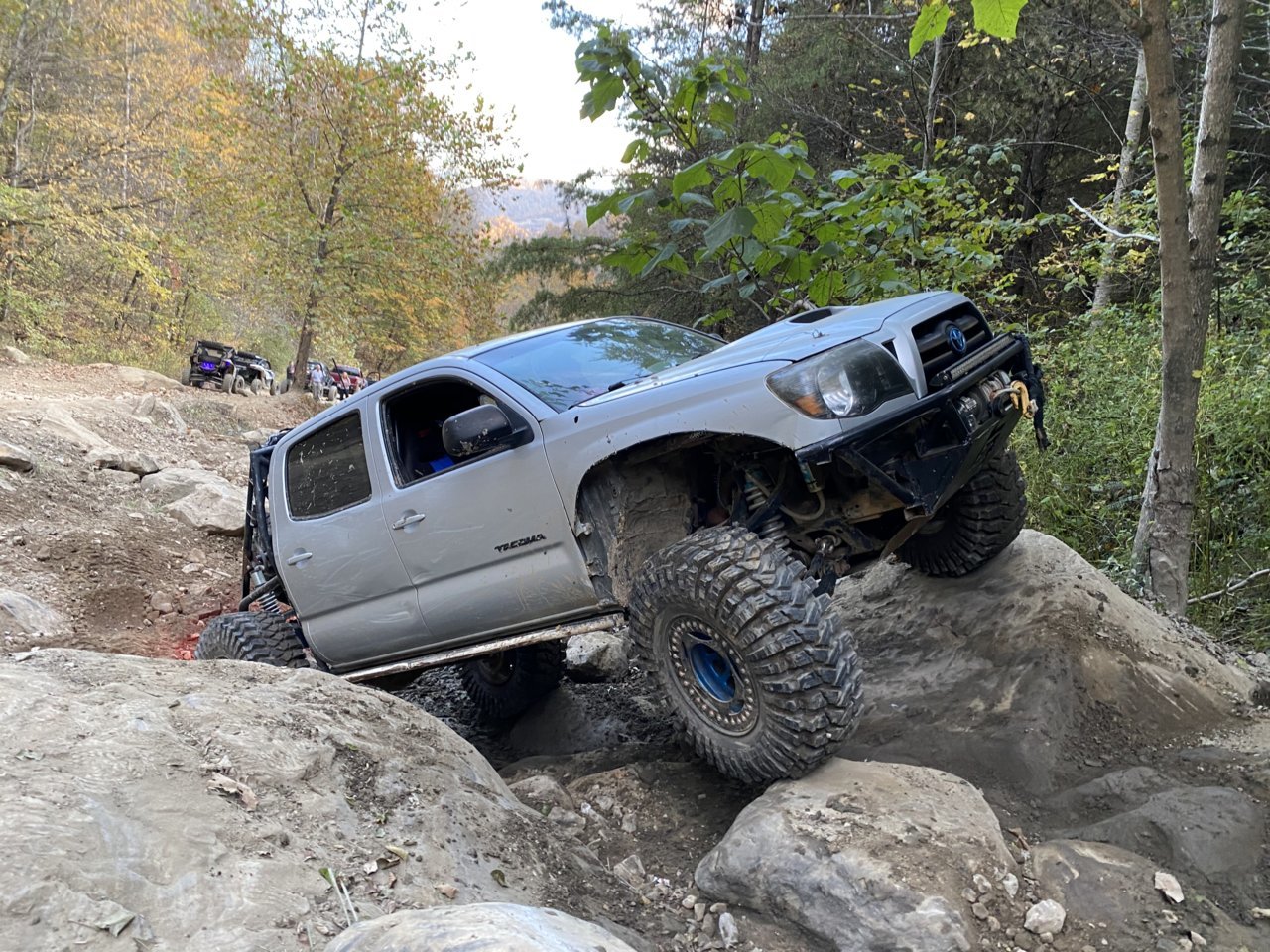

    1900 miles in the first 4 days of ownership of the new f350. Words do it zero justice in how comfortable it is towing the big trailer in the mountains down to Harlan. I love Harlan in the fall and had a bunch of fun with @Robertocritser, Nick, Grohe, and Mark. They are all much better at taking pictures than me too!
