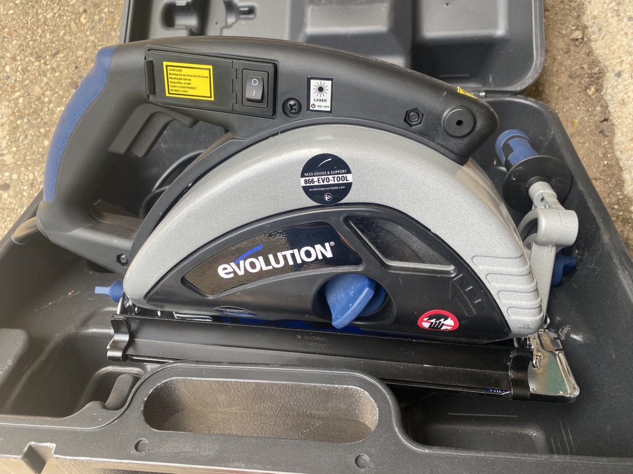

    what's the difference between this and putting a metal cutting blade on a regular 7" circular saw?

    This has a 9” blade for increased cutting depth on thicker material like tube and runs at a much lower RPM so it doesn’t put heat in the material and the blade lasts longer

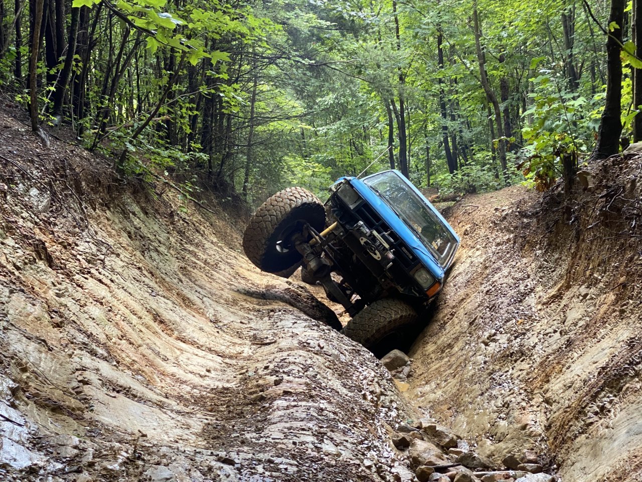

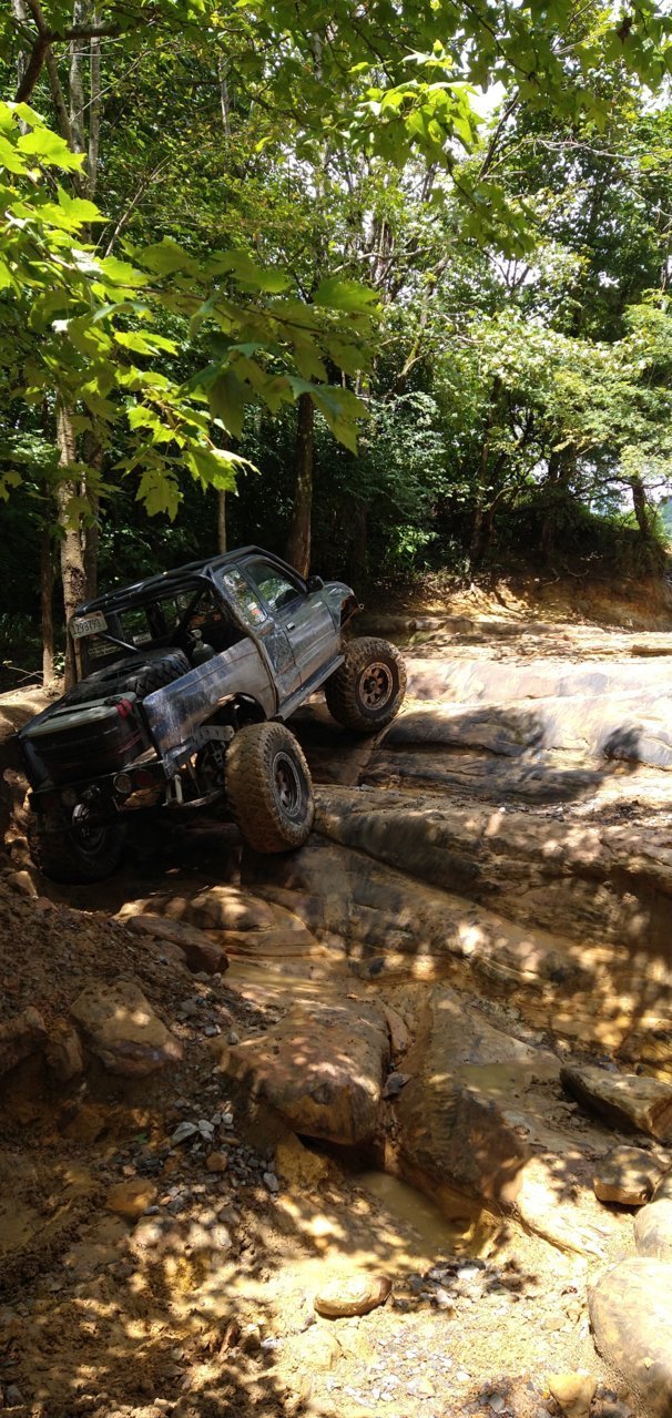

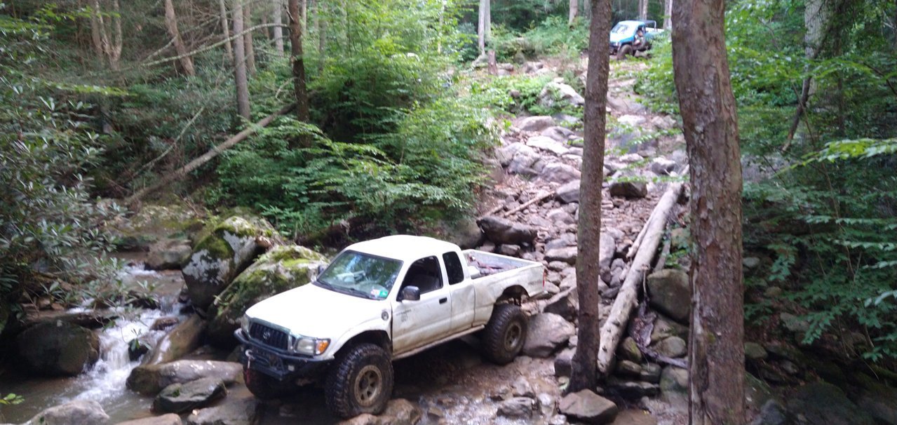

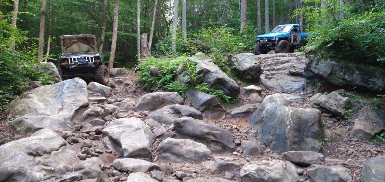

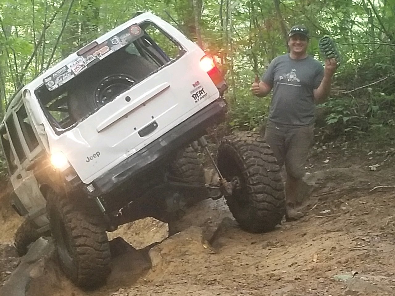

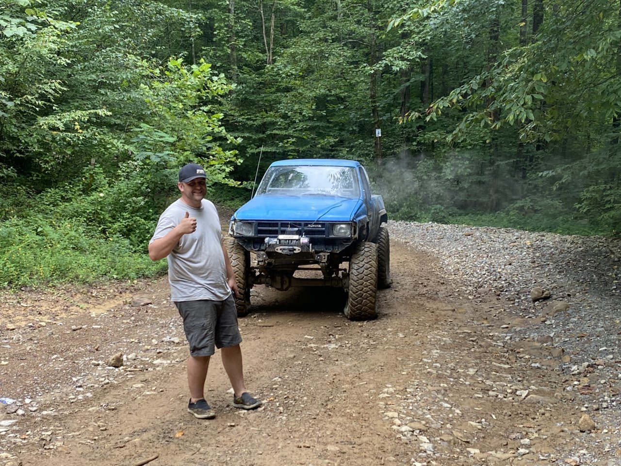

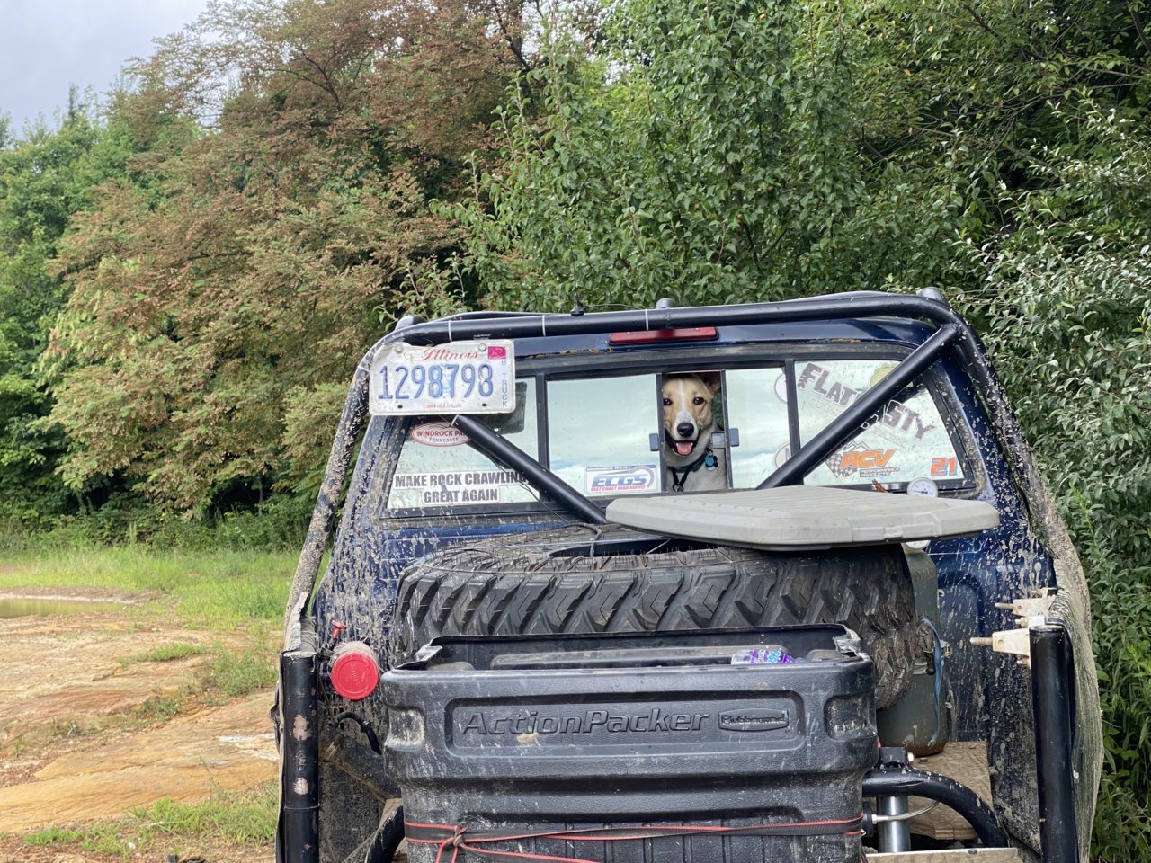

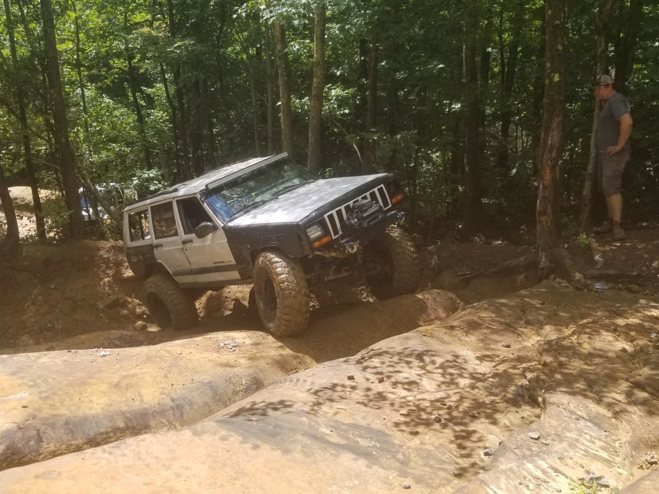

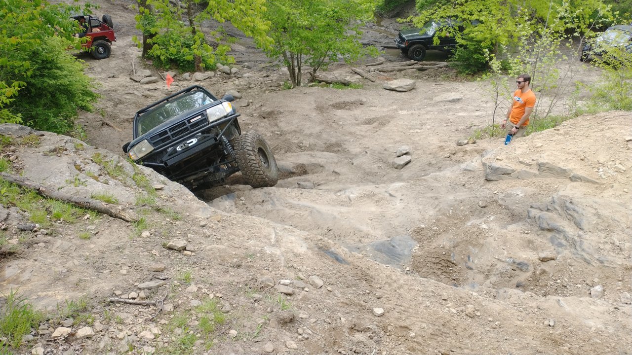

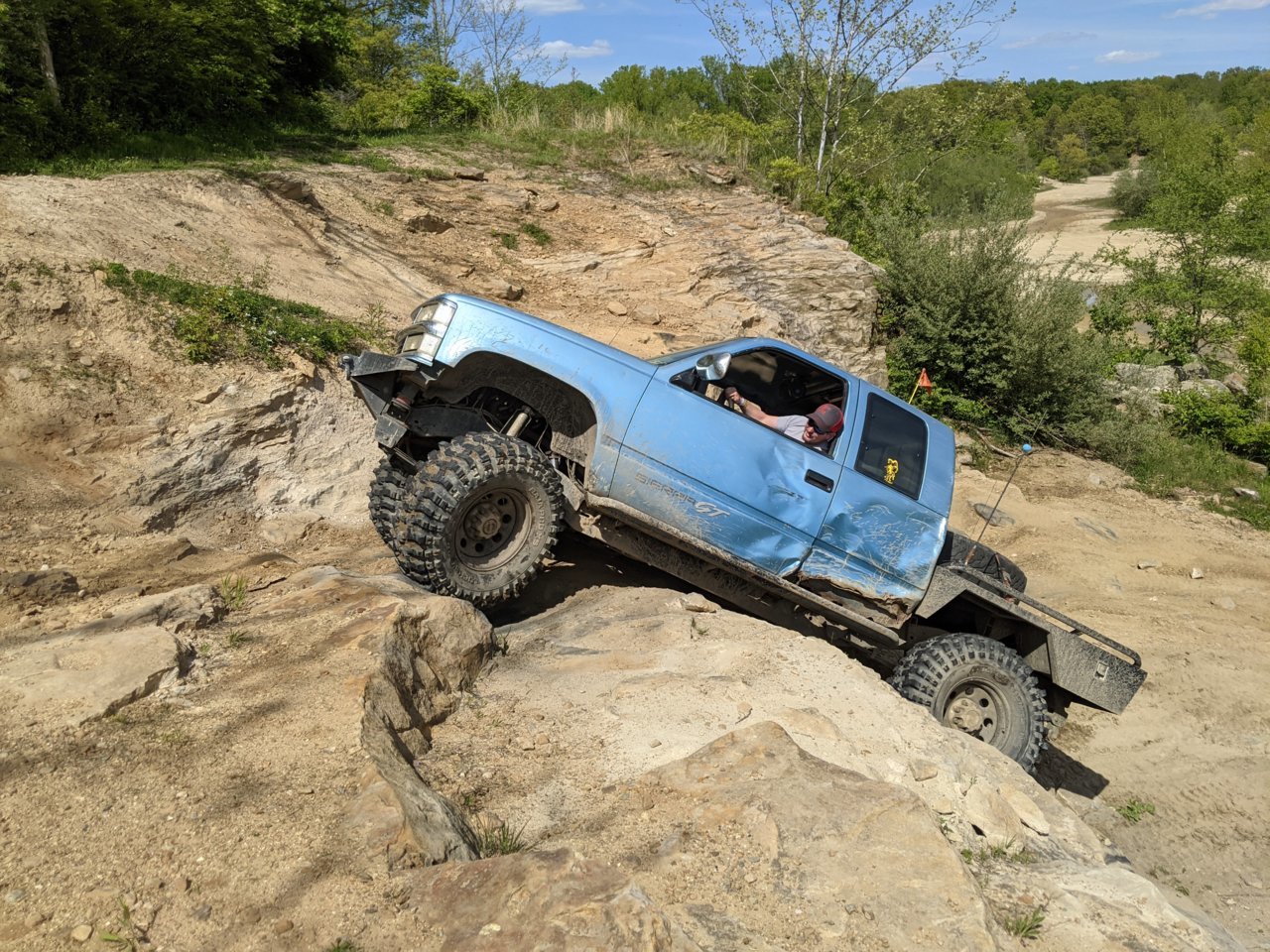

    Went down for a long weekend at Windrock and had a great time. Weather was perfect for mid August and we stayed dry until late Saturday night.
    Ran trails 15/3/40 on day one. 40 turned into
    A winch fest at the end but we were running it backwards unknowingly. Made a number of notes on my trail map after this trip! Ran 16 on day two. The scale of Windrock always throws me off when I go back. Day 1 was a 10+ hour day on trail and 16 took about 5 or 6 hours too moving along at a pretty good clip. The blue 4Runner lost a head gasket at the start of day 2 when he noticed it wouldn’t cool off and started steaming like a freight train out the breather

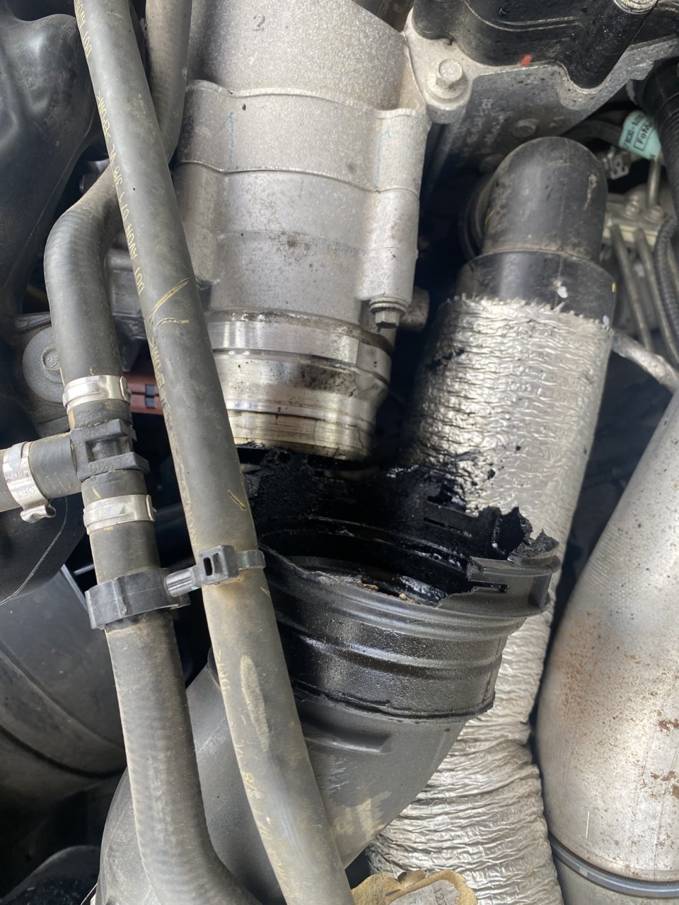

    Had an interesting drive home after driving through a monsoon on the way out to the interstate and then blowing a charge air cooler tube on the Ford at the top of a big grade 45 mins north of Knoxville. Scared the shit out of me and I fully expected rods hanging out of the motor after the big bang and zero power.
    After a quick roadside diagnosis, I was able to limp the truck off the highway and into a truck stop. After a few phone calls I found a replacement at the O’reily’s DC in Knoxville so I unloaded the Tacoma and drove it to grab the new tube. Threw it on and eventually made it home about 4 hours later than planned!

    Don't they make an aluminum charge pipe aftermarket? My boss blew his too, towing his enclosed home over the summer. Upgraded to aluminum

    Ha yeah that would have been the move to make!
    The Dorman part I got was shockingly nice and all steel with silicone boots instead of the crappy hard plastic from the factory. I knew they weren't known to be super strong but I'd figured it was mostly tuned guys breaking them pushing big boost and the aftermarket was just trying to make a buck with new parts. I may actually look into a disaster prevention kit just in case I ever have a problem with the CP4...

    Rescue tape and some hose clamps probably solves most things

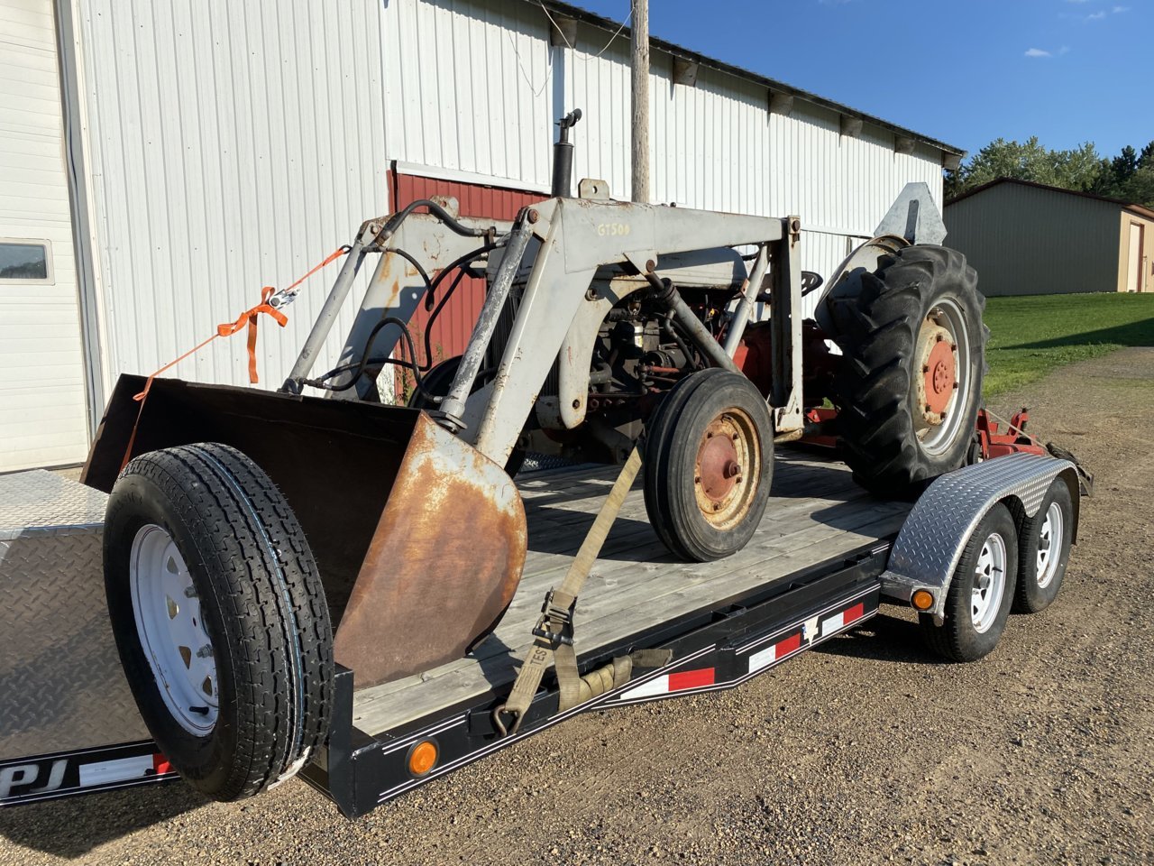

    Went and bought a thing today from a guy (Derek with Vice Grip Garage) up between Eau Claire and Minneapolis. Ford 9N that has a Sherman hi-lo range with the loader, finish mower, snow blade, clamp on forks. Should be great for my property maintenance needs and general work around the shop with moving heavy stuff or trailers around.
    jubei, slander, malburg114 and 2 others like this.

    So what kind of hackery is keeping this thing going? Coming from Derek, wouldn't expect it to be factory
  19. Aug 30, 2021 at 3:43 PM
    #499
    Snowy
    Snowy [OP] Is neither here nor there
    Feb 5, 2014
    #122349
    3,455
    Connor
    Winnebago, IL
    3 linked 98 Xtra cab
    Stock-ish
    It’s actually pretty good. Converted to 12v with a GM one wire alternator, new automotive oil filter head, fresh hydro lines, new carb and fresh fuel lines. Motor is a rebuilt 8n so it runs great and doesn’t smoke at all. It’s got a few oil leaks but it’s 70+ years old so that’s to be expected when it probably leaked brand new

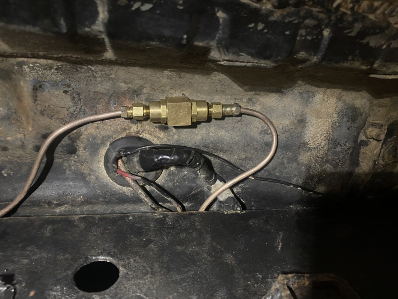

    Boring update but it’s an update…
    Plumbed in new rear brake lines and added a ball valve line lock to use as a parking brake. Been paranoid the dog is going to knock the truck out of gear while I’m out spotting. Took the time to delete the LSPV and add in a proportioning valve too. Got all Allstar performance stuff that worked great after seeing negative reviews on the generic branded valves
