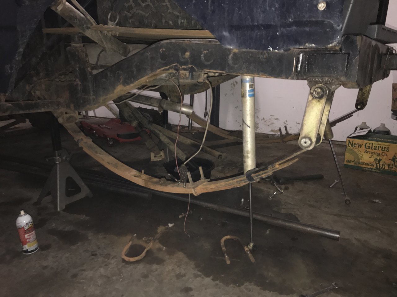

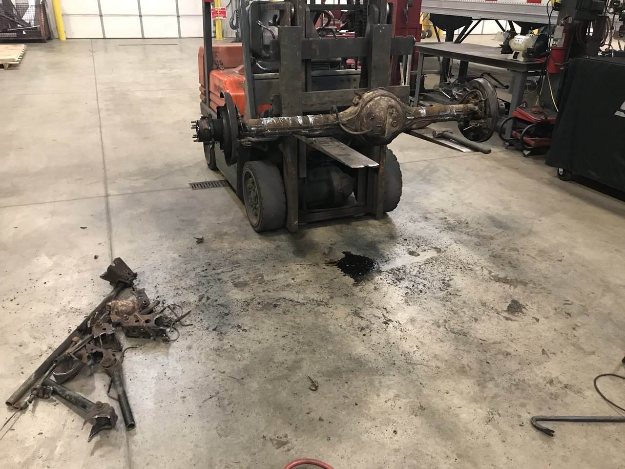

    No going back now...

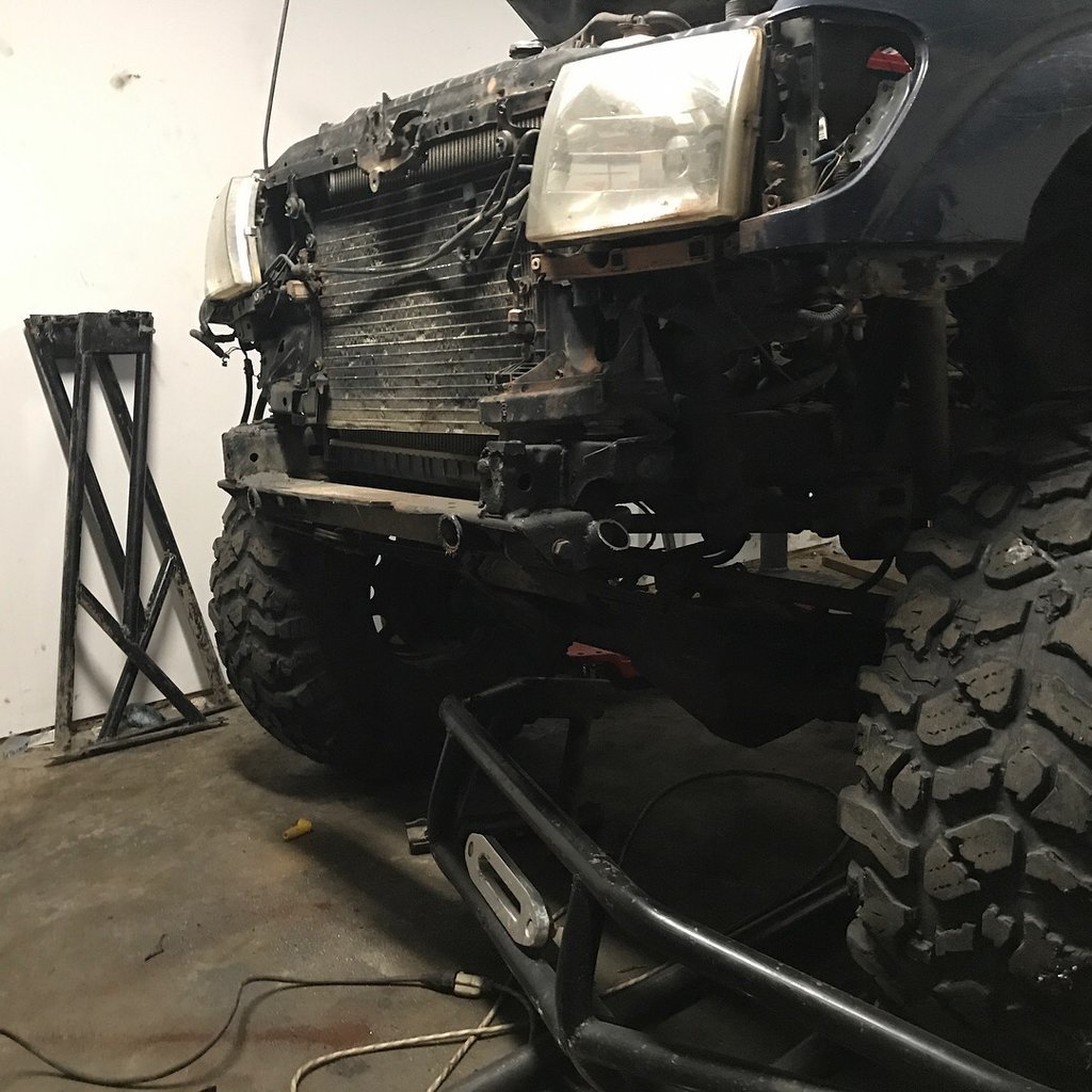

    The front bumper got hacked off to build a tighter, smaller one around a winch that I tuck into the core support.
    ...and the rear axle is gone for good. Picked up an non-locking FZJ80 rear from a friend. Plan is to throw 5.29's in it, a Spartan, tap the hubs to 5/16" along with 10mm dowels.

    I appreciate Toyota's over engineering in the early to mid 90's but good god...every bracket is 3/16's on the FZJ80 axle. Fortunately I used the plasma in the trailer shop at work to make pretty quick work of it. I really couldn't fathom using a grinder to cut them all off.
    Building the third Sunday and just putting the finishing touches on the new front bumper today...lots of progress happening.

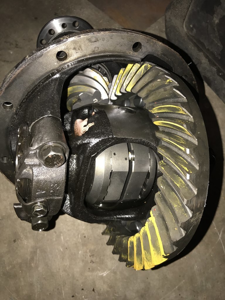

    9.5" Third has been assembled with 5.29's and a Spartan. Should be able to install the new housing this week and be driving by the weekend. My only mystery is the ride height of the new All Pro 5" pickup springs and whether the brakes will work.

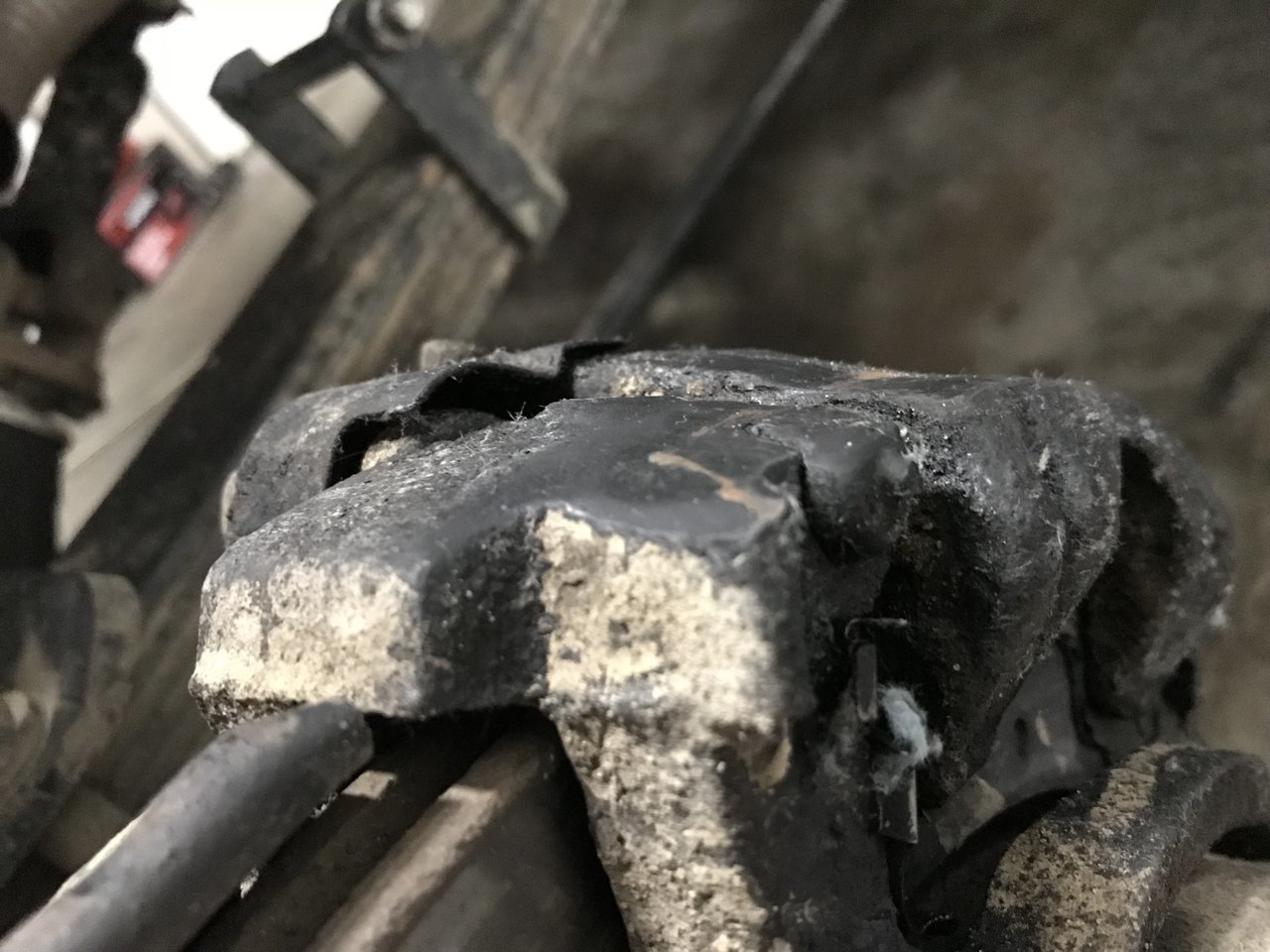

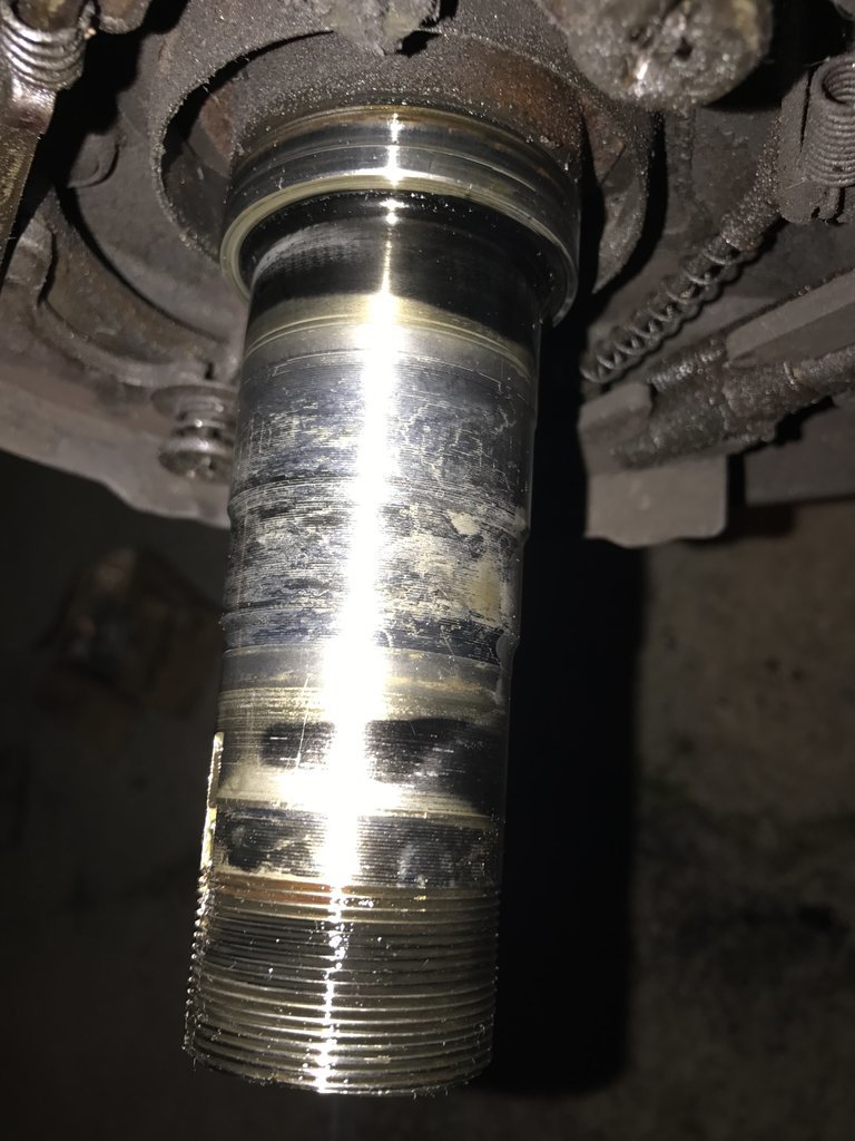

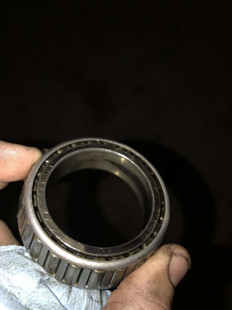

    Ran into some issues today working on the axle... I popped the hubs off and there was immediately signs of heat in the spindle. Took the bearing out and it's been scored and has signs of heat as well. Amazon Prime for the win though. New bearings, races and seals will be here in two days for way less than the parts store. The hub felt fine but the third showed major signs of heat and neglect that got me thinking the axle may need some more R&R.
    Good news is that I was able to tap all the hubs to 7/16's with no issues. Used a brand new tap and drill bit that made things easy. Trying to avoid any problems with the stock, small studs and not have to deal with cone washers.

    Just putting the last coat or two of paint on it tonight. Design wise it's super similar to what I had but is a full 6 inches tighter to the body and all bent in the same plane. I'm significantly better with the bender and design since completing the exo.
    Good to know! It doesn't look like any material transferred on the hub so I'm feeling good about it with new bearings.
    I had no issues with the locking rings until I got to the last one of course. It was super tight and I stripped it with the impact and a #3 bit. Drilled it out no problem but is it a dealer only part or a standard bolt I can find a cap head?

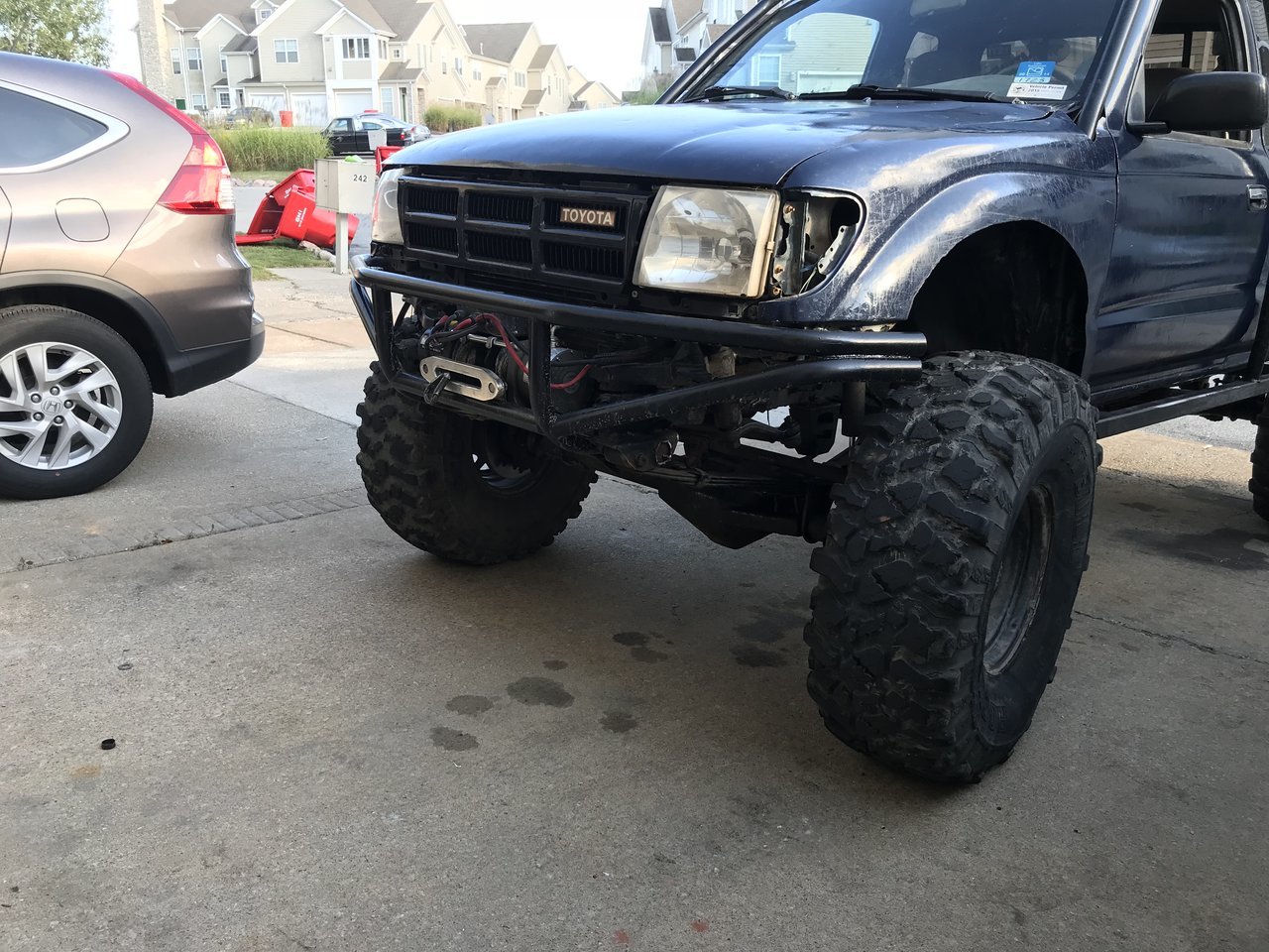

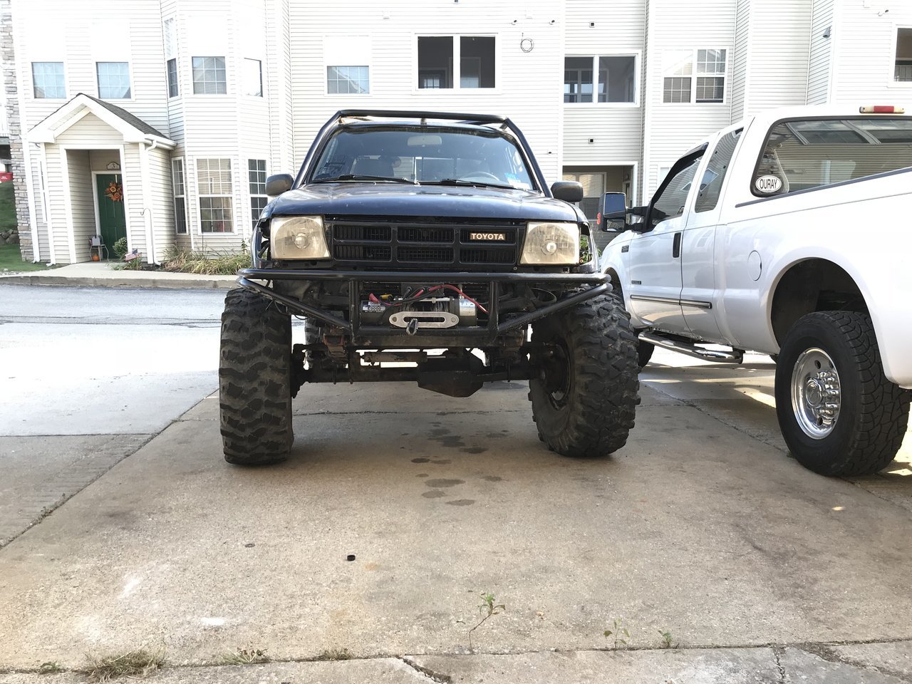

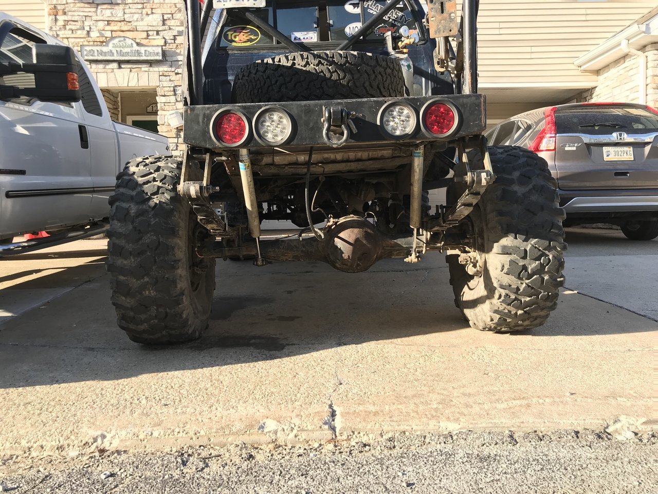

    I ended up jamming and not taking a ton of pictures along the way but the new bumper is done and the FZJ80 axle is under the truck.
    Ended up tightening the bumper up to the body by about 6.5” over my old one by cutting out the lower core support to sink the winch back. Also being a better fabricator now helps a lot too.
    D29F3344-E1E4-4002-AE0D-9F43BF164C01.jpg 44CB57EB-7E00-4167-82F6-00816F7D58A2.jpg
    I figured out that the Barnes 8.8 swap kit for an XJ is perfect to put the FZJ80 axle under the Tacoma on AP springs. Made perches and shock mounts easy. I also figured out that you have to grind quite a bit off the land cruiser brake calipers to clear 15” wheels. About 100 miles on it now with no problem...brakes are awesome with the LSPV zip tied up. The hubs are drilled and tapped for 7/16” 20tpi to match my front hubs so that I could use socket head cap screws instead of messing around with cone washers. Super easy to do and beefy. My biggest hold up out of the whole thing was waiting on springs from AP. My Downey springs were done and the AP springs are the exact right length to replace them. The center pin is about 3 inches farther back so I had to have a new DS made for the longer wheelbase.
    I love the width of this axle and simplicity of no more ARB. I really didn’t notice the auto locker at all on the trail.

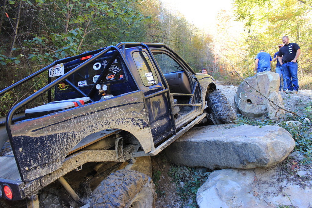

    It looks like this winter will be one of the first that include no major projects for the Tacoma. Somehow I knocked them all out during the summer?? I went to Harlan with a group on here and cut down one of my PBR's so I had some soul searching to do. My PBR's are 7 years old and have decent treadlife left but the rubber compound was starting to harden up noticeably. So it was time for some new tires...problem is that I am on 15" wheels with limited tire options. Couple that, with a desire for beadlocks, and I ordered a set of Pro Comp Vapor 2 aluminum beadlocks in black. I like that they aren't Racelines (like 3 of my friends have) and look great. I'm hopeful that the aluminum beadlock will help mitigate the weight gain from going to a 17" from the 15" and make the truck still very streetable. I'm still up in the air on tires on whether I go back with a PBR or go to something different like the Maxxis RZR.
    Couple of pictures from the Harlan trip getting denied on Little Jager and then cutting down a tire in the lower rock garden
