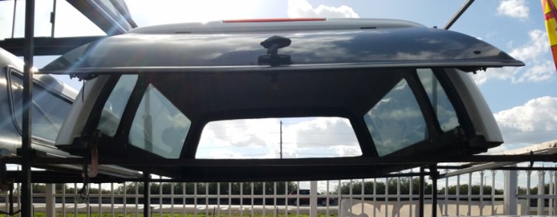

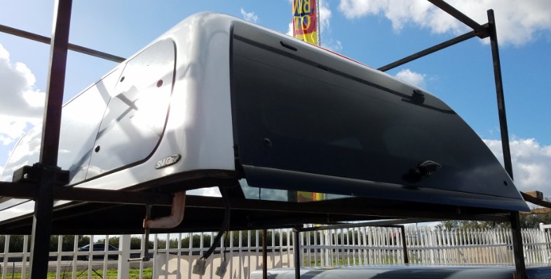

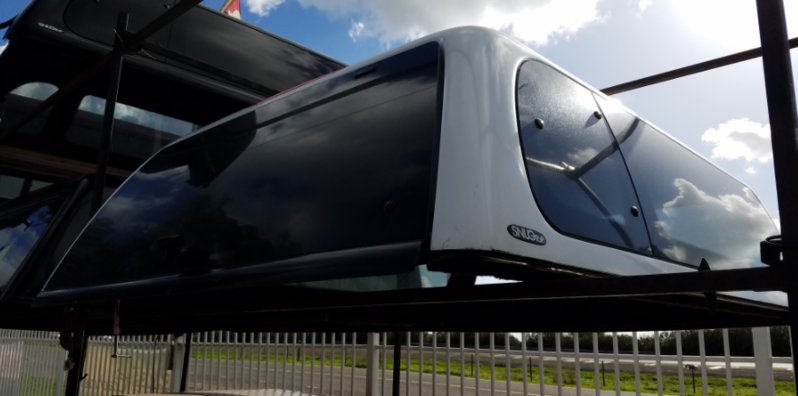

    Here are the images of the actual shell, can anyone suggest whats reasonable as far as price?

    dreams crushed... I got the serial number and had a authorized snugtop dealer check the make and model. Unfortunately its for an extended cab, roughly about 75" long, so any of you that is looking for one you can see the images above. They want $700 for it.

    That's a pretty nice shell. I have an A.R.E. MX and really like it. Price is a bit high for used though.
