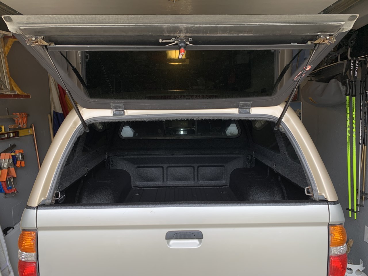

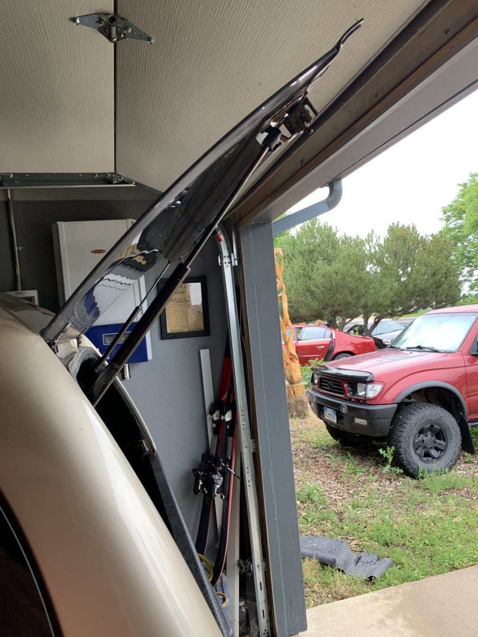

    Specs: Snugtop Super Sport for 01-04 short bed

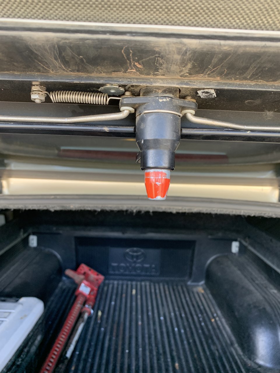

    Issues I had:
    Issue 1. The pop lock mechanism on the older style Snugtops significantly protrudes on the backside. This turns out to be brutal. I guess having a topper of 20 years on my 1998 without this issue allowed me to walk face first into this fawking thing so many times. Or have it dig into my scalp (drawing blood twice). Or if I'm crawling in, or out of the bed, having it trench out my spine.
    I investigated buying the newer pop lock which has a slightly lower profile mechanism. After measuring both, the minimal gain wasn't worth the $90.
    So I looked at different struts. Calling Snugtop is useless. They will only recommend one strut, presumably for liability purposes. The one they will only recommend is the C16-06874. Which only raises the back glass so that it is essentially parallel with the topper roof line. Putting that god foresaken pop lock in a position to destroy its enemies.
    I searched Suspa's website and found the C16-33313 strut. Same body length and force but 1.6" longer.
    Specs of the struts:
    C16-06874:
    Center-to-Center Length Extended: 17.1"
    Center-to-Center Length Compressed: 10.8"
    Force: 40 lbs
    C16-33313:
    Center-to-Center Length Extended: 18.7"
    Force: 40 lbs
    The latter now raises the rear glass at a significantly higher angle without the glass hitting the body of the shell. And seemingly not putting any additional strain on the hinges or fiberglass to which the hinges are mounted.
    Now that mf'ing pop lock is completely out of the way. Unfortunately I do not have any before pictures of the angle of the glass when open. But you get the point.
    Before (looking straight at the glass and this demon... stained red with the blood of its enemies)
    After:

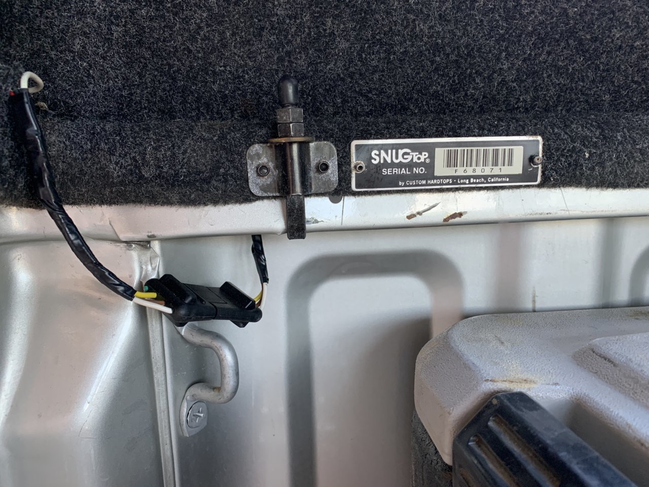

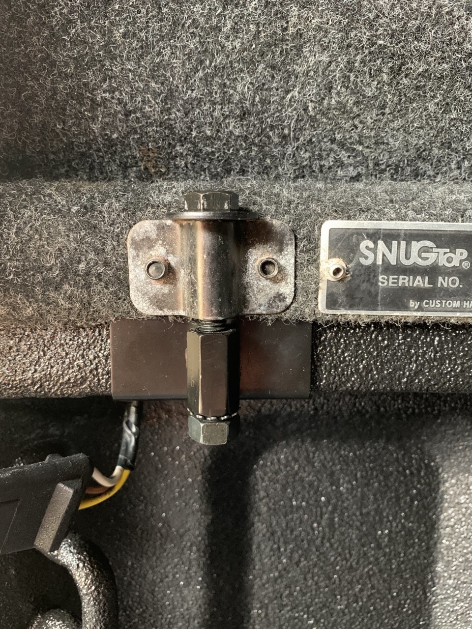

    Issue 2
    The clamp style of the older Snugtop seems idiotic to me. Sure it's nice and sleek looking but the J-style hook significantly flexes and compromises the thin sheet metal of the bed lip. Even if you don't overly tighten it down... just from the flexing. Hell in the short period of time I've had this topper on my truck with the J-hooks it bent the sheet metal.
    So I investigated the newer style clamps that incorporate a much wider base. Of course Snugtop says only the J-hook style clamps work and that the newer ones won't. But I took a chance after reviewing the width of the bolts, etc.
    I'm here to tell you that they work just fine. (of course if my topper decides to jettison itself off on the highway or trail, I'll update the thread)
    New style clamp Part Number: 715406
    Old:
    New:

    I am so glad I found this! I have been wanting to modify my ARE shell to use these style clamps but was unsure how they worked cause ARE only uses the big obnoxious aluminum split clamps
    Are the lines of your snugtop even with the sides of your bedrails? My ARE lip protrudes about 1/4" in towards the bed on both sides so I may have to get fancy and do a custom dogleg in the hook to make work
  8. Oct 5, 2020 at 1:55 PM
    Madjik_Man
    Madjik_Man [OP] The Rembrandt of Rattle Can
    Dec 2, 2009
    #26893
    19,681
    Colorado Front Range
    1998 Ext Cab 3.4 4x4 TRD 5MT, 2004 DC 3.4 4x4 TRD
    on the inside of the bed?
    yes the topper bottom is pretty flush with the bed rail vertical line.

    Was your snugtop topper regular height (same height as the cab)? Or is your topper a bit taller than the cab? I’m having the same issue on my 2009, whacking my head on the inner handle of my Snugtop. So I want to get longer struts for the hatch like you did. My struts are only about 15.5-16” long while they’re extended though. So I’m wondering if my topper is shorter than yours, and if I should go for those 17” struts or all the way up to the 18.7” struts.
    Thanks!
  13. Mar 5, 2023 at 6:01 PM
    Madjik_Man
    Dec 2, 2009
    #26893
    19,681
    Sorry I missed this.
    My topper is cab high.
    The longer struts I linked in the first post eliminated the scalpings. But in the end I just installed the newer pro lock version on the topper.
    Much better mechanism and lock style. Plus a shallower profile on the backside.

    Any issues installing the pro lock version from the older 'poplock' red one? They say it's not compatible but you're the 2nd person I've found saying they did it. Any heads up on parts needed aside from the Pro Lock itself or any issues? Thanks!
    Just favorited this for a later DIY as I could always use longer struts, I always thought it was a bit low from the factory.
  15. Sep 13, 2023 at 2:05 PM
    Madjik_Man
    Dec 2, 2009
    #26893
    19,681
    I just brought it to the topper shop that deals with Snugtop. Only the ProLock mechanism was replaced
    No issues whatsoever.
