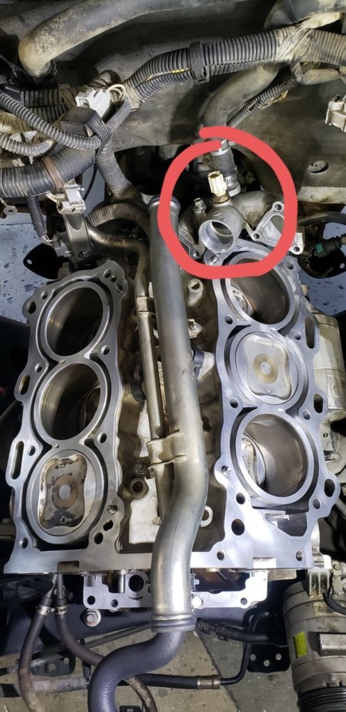

    Possibly a bad water temp sensor.
    wilcam47 likes this.

    forgot all about that. Common to fail on German cars probably no different. Could be a good idea to throw one at it as preventative maintenance in general.
    Google shows it here as not looking too hard to get to or expensive.
