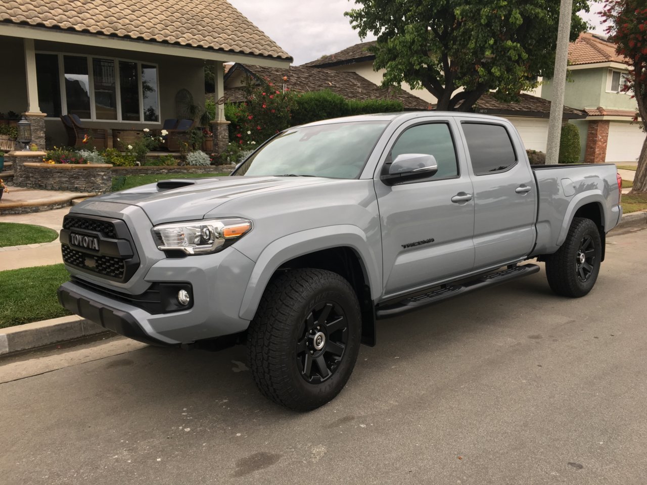

  15. May 29, 2019 at 8:55 AM
    #35
    rzgkane
    rzgkane Well-Known Member
    Oct 1, 2012
    #88082
    705
    Huntington Beach, CA
    2019 Tacoma TDR Sport 4WD DCLB - Cement - Tech and Premium
    4Runner Trail wheels and Toyo Open Country ATII tires 265-70-17. Cosmetic stuff like Pro grille and OffRoad black bumper trim, vinyl delete on side, added hood graphic, OEM tube steps.
    I used a set of 4Runner Trail wheels on my '19 Sport 4WD with 265-70-17 tires and it accomplished the goal of taller tire (to fill the wheel wells better) and a slight bit wider stance by a decrease in offset by 10mm. I thought it looked great. And best of all... it didn't rub. But it was close. I don't think I could have run a 275-70 or 265-75 on there.

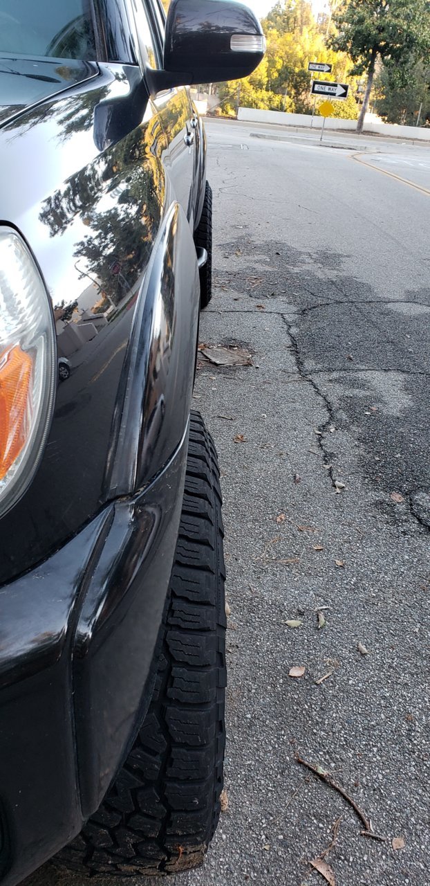

  20. May 30, 2019 at 3:58 PM
    #40
    DarthPow
    DarthPow Well-Known Member
    Feb 27, 2018
    #245786
    2,570
    2012 DCLB TRD Sport 4x4
    No problem. Yea, that's the gist of it.
    Here's a pic of my wheels, they're 0 offset, with .75" spacer. Personally I like that they sit just outside of the wheel well.
    If you don't use the spacer, it would sit flush with, or just behind the fender flare.
