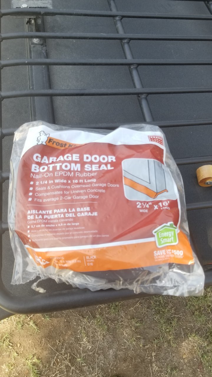

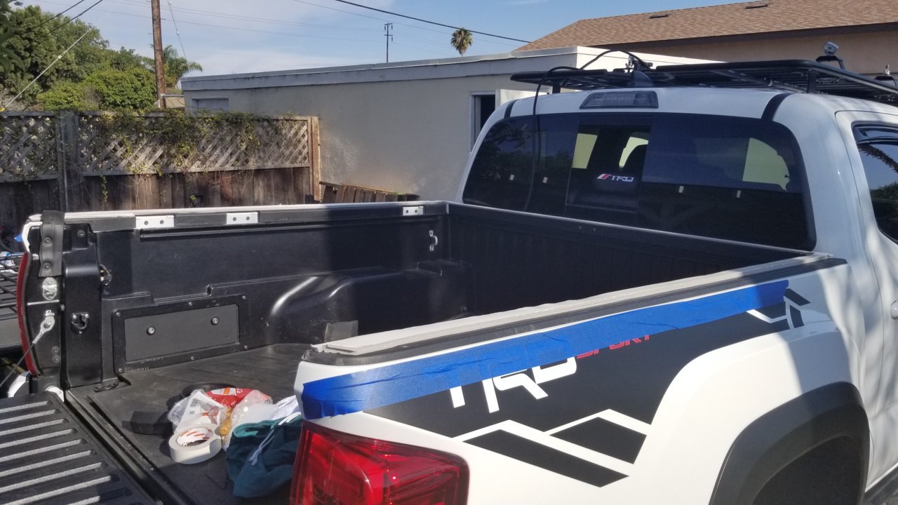

    I've done a few things to make mine virtually leak proof and also to decrease the noise between the cab and shell. One is I used a series of foam at each corner and also garage foam seal. Another is using garage seal between the cab and shell. See pics.

    What did you use to attach the "Garage door bottom seal" to your truck cap? I can't seem to find any tape or caulk that will stick to it well enough. Also, how has it held up?

    How did you attach the garage seal to the cap?

    It might sound a bit drastic but I used rivets to attach the garage seal to the bottom portion, below the window. Then I put silicone on both sides of the rivets and coated the top portion of the garage seal (where it touches the truck cap) with silicone. It has held up great. It use to leak so bad that I was at the point where I was about to buy a brand new truck cap. But now it does not leak at all, not one drop.
