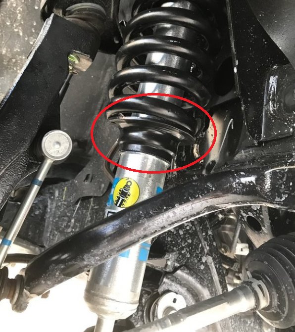

    I thought that immediately as well when I saw 5100s because 9/10 times that's what it is. But OP is saying he bought them pre-assembled from Headstong, they've built and shipped so many sets, I can't imagine they made that mistake.

    Yup your perches are upside down

    the black ring correct
    9TRDTCO and ChadsPride like this.
  9. Jul 25, 2017 at 5:44 PM
    #49
    medic2230
    Oct 13, 2008
    #9942
    63,971
    Murph
    Bama! Roll Tide
    Yes.
    ChadsPride likes this.

    well that was easy

    Yup. You'll be golden in no time.

    Yes
    He said he was using stock springs so Headstrong did not assemble those, his perches are in fact upside on the downside

    Yup, that's upside down.
