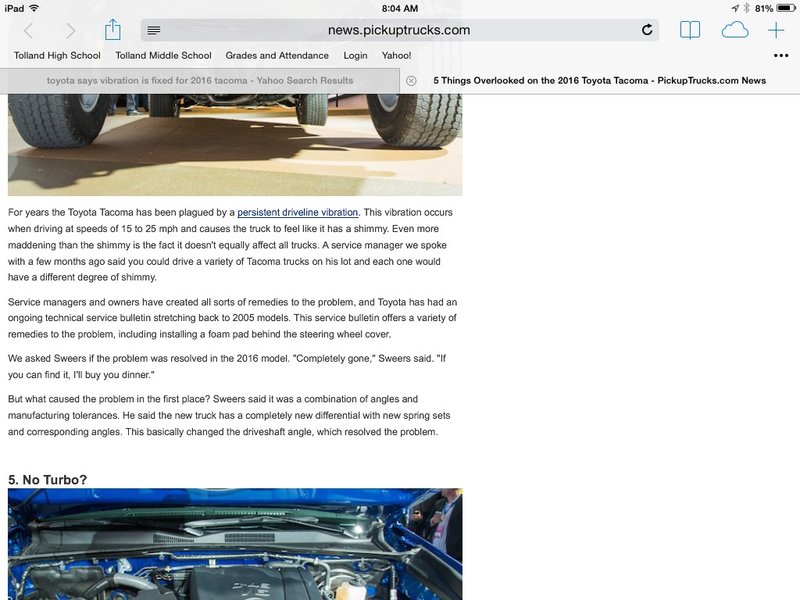

    I own a 2014 Tacoma that vibrates like crazy. The dealer changed every part they could and it still not better. Mike Sweers says it fixed and if you feel a vibration he will buy you dinner!! His words from the auto show! Can't wait to drive one to confirm!

    Here is the article.

    So the rear axle and rear driveshaft angle was causing the shimmy? I was thinking they changed/ upgraded the rack and pinion assembly and made it a little stronger/tighter, it just felt to me like the steering rack was being overpowered by the tires/ suspension and was allowing it to shimmy.

    Mind posting the actual link?
