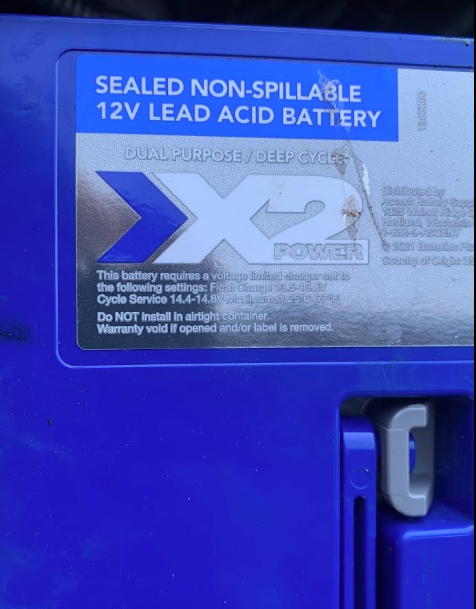

    I know what the battery and the specs say to do. I am not ignoring those. I fully believe the best way to charge an AGM is doing so how the manufacturer says to.
    What I don't believe, is that doing what we do to simply raise the voltage, is what the battery wants. Based on that pic you posted, the battery would want the voltage to be altered between cycle service and float. Tunes on a 3rd gen or anything else on any other gen isn't correcting the process, its simply raising the voltage across the board. Which still isn't what the battery says it wants.
    They do vary the voltage some across temps, such as when the engine heats up, the voltage is dropping bit by bit. But I still doubt it's near as good as using an actual AGM charger which charges the battery exactly as it wants to be charged.
