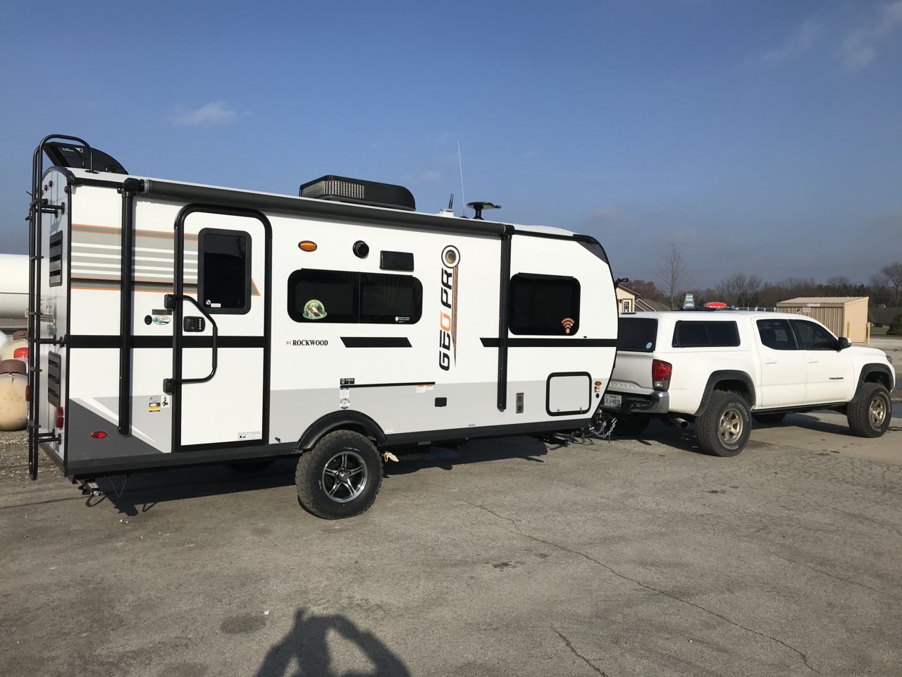

    First of all, it's ultimately your decision.
    Here's my 2 cents: Your Tacoma will indeed tow the mini lite. Even fully loaded. BUT it will not do it well at all. Your drives to and from your camping spots will be very, very laborious, you will get very, very poor gas mileage (even for towing). Any hills and you'll be struggling to keep 60mph without a screaming transmission/engine. You hit any sort of headwind and that labroriousness and poor fuel economy are both majorly amplified.
    This sounds discouraging, but it's the truth. If you're a very patient person and an enjoy the journey, steady as she goes, no rush, don't care that you're holding up 10 people behind you on the road kind of dude, then your temperament and your truck can handle it.
    I loved my 2019 Geopro 19FBS. LOVED IT.
    It was 4500 (EDIT - I totally forgot - it was 3800, NOT 4500) fully loaded and I couldn't stand going even 125 miles on mostly flats and low grade hills, even with 4.88 gears and OVTune gearlock tune. After two years I sold it for a pop up (Rockwood 1640 ESP) which I wish I would have got to begin with. I simply use my outdoor hot water shower system and toilet system that I already had. (I camp a lot).
    If you must have full functionality of an RV (shower/TV/shitter/etc), consider one around or less than 16'. The Geopro 14' model would be much better behind a Taco, and even that, due to the simple (or not so simple) physics of wind resistance, will not be an effortless driving experience.
    Anyway, best of luck to you and if you do decide to get the mini lite, get yourself at least 4 gallons of external fuel like a Rotopax or the like because you will almost (ALMOST) be able to watch your fuel gauge drop as you drive.
