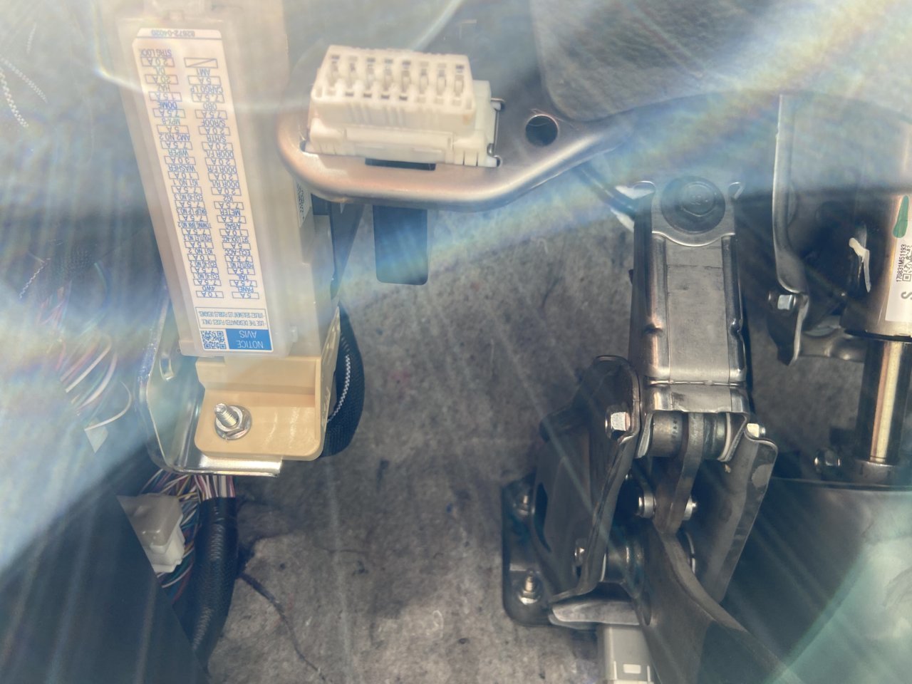

    this is the plug underneath my dash. Does anyone know what it is for?

    That big white plug? That's your OBD2 port, for pulling diagnostic codes or monitoring the truck. It's not the port the brake controller plugs into. The port for that is under the kick panel, like others have said.
    I have an Ultragauge plugged into my OBD2 port to monitor my transmission temps. If your state does emissions, that's the port they plug into to check on the truck then too.

    What is the highest temp it should be?

    Well of course. I should have thought of that. Thanks for bringing it to light. I don’t do maintenance on the Taco but I do all the maintenance on my classic British cars, which don’t have OBC, so I never considered that. Duh...

    Average Tacoma tranny temps are 185-199, winter or summer. Slightly higher for short periods of time while towing is no problem.

    Cool, thanks. Maybe I’d better get a scan gauge, living here in the high desert.

    Just don’t leave it plugged in when you shut off the truck!
    It’ll drain your battery.
    but yeah, it’s a good tool to have.
