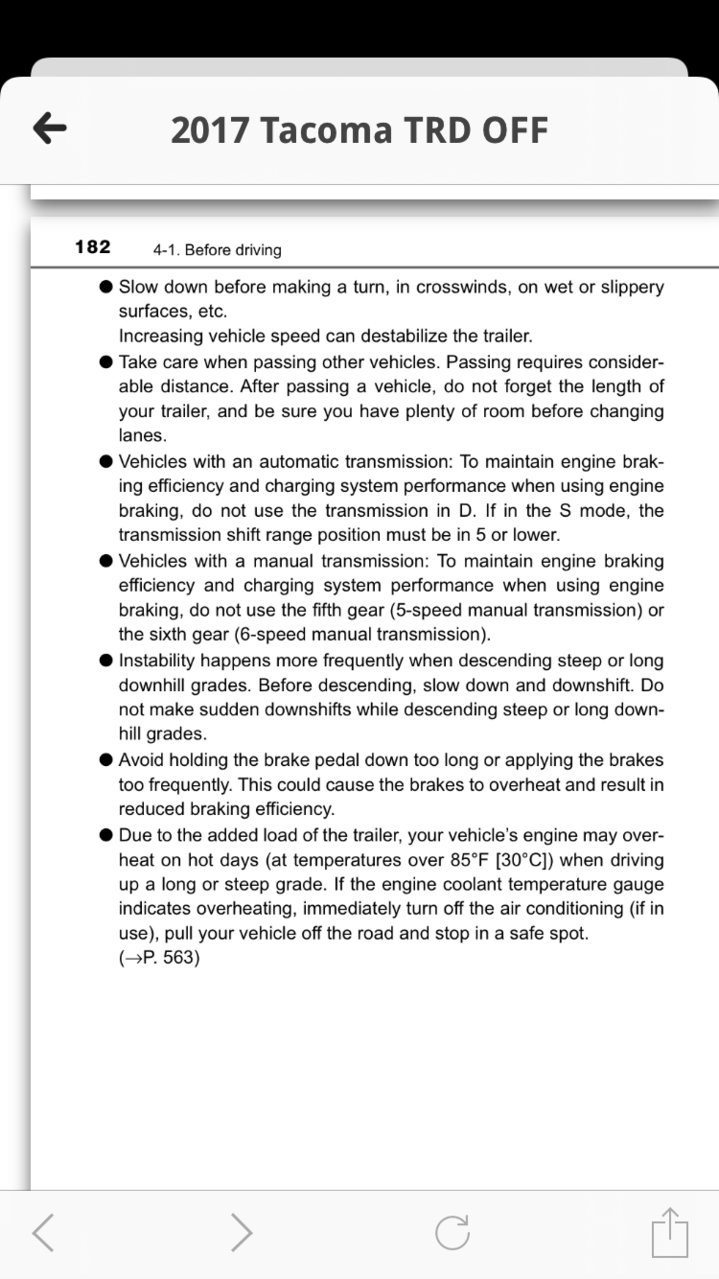

    The manual says to use S5 or below. On the transmission we have, S4 locks the transmission's highest gear in at 4th gear, which only uses one set of planetary gears in the transmission - it's basically direct drive output for less heat. 5 and 6 on our 6-speed AT transmissions are both overdrive gears and will produce extra heat.
    I always tow in S4 with ECT on. :thumbsup:
    If you're doing a long pull and it's slogging, there's nothing wrong with tapping down to S3 and pulling that hill at 5k RPM.
    One last thing, engine braking adds a LOT of heat. Minimize that downhill when towing.

    I hear what your saying I just don’t see where it says that in the manual.

    I agree with you. I have scanned the manual many a time and have not seen S4 for towing. If someone can find it and show me, i'd appreciate it.
    I tow in S5 + ECT on. No issues in 20K miles of towing or so.
    I will say there are some slight differences in the manual between years though. If you check I believe a 2020 manual, some of the terms and wording is different from the 2017 manual.

    @Txexplorer You're right - my manual (2017 SR5 DCLB 4x4) in the glovebox does say 5 or below - exact same as what you have above.
    If you want to tow in overdrive, go for it. I'm sticking with S4. Again, less heat in the trans since it's not an overdrive gear.

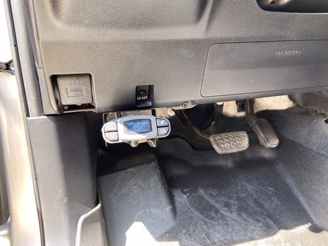

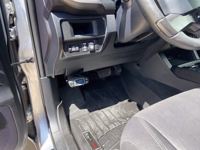

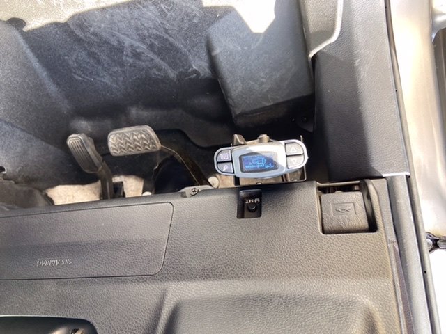

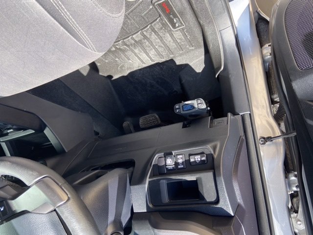

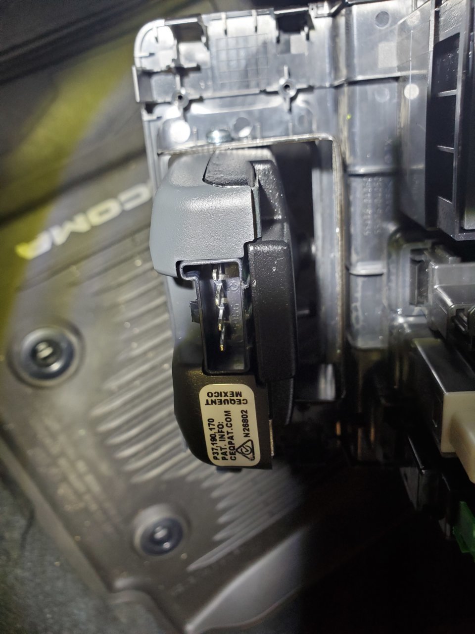

    6C0B497C-E1AC-445A-BEB1-EE54D0D34A4F.jpg 009A18B2-DD94-4DAC-9B73-B9DFB7457EDE.jpg Installation was as easy as everyone said. I chose to hang it below the dash and it’s out of my way completely and easy to reach behind and unplug when not towing.
    Question.....should the side screws be tightened so unit is rigid in hanger or should it float a bit? Those screws are hard to turn and I wouldn’t want to over tighten.
    edit.... here are some pictures but I can’t get them to post upright so you may have to stand on your head to get a good look.

    It probably shouldn't float because it might vibrate itself loose. I'd back the screws all the way out and then retighten while holding the bracket in place. With the screws already started and you holding it flush, the bracket should be in place well the second time.
    Worse-case, you can put some VHB tape under the mount. VHB tape is great, and can be used in addition to the screws if needed. Looks good though, glad you were able to get it done.

    No worries, another thing - these are pretty cheap and I've found made a huge difference to how our trailer goes down the road;

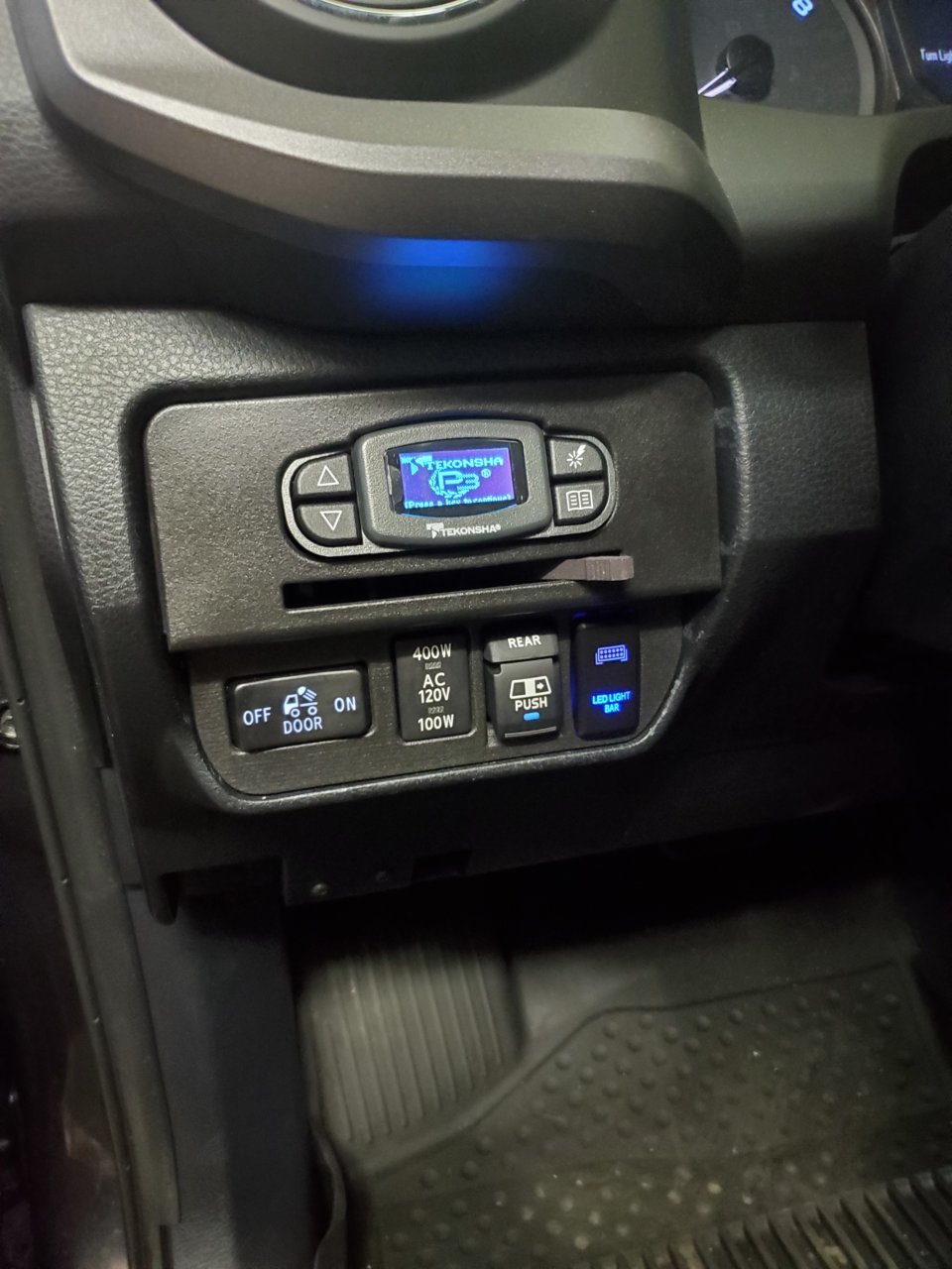

    @MESO made it! Go to the sale thread here or look him up on www.mesocustoms.com.
    Here's what it looks like:
    It makes the controller look factory and looks great! You also don't have to deal with accidentally kicking it or having things hanging off your trim panels. :thumbsup:

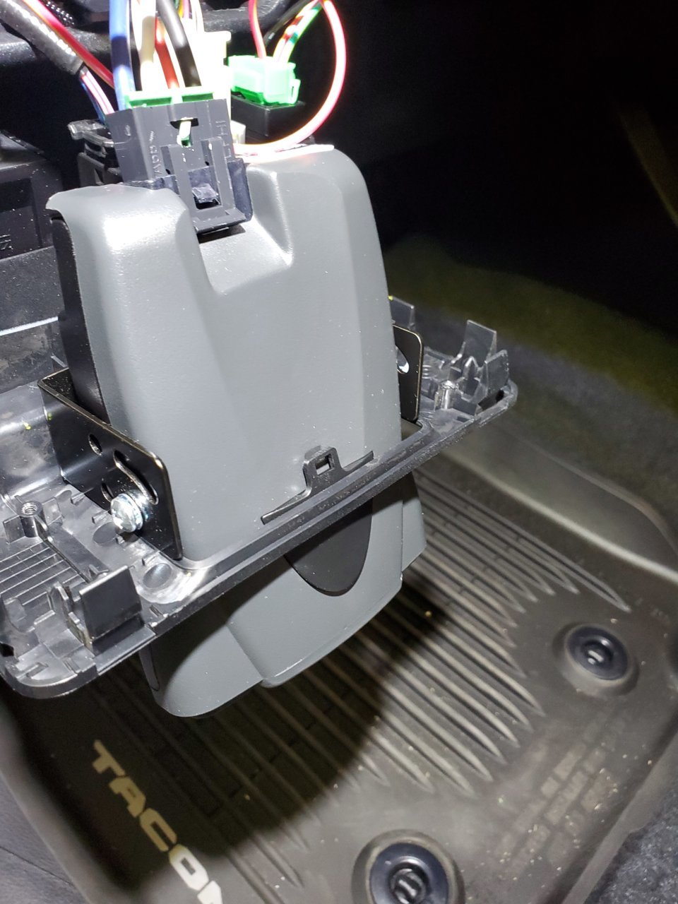

    It's jury rigged. I placed the bracket on the underside like this:
    This prevents the controller from falling out and adds some stability.
    This is a good temporary measure until you can order a custom panel to fit your controller. MESO customs makes a good one like I said in my post above this one.
    Those have a long lead time so in the interim I think the way I had mine mounted would be serviceable for you.

    That meso set up looks pretty sweet. Do you leave the P3 plugged in all the time? Doesn’t it draw on your battery?
