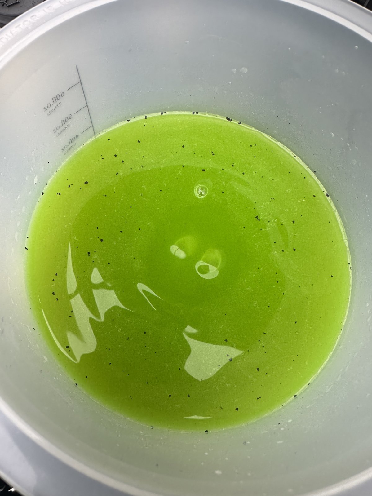

So I burped my coolant and this stuff was in the funnel

    Any ideas what that is or if I should be worried?

    If it's the original radiator and hoses, I wouldn't worry about it.
    Looks like normal cooling system "break down" contaminates to me.
    BTW, I much prefer the Toyota SLLC coolant than the "green stuff".

    Okay thanks I just bought this truck so trying to get fluids changed some basic maintenance done is Toyota SLLC coolant make much of a difference? Thanks.

    May want to check what the hoses look like inside, that looks like bits of rubber from the hoses. Usually happens when coolant is left for too long and starts deteriorating things.

    Some 4.0 05-06 were know to have head gaskets issues. Like others have stated stick with toyota pink coolant.

    Universal coolant is fine if it meets Toyota’s recipe (ethylene glycol based non−silicate, non−amine, non−nitrite, and non−borate). Walmart’s SuperTech antifreeze meets that. At 100K, I’ve always replaced the oem coolant in the cars I maintain with SuperTech or Prestone. Color doesn't matter anymore. Red/pink is just a dye Toyota uses to stand out from other colored coolants.
    The black specks are normal. If you google it, you’ll see that question pop up in every car forum. It can be residual matter from casting process and/or material separating from rubber hoses. In extreme cases it could be gasket material.

    In the old days, we used to put black pepper in the radiator to stop a leak. It worked, lol.
    It's probably one of the hoses slowly deteriorating. Change the top & bottom & the heater core hoses.
    Flush & repeat. Good luck :)
