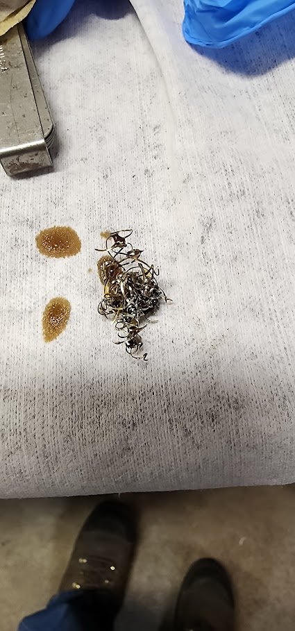

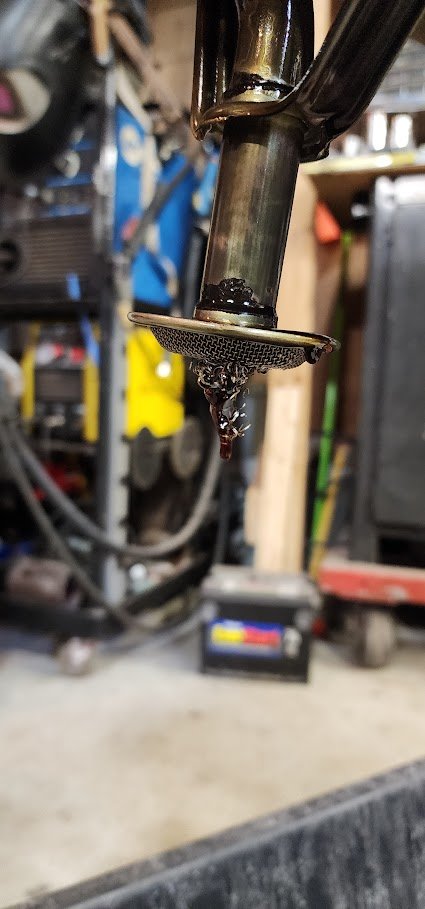

    Pulled the oil pan this morning for a sand blast and powder coat and found this gnarly bastard klinging to my oil pump strainer.. :eek:

    The strainer did its job!
    Cool incidental finding.

    so at 1st i thought the debris was a SS Brillo pad......like what a tech cleaned block/pan surface with. portion of pad dropped in OP
    but
    strings dont look uniform.....are the shaving strings found hard?....like could cut your finger?

    I didn't poke at it much before I had to run to work, but you are correct, I thought of brillo when I had it in my hands. It definitely looks like bearing material though. silver and brass colored

    Hmmmmmm
    eager to see a pic with OP removed
    Internet guess
    -bc I see “curly-cue” effect on the debris
    I interpret that as something round was getting shaved off
    Guessing that one crank cap(s)installed/torqued incorrectly.
    Maybe wrong cap part as well
    The protruding cap lip caught edge of crank shaft……got milled off. Like a cut to fit thing…..once clearance achieved, no issues!
    as far as cap bolts
    I would inspect each one…..then tighten barely…..then torque in sequence per manual
    That’s just me

    I would take a borescope and look at the cylinder walls
    look for shine or scored.....hopefully all clean crosshatching
    a stuck or seized ring might would shave just like that

    If she was rebuilt... looks like shavings from when the cylinders were bored to me.

    The crank has a one piece cap block that is captive to the rear seal plate so I wasn't able to get it off to look at the bearings. I spent quite a lot of time picking shreds of whatever out of the oil strainer with a needle. They were small enough not to be seen and wrap around the individual wires of the strainer. Don't think any of it was the block steel because I couldn't pick them up with a magnet. Some bearings did some self clearancing is what I'm thinking. I'm not going to lose a lot of sleep over it tho. As I have said the previous owner and the owner before him have both told me this truck always ran great.
