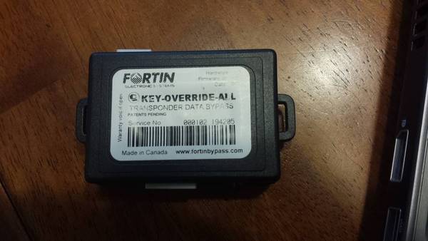

    I removed my glove box and found this surprise behind it:

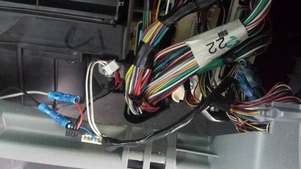

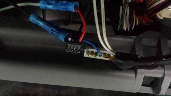

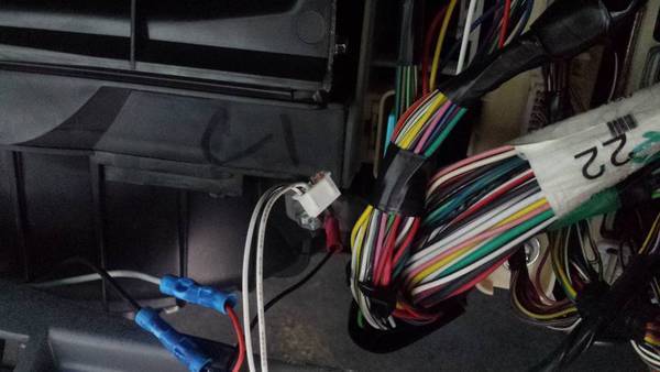

    What is it? I took it out because a bunch of the wires were cut. Should it be left there? Here's pictures of the connectors and wires in that area.

    Remote start bypass for the transponder key?

    I would think that its to bypass the security (chip) of the factory key

    put it back and leave it there or set your system back
    to factory wiring
    it is for a remote start takes place of the secure keyfob interlock

    That was most likely used as part of a remote start system. If you're using factory remotes, the previous owner probably removed the remote start system and left that thing in there instead of repairing the wiring after removing it.

    Trying to repair the wiring would be a real pain in the ass. I've also never seen that brand of transponder bypass, so I don't even know what kind of system to recommend if you wanted to add remote start. He probably removed it because it was a poorly installed knock off brand remote starter and wasn't working properly. And why that module was all the way behind the glove box is even more of a mystery. I usually hide my security / alarm / remote start components as high up in the dash as possible, all harnesses soldered and fully insulated with tape so that nobody could tell it was there, even when searching for it under the dash... which is why I didn't even consider removing my remote start / alarm from my last truck lol.
    I would recommend replacing it with a nice Python or Viper remote start / alarm system. It will probably be easy to identify all of the wires you will need to install it with, since they will most likely still have crimps / t-taps / harnesses attached to them. The new Python remotes are pretty sweet, too. It's an awesome thing to have, especially with SmartStart.
