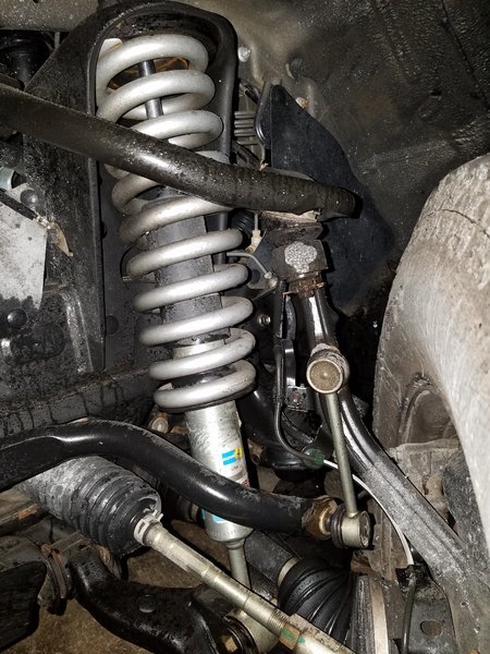

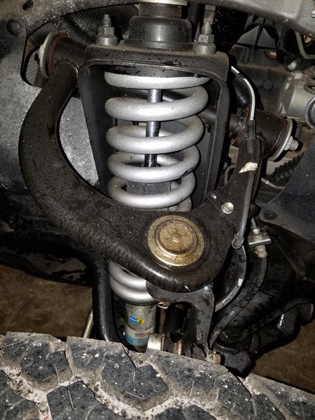

    This truck I just bought, has what looks to be a 3 inch lift (toytec), it rides great. No harshness, no squirreliness on highway etc. But it doesn't have uniball uca's which I thought was a necessity for that height. I'll snap some pics real quick for you gents and ladies, tell me what you think..

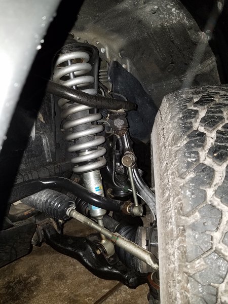

    Here's a visual

    It's not a requirement. If you can get the truck into alignment without it you can get away with stock uca.

    There are several good aftermarket UCAs that use ball joints. In cold areas where the roads are salted, many of us prefer the ball joint - it won't rust like a uniball.

    That's going to be way out of alignment with those stock UCAs

    Those CVs don't look happy either

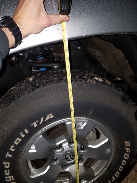

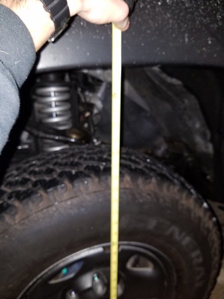

    OK the lighting is crap obviously but I measured stock ride height on my trd or and compared it to the new one. From ground to to bottomed of fender was 33in on trd, 38in on the new one
    Edit: tires are 265/70/16 and 235/85/16

    measure from centre of hub to bottom of fender is the correct way of taking that measurement but I'm not expert here so I may be incorrect.

    You're probably correct, it's cold here and it's messing with my brain

    measure from center of hub to bottom of fender. 3" lift should be about 23"

    Yep it's a hair under 23.5

    That's correct - this method gives an accurate measurement regardless of tire size
