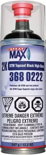

    1k or 2k clear? There should have been instructions with the paint.

    Not really sure what that means, it was the spray clear coat that came with my paint that I bought from automotivetouchuppaint.com

    Did it have a red thing you needed to put underneath it and puncture the membrane between the two parts or just shake and spray?
    This is 2k. Regular cans are 1k.

    Just shake and spray....the can in your picture appears a lot like a duracoat can with a Gardner in a separate container that you have to puncture and then mix (although they have to be used right away or they go bad)
    Mine was a regular shake and spray though.

    I couldn't get your website you bought the paint from to open. Is it mispelled? I'd reach out to the company if you can't find the documentation from the can or instructions on their site.
