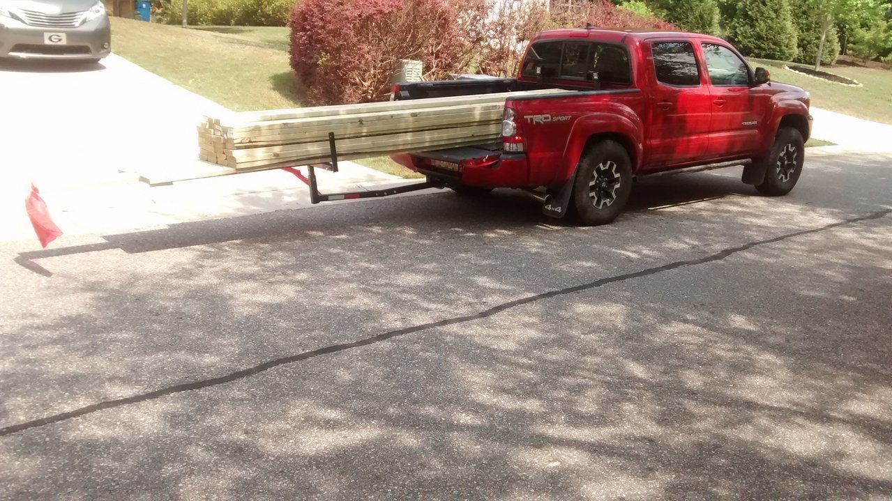

    But what if you had a long bed with a bed extender

    You're not going to fit a long bed on a short bed frame without major modification of the frame. The wheels sit in the wrong place for the bed. The frame is extended in front of the tires on the long bed. You'll also have to change drive shafts and extend wiring.
