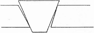

    I think you could have a couple things going on...
    The torque spec is for hubcentric/oem lugs. For a given torque value, hubcentric lugs have more clamping force than tapered. Most of the torque applied in tapered lugs is used to overcome lug-to-seat friction.
    Bolt circle of wheel might not coincidence with the wheel studs, giving an interference fit at your lugs and lug seats.
    Maybe check wheel stud radial runout.

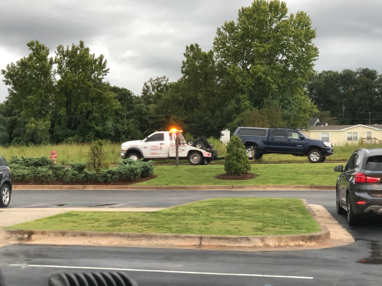

    We had a rash of wheel nut loosenings in town a while back. Several people ended up in your situation (and worse.) My wife's CRV was one in a similar situation as yours. Never heard if the police solved the problem but it seems to have stopped. Possibility anyway. Please don't use that wheel.

    Wheels are lug centric (tapered seats), lugnuts appear to be the correct taper for the wheels. There seems to be an adequate amount of thread engagement on the lugnuts too.
    I do have hub centric rings in the wheels to make up the difference in centerbore.

    Lug centric wheels are not necessarily manufactured to have the bolt circle coincide with the hub circle. When you force it to act like a hubcentric with hub spacers, it can set up the interference in the photo I posted previously.
