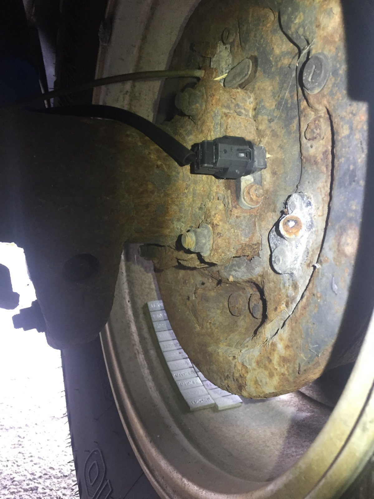

    Dad's truck wouldn't move an inch today. I gave it a little gas and Dad noticed the passenger rear wheel was frozen.
    I gave the E brake cable a good few yanks at the wheel. I got maybe a little over an inch of play. I put it in Drive, frozen, I put it in Reverse and "Snap" It could roll. Got to the end of the drive way and put it in D and frozen again. I shifted back and forth a few more times. I was able to baby it a couple blocks to a shop. Dad had them open the rear brakes and do an inspection and cleaning last week so we took it back.
    They said the cables are bad and replacing them may not be adequate as the truck is getting too rusty.
    They cut the cables at the wheel and up a little further at a bracket. They said they opened the drums and set the E brake to the neutral position. They said shoes got about 5000 mile left and kinda avoided swapping them now. They insisted we wait....ok....I got nothing to yank on if it happens again is kind of my concern....
    Does all that sound about right considering the rust and age?

    First of all, do you have an automatic transmission? So that means you probably never use the parking break. That causes them to seize up when you do need to use it.
    I just replaced both of them. I have a stick so I used them for parking. I needed to do a rear brake job anyway. I don't understand how they say. The truck is too rusty to replace them.
    I kept soaking down all the hardware that holds the brake cables to the frame with Kroil. I only had one bolt Snap off the frame where the cable crosses over it on the driver's side so I took bolt cutters and cut the cable away over there. It was a bit of work installing both new cables but I did get it done. And they work real nice now. I can't understand what they mean by saying. The truck is too rusty unless they're afraid. All the clamps and nuts and bolts that hold them in place won't come out. I got all the bolts outand except one. But I had patience and diligence.
    Edit
    Forgot to say I had the exact same problem back out of my driveway. And the rear brakes would not release And I use my parking break every day. It's just that my cables were worn out. The steel cable inside the jacket is coated with plastic. To make it slide and to keep it from corroding. The plastic wore away then corrosion got in. Also do not lubricate these. I don't think they need it in lubrication might soften. The plastic coating on the cable and actually make it wear away sooner.

    It's not lack of use.
    The cable sheathing breaks and the cable becomes exposed to the elements.
    Nearly every 2nd gen in a salt state has damage cable housings to the drums. This is starting to cause more issues like sticking shoes and breaking cables like this.
