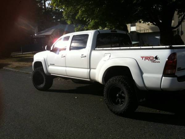

  12. Apr 23, 2012 at 4:51 PM
    jtav2002
    jtav2002 Kenny Fuckin Powers
    Jun 29, 2009
    #19074
    4,479
    Josh
    Reading, PA
    2013 Tundra DBL Cab TRD OR
    I have that kit, no complaints so far. You'd be fine with that or the OME kit. Lots of people run both. I got new UCA's. You may or may not need new ones to get aligned within spec. If you don't mind going back to the shop and getting another alignment you could always try without and see what happens. I just got them right away to avoid any issues or having to go back in to the shop to get them installed and have it aligned again.
