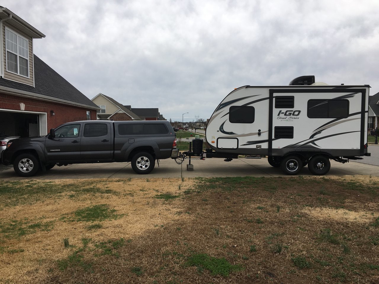

    IMG_0043.jpgFirst Welcome aboard. There are a lot of different opinions as what to tow with a Taco. Mine will be at or under 2 tons loaded and ready to go. To me the only problem towing with the taco is the 21 gallon gas tank because the MPG is cut in half when towing. Read the towing bible, set your truck up right, use common sense and you should be fine.
