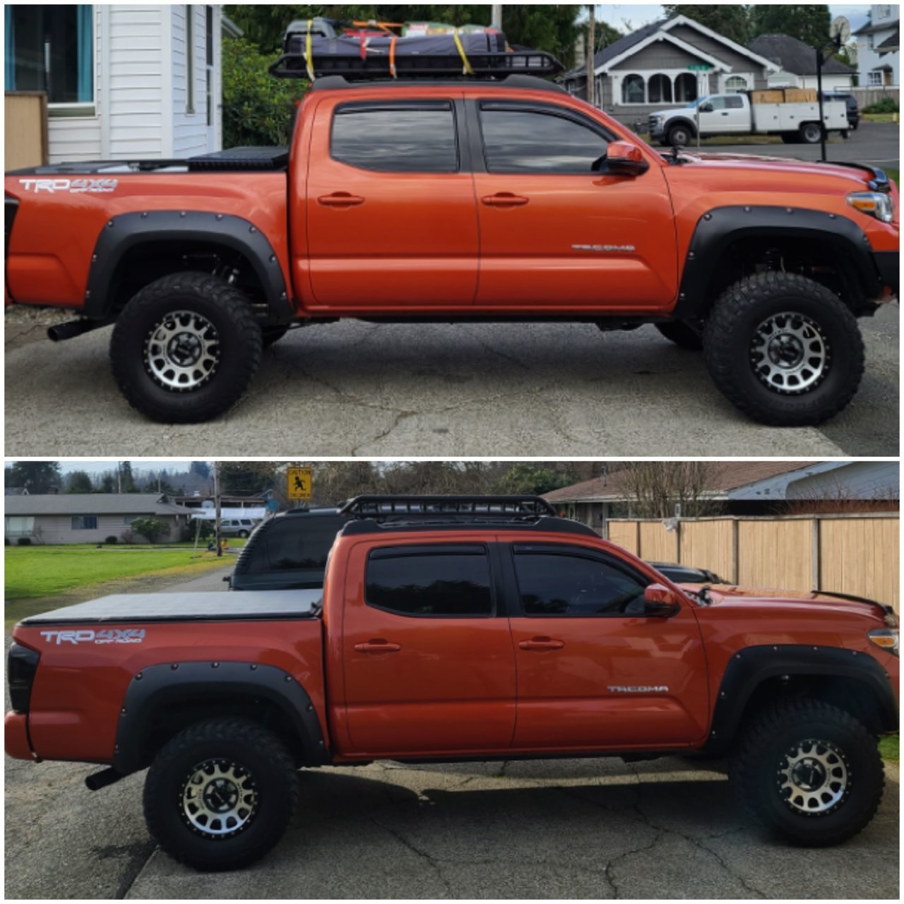

    In this picture my truck had 3" front 2" rear lift . Tires 285/75/16 km3's. Went to moab in April did a ton of trails never rubbed once . Now my trailer hitch ha savior. Also made me do urd crossover ypipe mod. Anywho it was a spacer in front , original Bilstein shocks all around, "diff drop bracket kit", rear was a 2" aal. I upgraded shortly after to 6" love it . Rides better than before .

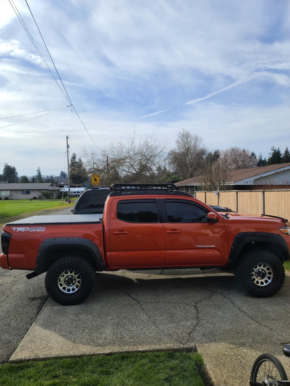

    Here it is...
    Next step will be ordering tires (265/75R16 KO2's)
