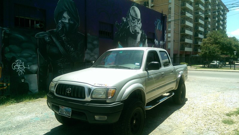

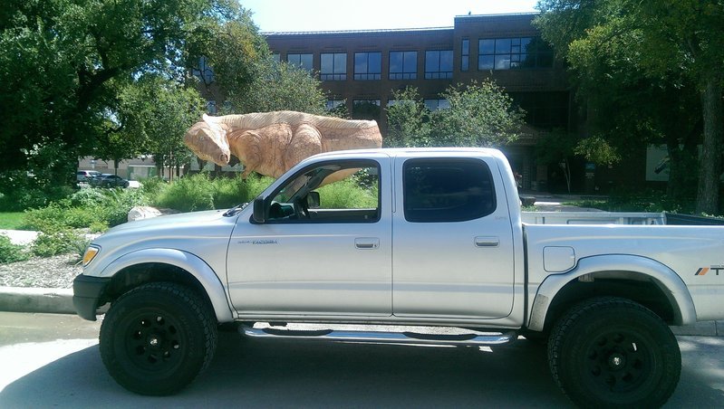

    I recently did 5100's with 881's and a AAL and am happy with it, also I did not need the extended brake line.

    Have any pictures?

  9. Aug 30, 2016 at 5:49 AM

    It looks great. How big is your rim/tire setup?

    265/75/16, she's getting there just waiting for front and rear bumpers to get here and then next month I'll probably order some sliders.
