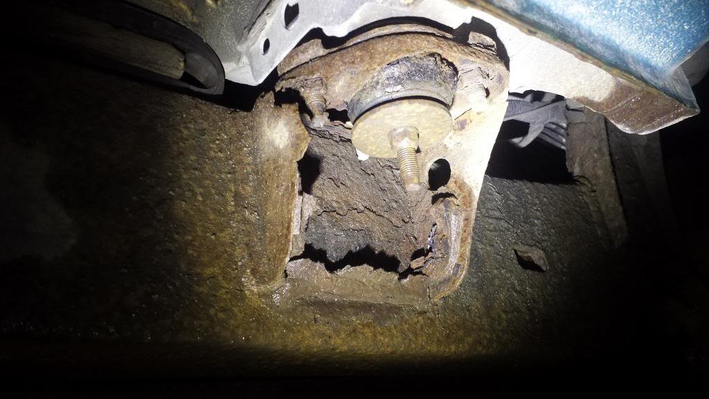

    Happy to join this site but unfortunately it isn't under pleasant circumstances. I have a 1996 Tacoma 2.7 LX, diagnosed with a serious rust cancer on the rear half of the frame.
    My girlfriend drives this truck 99% and happened to bring it by the shop today so I could change the oil for her. She had mentioned the cab seemed to be sagging at one corner, so I rolled under there to check it out and was very saddened to find a serious rust problem.
    Looks like the left rear cab mount is completely gone and worst of it all the springleaf mount is completely gone as well, leaving the rear axle out of alignment.

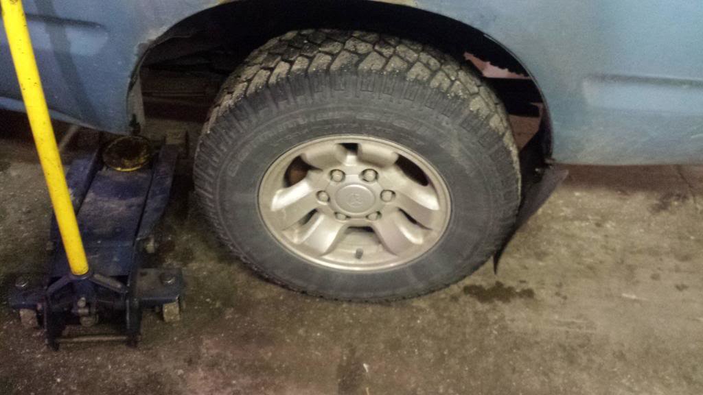

    This is with the cab supported at one corner with a jack.

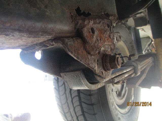

    The leaf spring:
    What are my best options? I realize the recall is long gone with this truck and I have only owned it maybe 2 years? Would my insurance total it if I took it to a body shop for inspection? Anyone know where I could order another mount for the cab that I could weld onto the frame?

    Yeah, insurance will definitely total it. You could try to find a frame at a junkyard and cut off the mount. Or you could just fab up your own mount.

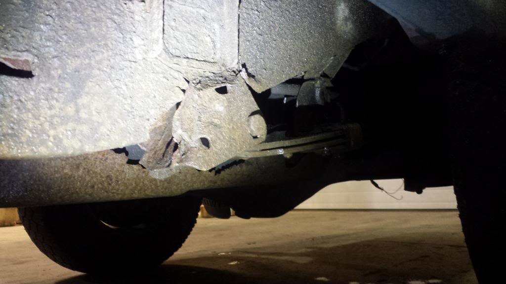

    I just got off the phone with my area Toyota service manager. I took mine in for the bulletin inspection in November 2011 and it expired in Sept. 2011. I never got the notice I just took it in after a coworker told me about the bulletins. I never got the notice because Toyota had the original owner connected to the VIN still. I guess I should have taken proactive measures when I purchased the truck in 2006. Anyway, even though I missed the bulletin deadline by 2 months, he said bring it back and they will take photos to send to Mother Toyota and see what they say. In 2011 the truck checked out fine. So in just 2 years, the holes have reared their ugly heads.
    He said he couldn't promise me anything but it was worth a try. I was coming across pretty doubtful they would do anything but he kept encouraging me to give it a try. I almost detected somewhat of a "I am not suppose to say this but I think you have a chance of having something done about it" . I am not really that optimistic though. Maybe if they see I am a 2 time Tacoma owner since 1992, they might show me some love. Again, not counting on it. He did say that even though the buy back is over, he has heard of some cases where they have still bought them back.
    I guess next best scenario is to have a frame guy fix the one spot IF the rest of it is not rusted out. If so, I will have somebody put a rust proof coating on it to extend it's life a few more years. The service manager said he has one customer who had a really good job done of a fabricator building a frame over his rusted frame. I bet that cost a pretty penny.
    Worse case scenario, it is deemed unsafe, unfixable, not getting bought back, and I have to sell it as when the disclaimer of the rust problem. That would suck beyond belief since the truck is in such good shape otherwise and I only put 3 - 4 thousand miles a year on it.

    Here's mine.
