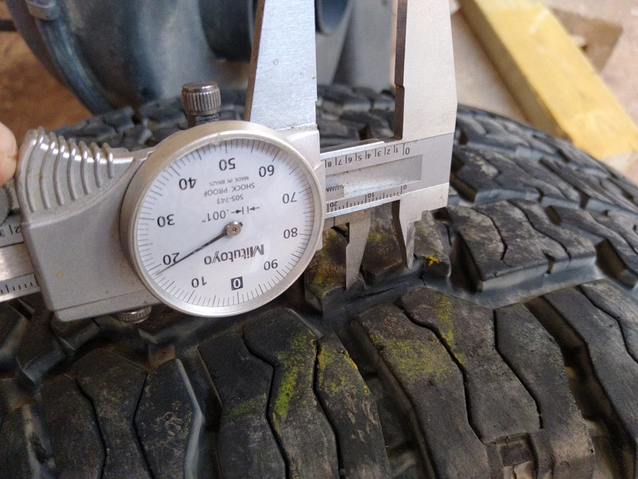

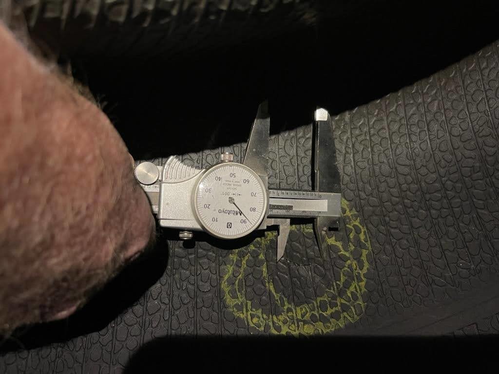

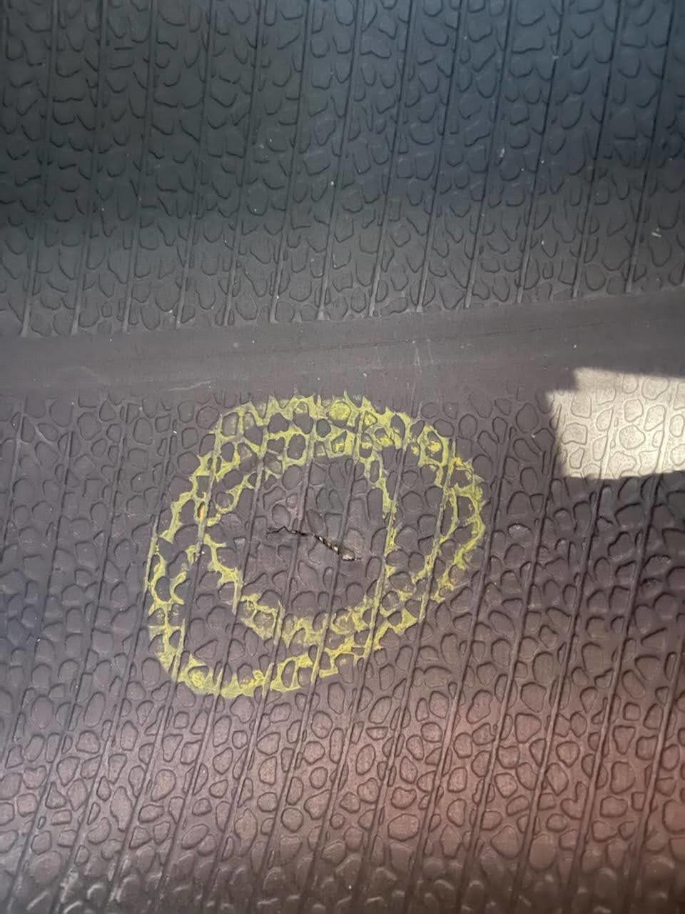

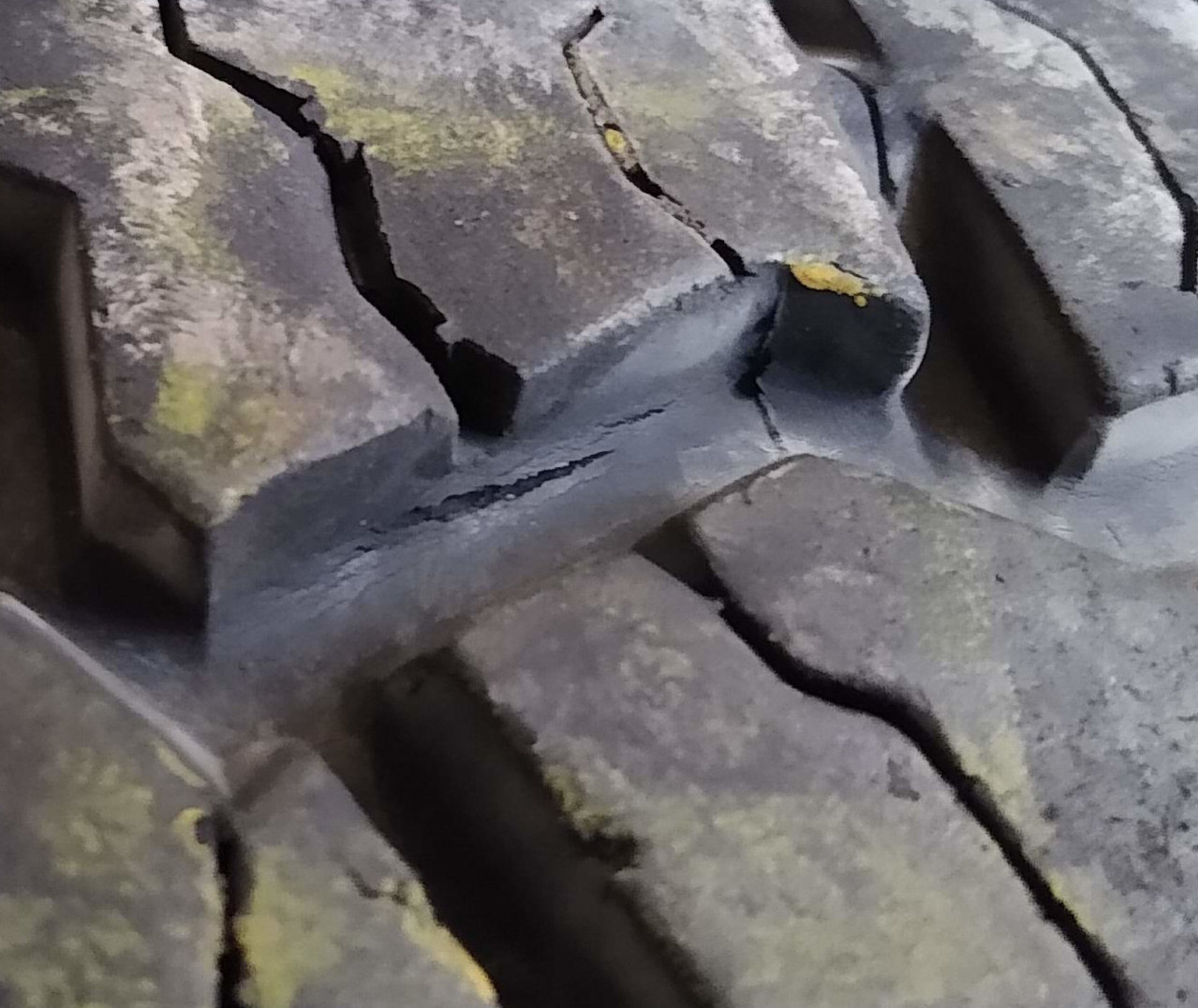

    Tire shop (Big O) chalked this up to hitting something sharp.
    On the inside, sure, kinda looks like it:
    On the outside it sure doesn't! Tear is smaller on the outside too.
    I'll admit, I'm a bit perplexed by this. I've never seen a tire failure like this before. The tire is relatively new, on the truck 6 months, date code around 2 years ago if I remember correctly. Tire is a Cooper Discoverer RTX - one they make for Big O.
    No way that was a cut from something sharp in the road. That is a pressure failure. I would bet the damage is from a hard, blunt impact damaging the cords - who knows when - and then the heat cycling in use and tire pressure eventually caused the failure.

    Eh, a 6 month old tire looking like a 30 year old tire would give me pause also. Hell, a 30 year old decent tires doesn't look that bad unless it's been collecting water and skeeters in the sun for 20 of those years. Son is a chemist, the stuff that makes rubber flexible, pliable, and not weather check are what costs money. Guess where companies cut costs the easiest? Yep, the expensive stuff in the formula, just a bit less in each one makes the numbers go up.
    Heck, I have some almost 30 year old tires still on a vehicle that look 10 times better then that. Yeah, yeah, I need to replace them but after seeing even expensive Michelins weather check like crazy by 6 years and out of the sun 99% of the time, I'm convinced it's more the low quality compounds in new rubber tires that cause failure and not age. [like the manufacturers claim]

    So it's not possible you ran over something to cause this? It's 100% a tire failure?

    Sure looks like a cut to me tires fault for running over some thing sharp.

    I don't meant to discredit your experience but these kind of impacts, if they result in broken cords, will be very apparent as the tire will be out of round in a way as subtle as to cause a balance issue or as obvious that the tire is visibly lumpy. It's very likely a puncture/tear from a piece of debris

    Looks like it could be a rock puncture.
    Is it a Passenger rated tire?

    Could be, but I don't recall hitting any rocks that hard. I do drive weekly on 15 miles of dirt road with lots of rocks, but I'm that guy driving slow. I tend to think it would be a small hard object on the freeway that I might not notice.
    Its a truck/SUV tire, though perhaps not an AT rated tire.

    i've had two Cooper at34s do the same thing FWIW, nothing that could be found to damage them and no Offroad use but splits right between the treads none the less
