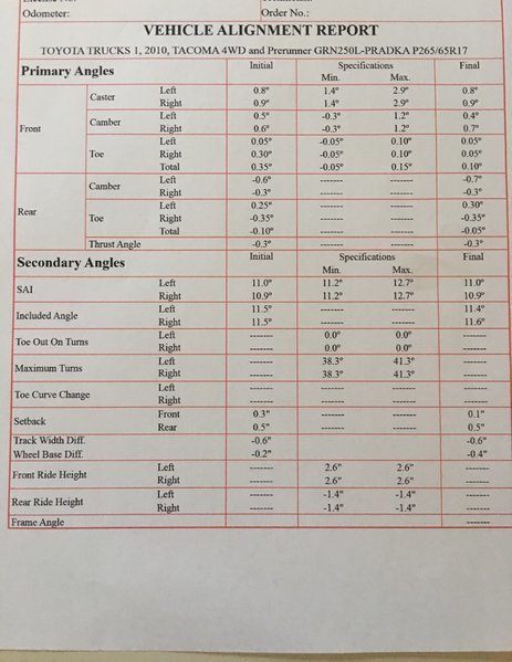

  2. Dec 17, 2016 at 3:10 PM

    seniorredwood
    seniorredwood [OP] Assistant to the Regional Manager
    Aug 18, 2016
    #194949
    620
