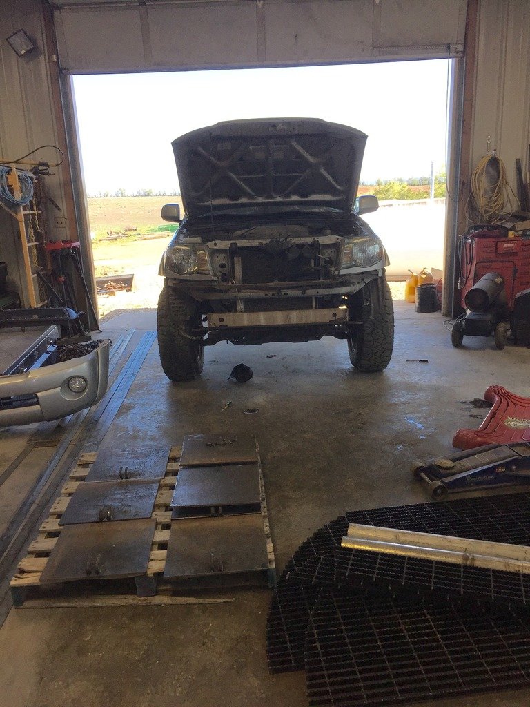

    Got her mocked up for the most part! Hopefully cut and get everything welded or at least tacked up tomorrow. I'm torn on whether to color match silver, flat black, or just rhino line it??? What do you guys think???

    Sub'd to see the results. I'm really on the fence between designing my own bumper and getting a relentless diy kit. How are you planning on doing all the cutting? Good ole angle grinder? Or do you have a plasma cutter? Looks great so far

    Thanks man! We've got a plasma cutter at work, definitely gonna take my time on this build!

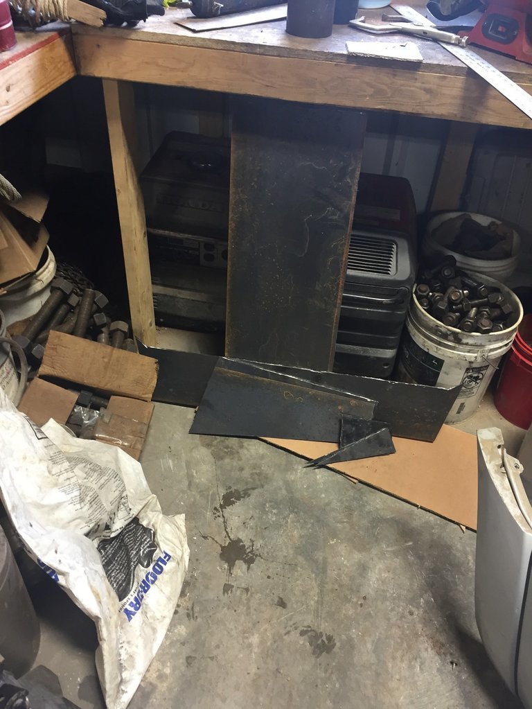

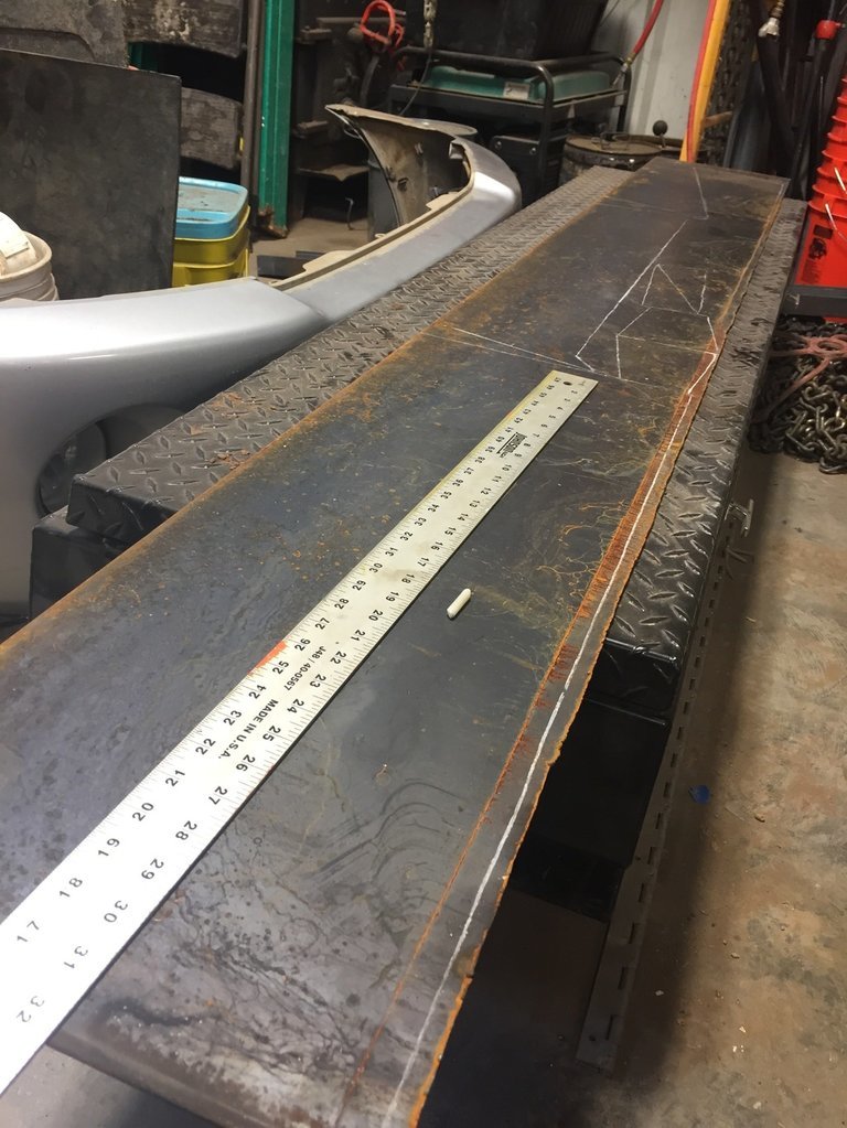

    Getting everything laid out and ready to cut! I lucked out, we had scrap pieces of 5/16ths!! Bumpers costing me nothin but time now! Why scrap metal when you can build something!?!? :D:thumbsup:

    Are you doing the whole thing in 5/16"?

    Gettin there, 2 more pieces to cut. Clean them up, and get started on mounting brackets. And I'm using 1/8th steel plate, just shy of 3/16ths. Can't decide if that's heavy duty enough or if I should build gussets on the inside???? Than the recovery points are going to be 1" steel plate

    5/16" would be a little to heavy duty hahahaha
