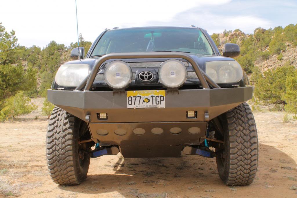

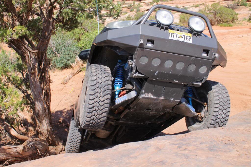

    I would definitely go heavier than that on the mounting points IMO, I don't think you will find a bumper out there that uses anything less than 3/16" for mounting, most are 1/4". A 1" clevis does you no good if you rip it off the frame. Are you going to add a winch?
    Here is mine.

    That's bad ass man!!! And ya I'm going 1" plate with some heavy duty square tubing for the brackets.

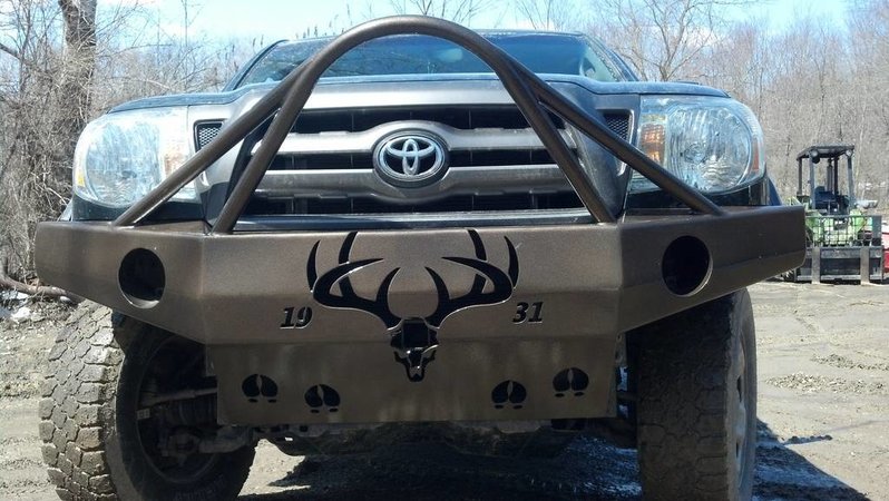

    The bumper I built. 3/16" with 1/4 brackets

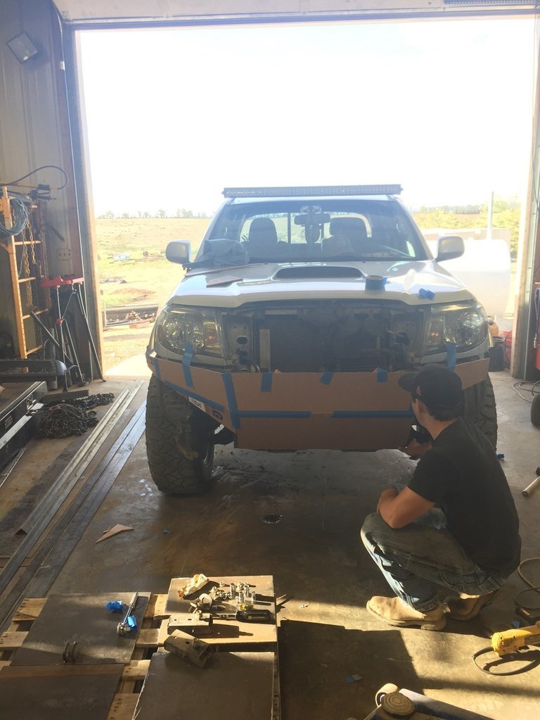

    47917A27-40D3-4318-9A68-0723A279F0AE_zps_bbdab4ca45a547d273374eb687edbe838226fa35.jpg
    Man this is such a long process! So many different angles. You fellas that have built bumpers to look good, PROPS!!!
    She's gettin there, just trying do make it perfect and do it RIGHT, cause I know if I don't I will regret it!

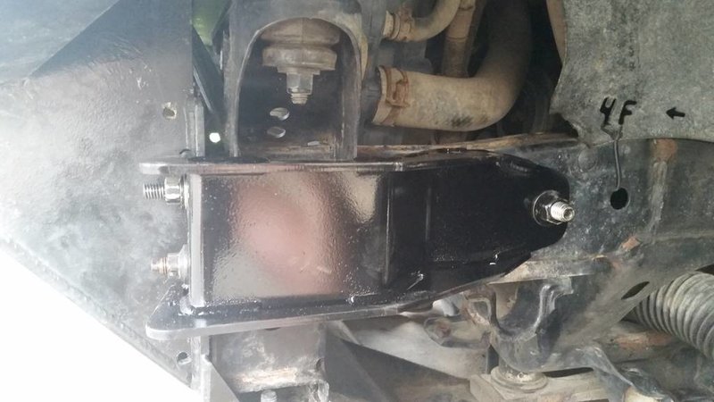

    The mounting points from the original bumper, underneath that are 2 I believe 19mm bolts that were/are holding some frame extension pieces in. I tied in here and removed those frame extenders. Alot of companies additionally build a bracket to tie the bumper further back into the frame as well shown here. It will have a big heavy washer on the opposite side of the frame to really pinch it tight.

    In pic, front two viewable bolts are original mounting bolts. Under that near the gusset you can see the 19mm bolt mentioned. There isnt a way to thread it in, so a big heavy washer ad nut or a squar plate with a hole in it and a nut welded to it are usualy used.

    Ya I'd rather fuck up cheap cardboard, I got the steel for free but there wasn't a whole lotta extra so I didn't wanna screw it up. In some aspects I think it woulda been easier to build it on the fly.
