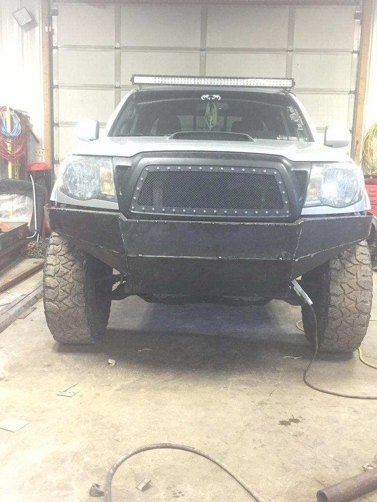

    I lucked out. Mine was white. I got my paint from home depot. Yours looks little big to do all white. Maybe White black combo/ or All black look good.

    White painted may be a little to much in my opinion but it sure lookin good with your work in progress!

    Looks white as hell in this picture, but your profile looks silver.

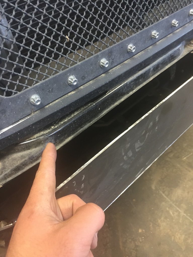

    Did you guys remove this bracket???

    I took that off. All the lower supports I took off. and trimmed back the middle. The top is supported enough. I wouldent recommend if your BAJA the fuck out of it. But daily driving and light off roads. Youll be alright.

    Sweet deal thanks man! And I agree my truck looks white as hell in that pic, I didn't even realize it until you guys said something

    Also when your done and you want to hide that nasty gap that should be no less this 1/2 between bumper and body for flex. You can order this. You can check my build page to see how it looks and what it covers up. They make different sizes so just do some measurements and then order what you need. Super soft so its awesome and provides support when you take off the lower bracket.

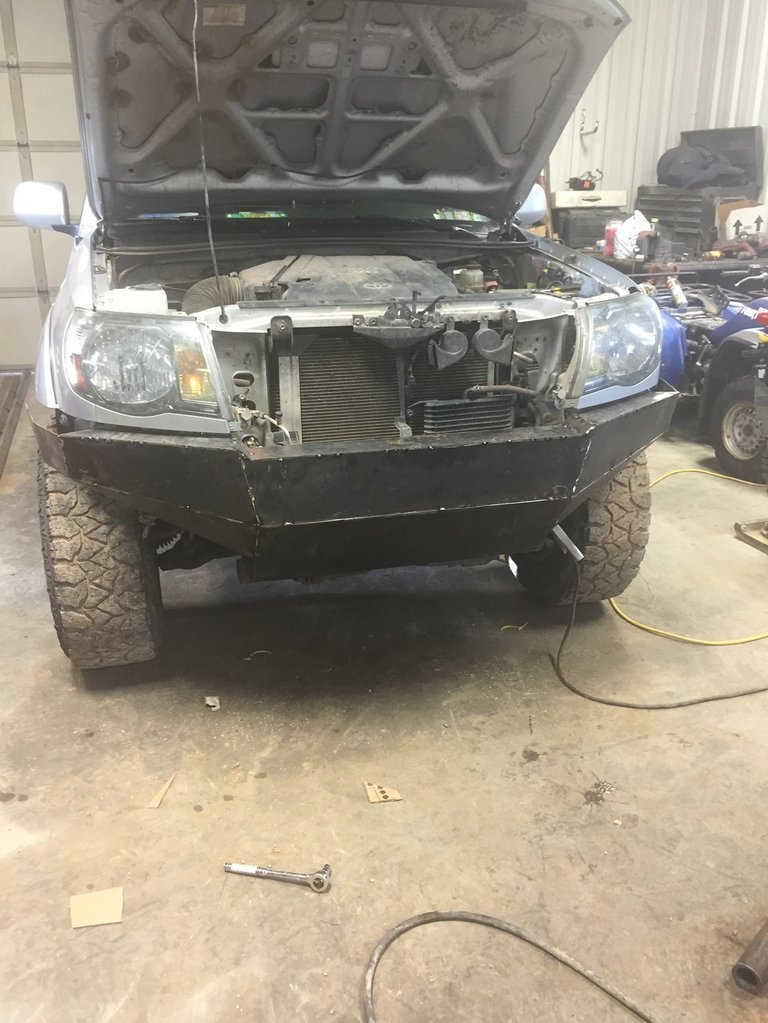

    Coming along! All that's left is the outer edge of the wings, the under edges, and the perms any mounting brackets/recovery points. And paint of course.

    Seriously dude this bumper looks super bad ass! Great job! Can't wait to see finished product!

    That picture drives me nuts cause it makes the bumper look crooked haha
