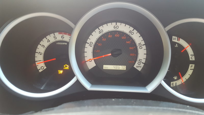

    So, I leave the office to get in the truck, fire it up and the check engine light and the trac off light come on and stay on. I drive right down the road to visit a friend at the hospital and notice the extreme lack of power. What the heck? Anybody have any idea? Mass air flow20160708_201032.jpg sensor or something?

    Truck does that EVERY time a CEL gets triggered. People on here will speculate bit that's all it will be till you pull the codes

    Most auto parts stores do it free. Loss of power could be alot of things from MAF to your cars everything in between

    Left it at the shop, they will pull codes first thing in the morning. Thank you for the response

    No problem...I'll try to respond once you post up the codes if I know anything about it. Most of the time tacoma only trigger a few codes.
