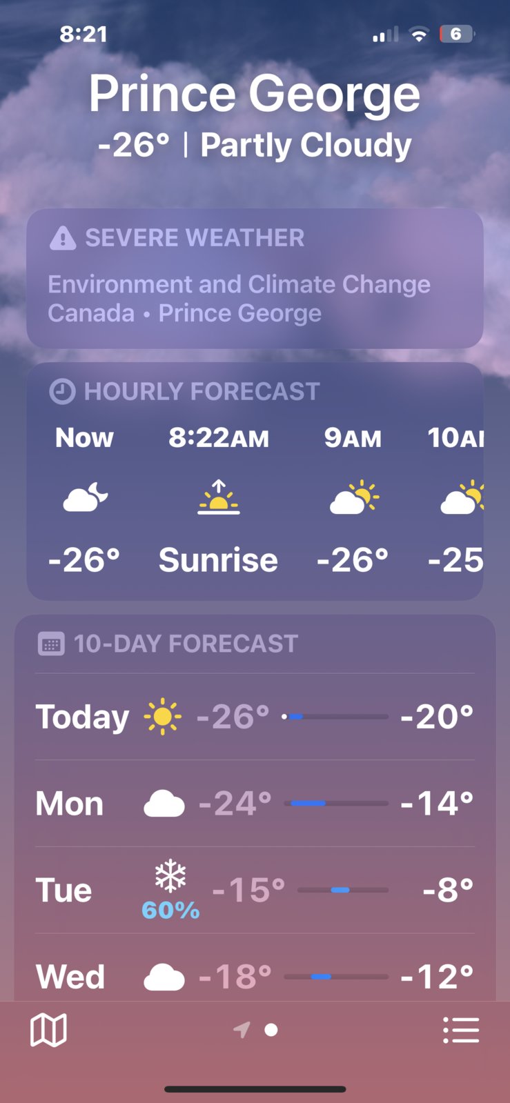

    -35 is a bit rough yeah, but I don’t mind it. I enjoy a more rugged living.
    It’s warming up next week so it’s not bad. It’s usually like a deep freeze for a week then it warms up.
