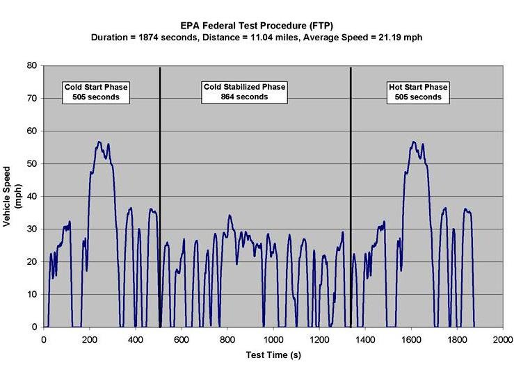

    Shift pattern and early upshifts are designed to maximize mpg on the EPA dyno test cycle...
    Not real world but all the car companies have to try to maximize around that specific FTP drive cycle.
