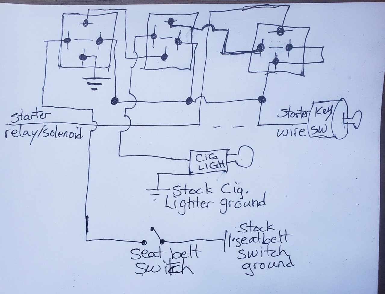

    Sorry I wasn’t speaking to your diagram specifically. My thought probably tended to be a bit more philosophical than instructional, with the top bit noting that an interruption of the hot wire, say right after the ignition switch, would still be bypassed if one were to connect the ‘disabled’ hot wire to 12V say with what used to be a pack of NiCad batteries and now is probably LiPo connected at the right spot in a fuse box to power up the hot wire irrespective of a kill switch. That is, a kill switch works as long as an attempted illegal hotwiring (only takes a second with a battery pack and access to fuse box) does not bypass the kill.
    My comment about already having relays eluded to the fact that the COR is already in place so you can put a switch on its signal wire and avoid having to place another relay that might look out of place or be another possible point of failure.
    Lastly about ECU I was saying that you can make modifications to the signals it gets, and it will decide to not run the truck. This is more difficult for somebody to spot and reverse.
    I fully agree that your use of a relay is a great way to make a kill switch and it no doubt helps people figure out their own scenarios, thanks for that.

    The drawing in post #55: cigarette lighter is sitting there as if you don't want to light up a smoke and it will not start, push in lighter as if to light up a smoke and truck will start.
    That scenario is extremely unlikely. 99.99999% of thieves have no clue about wiring, batteries, or anything like that. Maybe if it were a Ferrari or Lambo idk.
    Aftermarket Bosch, Potter & Brumfield, and DEI relays are extremely durable if mounted pointing up. Hook up to the ECU and you better think about what is going to backfeed into what, using diodes etc... but why? You obviously can think, use the aftermarket stuff and hide it well. Eay peasy, lasts forever and a day.
    So far so good.

    You can certainly add a kill switch using a relay. My point was that typical means of hotwiring can defeat the kill switch, depending on you you set it up. Sounds like you have a method you like, nothing wrong with that.

    In this set up the seatbelt needs to be plugged in and the cigarette lighter pushed in all of the way in order for the vehicle to start. How many car thieves do you think plug in their seatbelt before starting the vehicle and light up there smoke at the same time?

    I just read your first post. Yeah that is one way you could do it.
