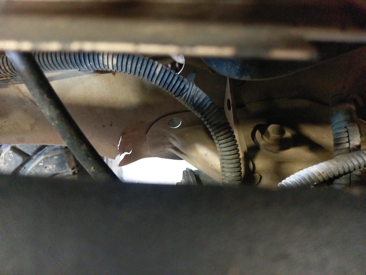

    Rear axle housing:
    Mine cracked and leaked by the spring perches.
    Welded it up.
    Still leaking...

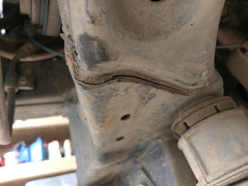

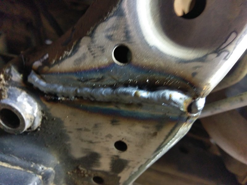

    Coil Bucket:
    Mine cracked by the outer bolt hole.
    Welded it and added a steel plate on top.
    Still cracking.
    Working on a more permanent solution. Keep an eye on this one or you'll end up with a catastrophic failure like @Digiratus
    Edit - Welded new crack 9/28/19 - keeping an eye on it.

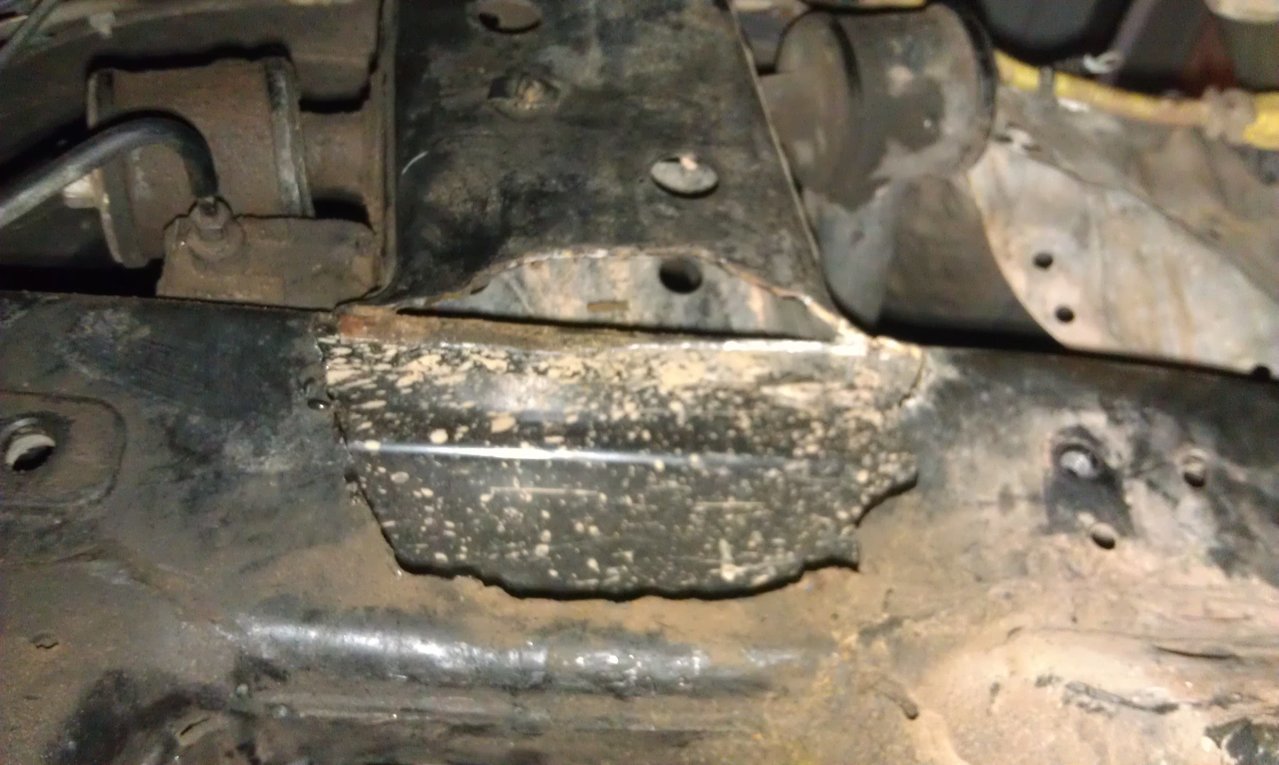

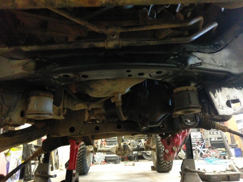

    Front frame crossmember.
    Cracked on factory welds. Haven't seen this one, might be just my truck. :rolleyes:
    Welded up and it's been fine for several years.

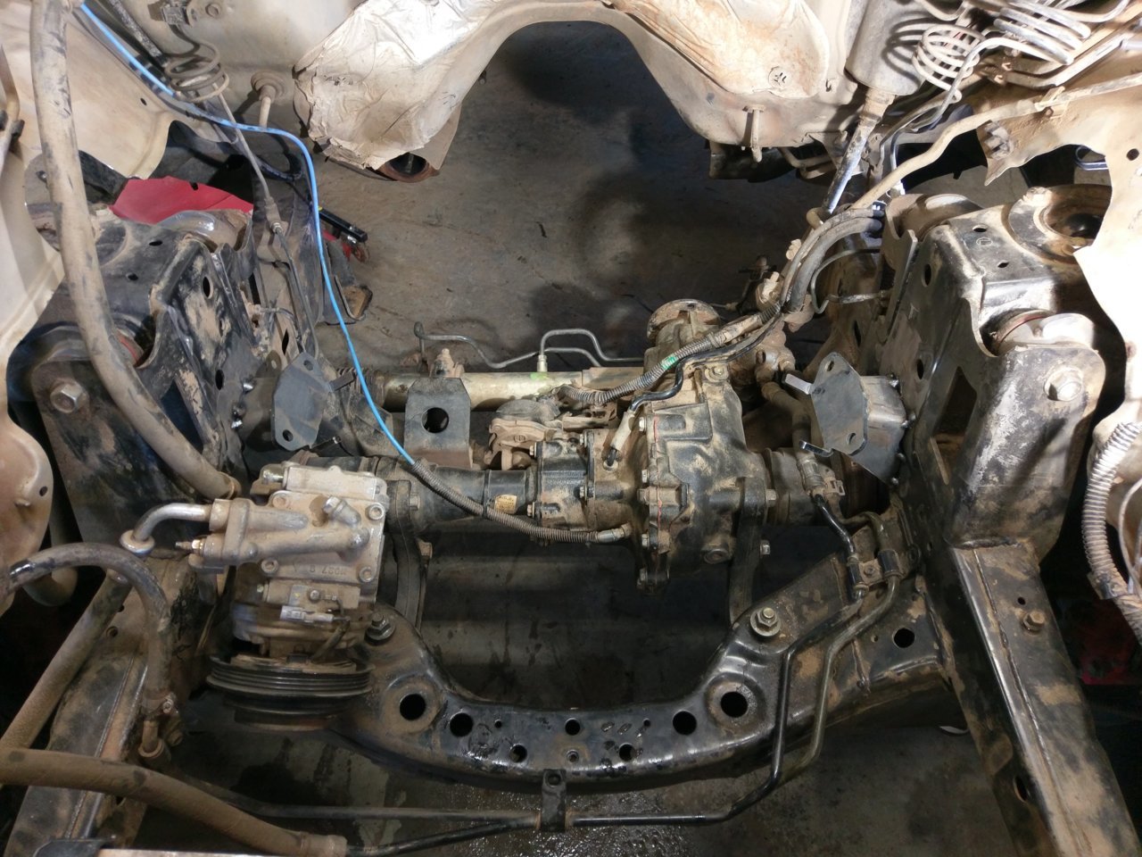

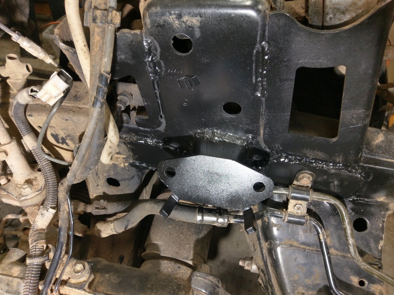

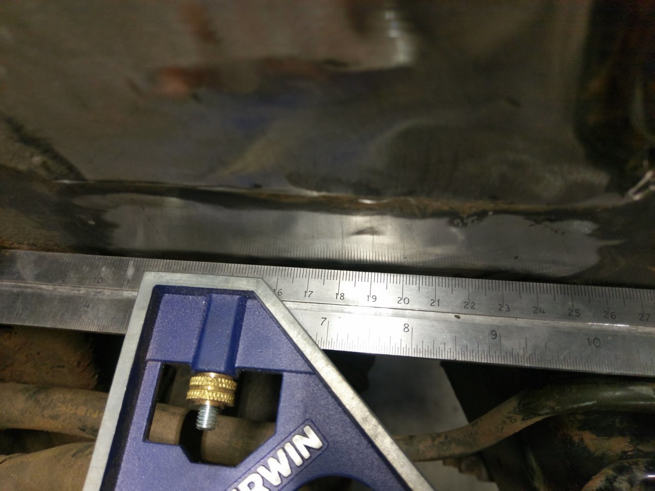

    Motor mount perches:
    One of the few things I got to before they cracked. Pretty common failure point for 1st gens.
    The frame also is know to push in/break.
    @TMFF 's frame
    Mine was only bowed in slightly
    Replaced with perches from Next Venture motorsports. DMZ makes some too.
    Also added some plate around the area to help prevent it pushing in further.

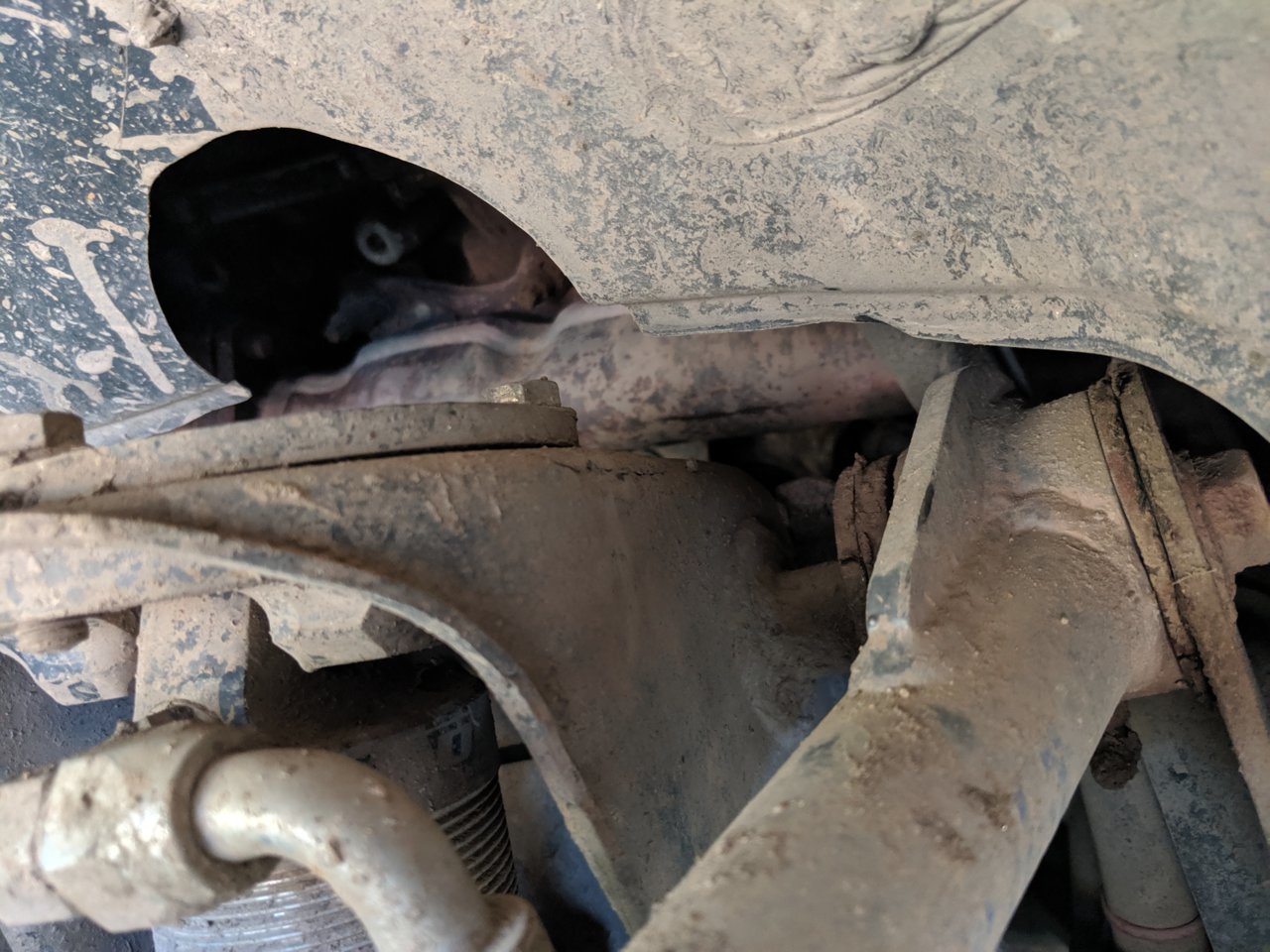

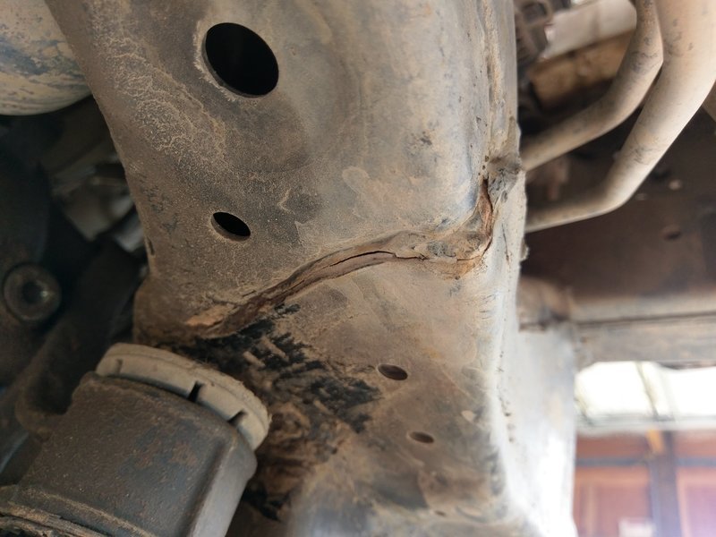

    Driver's side steering rack mount.
    Starting to crack. Stealing @Reh5108 's picture.
    Haven't done anything yet.

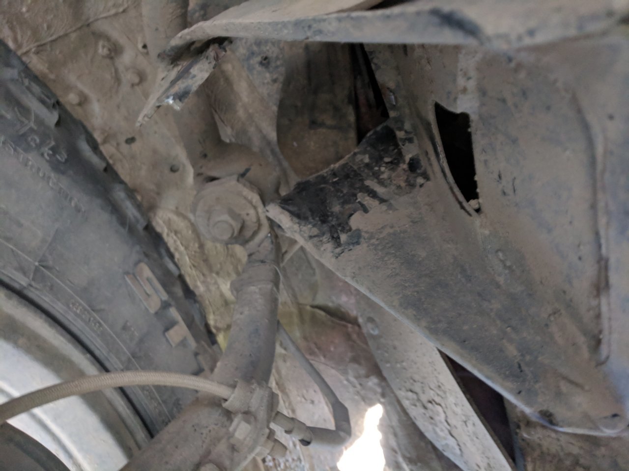

    @m3bassman called it on the LCA shock mounts. Also have a few little cracks forming around the rivets.
    Ground, drilled and welded the cracks, and then all around the shock tabs. Will be keeping an eye on this one.
