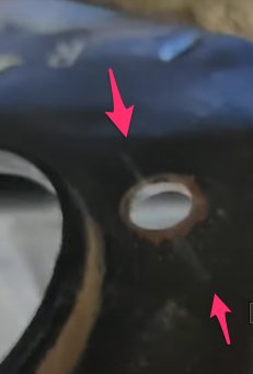

    Not wanting to be a further contributor to the dramas in this thread. I tried to do a close inspection of the passenger side coil bucket when I was in there today swapping out the axle.
    Found it quite challenging to be able to see very much along the top of the bucket. But then had an idea. I use the phone camera to get up in there.
    Here is a video of the inspection. It has been 5,000 miles since the coil buckets were installed.
    https://www.youtube.com/watch?v=mxNQ4JE8Dt4

    Is that a crack already forming on the front-most bolt visible on the top AND bottom?

    Blackdawg
    Blackdawg Dr. Frankenstein
    Dec 31, 2010
    #48500
    81,652
    Monte
    Wyoming/St. Louis
    The Trifecta of Taco's
    hm did you do you motor mounts? You headers are smacking your coil bucket.

    I'll look at it closer tomorrow. The bucket is much dirtier than it looked like to me. I had wiped it down but obviously missed quite a bit. There are a lot of streaks. I'll see if those lines rub out.
    :oops: Self clearancing.
    Yes, new rubber. That happened on the first adventure back in April. Happened the first time I used 4lo. It doesn't touch at all in any other situations.

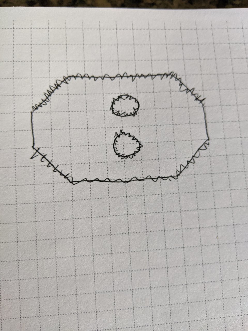

    @Squeaky Penguin started to truss his but I think discovered that it's tough to beef up that spot. I just picked up some 3" schedule 40 pipe to lay down and then I'll weld perches on top. This is how the axle is on my t100 so I'm guessing Toyota realized it as a weak point in a heavier duty truck. I'm guessing it's due to fatigue cycles.

    I think the axle is caving in around the perch due to the thin wall thickness of the axles tubes.
    A top truss might be easier then a back one like I tried to fit, but I think your idea of doubling it up there and welding one a new perch is a solid idea.

    Talking with a certified welder from work he recommended I not weld the top part to alleviate stress there. Anyone else feel the same? Hope my 2d sketch gets the point across. That will be pipe cut in half. Squiggles are welds.

    It's wrapping around the bottom of the axle tube underneath the perch, right? I think you'll want to tie it into the perch somehow, so that the stresses are taken by the pipe section and distributed to the underside of the axle.
