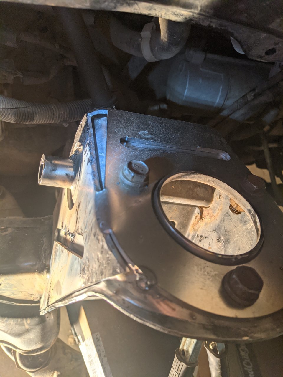

    Started fixing mine this week also.

    I like how yours is going all the around. Very nice.
