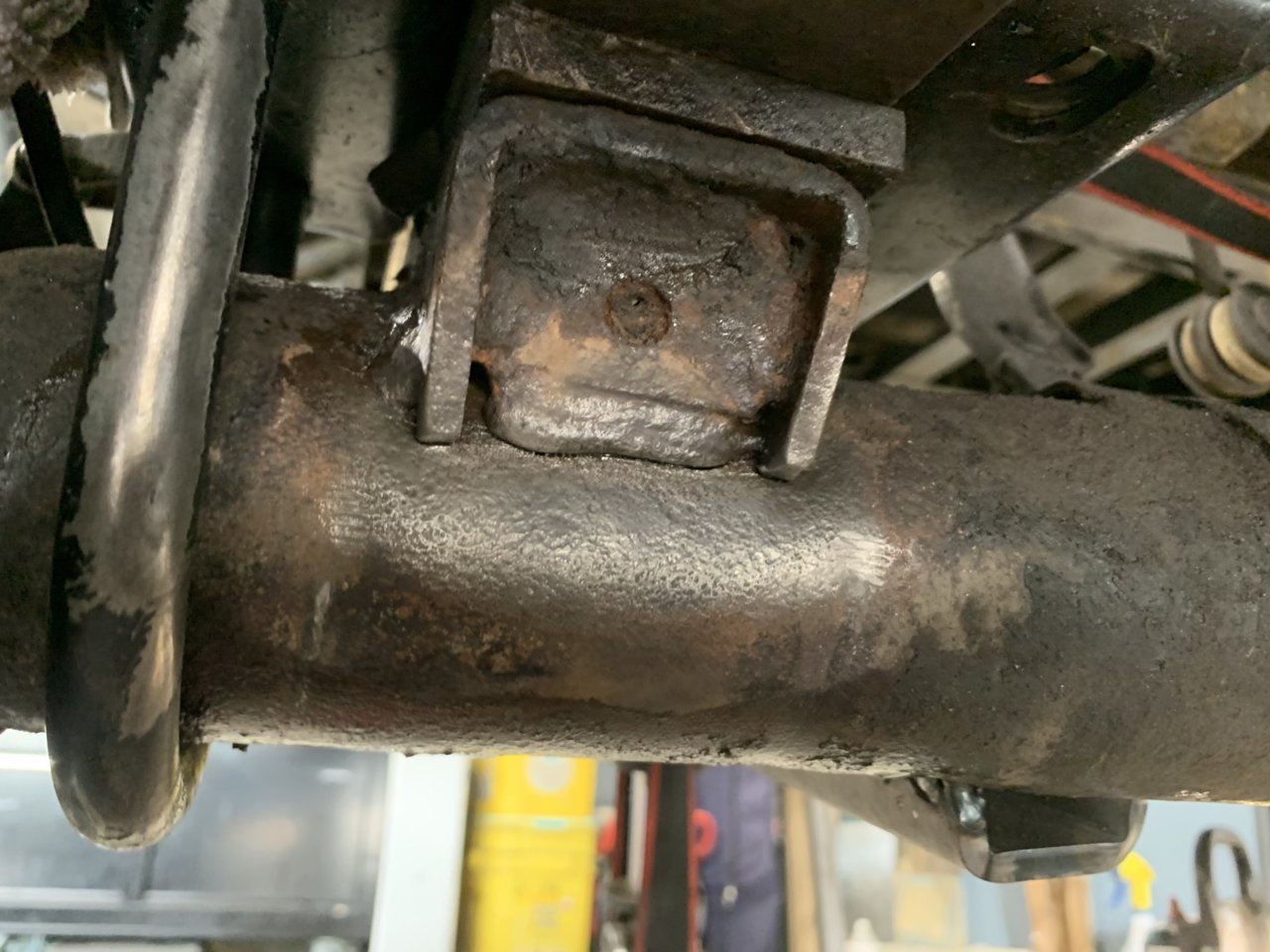

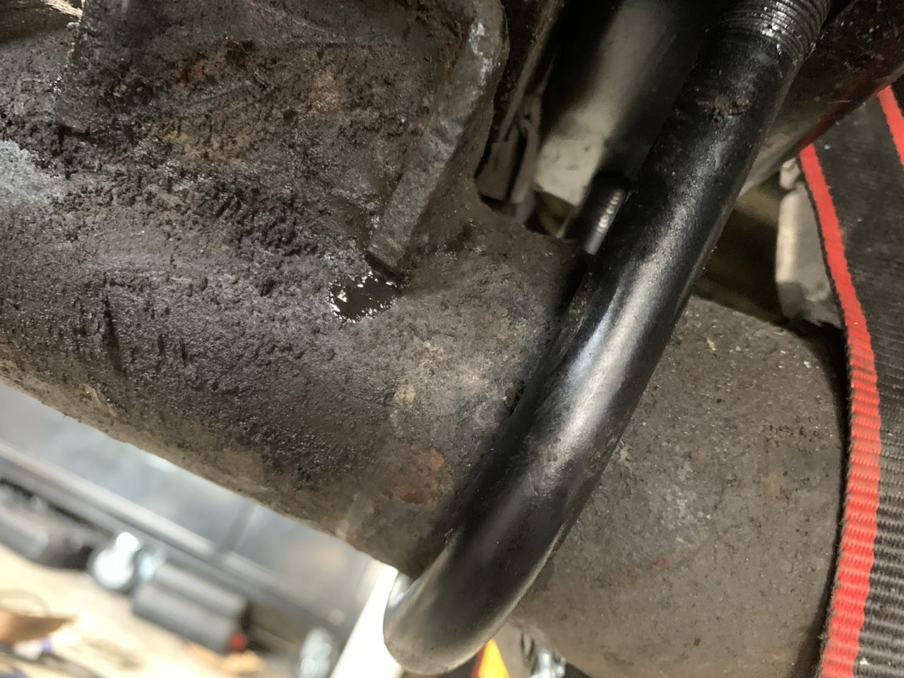

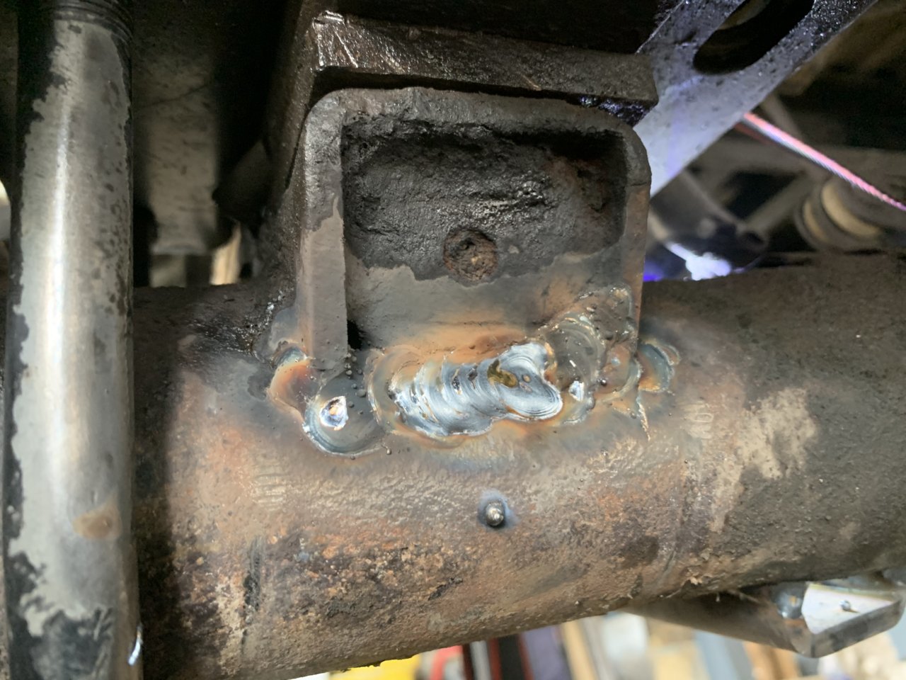

  12. May 24, 2021 at 12:34 AM
    #272
    cynicalrider
    cynicalrider #NFG
    Jul 25, 2012
    #83399
    17,204
    Jersey
    01 SR5 TRD 4x4, '23 Bronco Wildtrak, 2017 HSQV FE350
    Drop bracket lift and booger welds
    Leaf spring perches. Honestly not even sure I fully fixed the issue because I was under the gun and ran out of brake clean. Was rewelding my shock mounts/testing flex side to side when I saw a leak coming from the perches that smelled like gear oil.
    It was so packed with dirt and shit that I assume it’s been seeping for a little :notsure:
    I cleaned it up a bunch and shot a bunch of wire in there lol
    I thought these things were supposed to be thick af? im hoping it is fixed at least temporarily and I’ll move up my search for a full float fj80 rear.
    *EDIT*
    This post from @Dirty Pool is interesting about the u bolt flip...
    It's funny because the metal on the axle housing almost looked like it was bulging to me from the last u bolt flip kit I had on there. But I also thought that the axle housing should be pretty thick no? Not enough for u bolts to essentially crush/deform the axle, but it almost seems like that's what I see in my picture on the leaking side. Friends told me it's just from the u bolts/rust wearing it that way, but I feel differently.

  13. May 24, 2021 at 1:01 AM
    #273
    Blackdawg
    Blackdawg Dr. Frankenstein
    Dec 31, 2010
    #48500
    81,652
    Monte
    Wyoming/St. Louis
    The Trifecta of Taco's
    I believe Brett had this same issue. not sure just rewelding it totally held up over time for him.

    Glad you noticed it now.
    My fix has held up thus far. I cut the perches off and welded half sections of 3" pipe on top and bottom of the axle. Then some new perches on top of that.
    Squeaky Penguin[OP] likes this.

    I believe his are still leaking according to the thread after I read back lol.
    Yeah fuck all that noise, I'll be keeping an eye out for a FF fj80 rear with the factory locker. Already annoyed that I'll need to weld those goddamn shock mounts AGAIN on the new axle :facepalm:

  16. May 24, 2021 at 6:59 AM
    #276
    Squeaky Penguin
    Squeaky Penguin [OP] Nothing Ventured, Nothing Gained
    Apr 5, 2012
    #76340
    10,100
    Brett
    Steamboat Springs, Colorado
    '01 4WD, SR5, TRD & '13 TRDOR AC
    Lots of dust and custom dents, Check Build
    I pulled the axle, ground down the cracks, rewelded, and it leaked on the 1st trip after that. Think it was coming from inside the perch.
    That axle went to the scrap bin, and I tossed in a used factory housing and I welded all the way around the perches. No issues yet.
