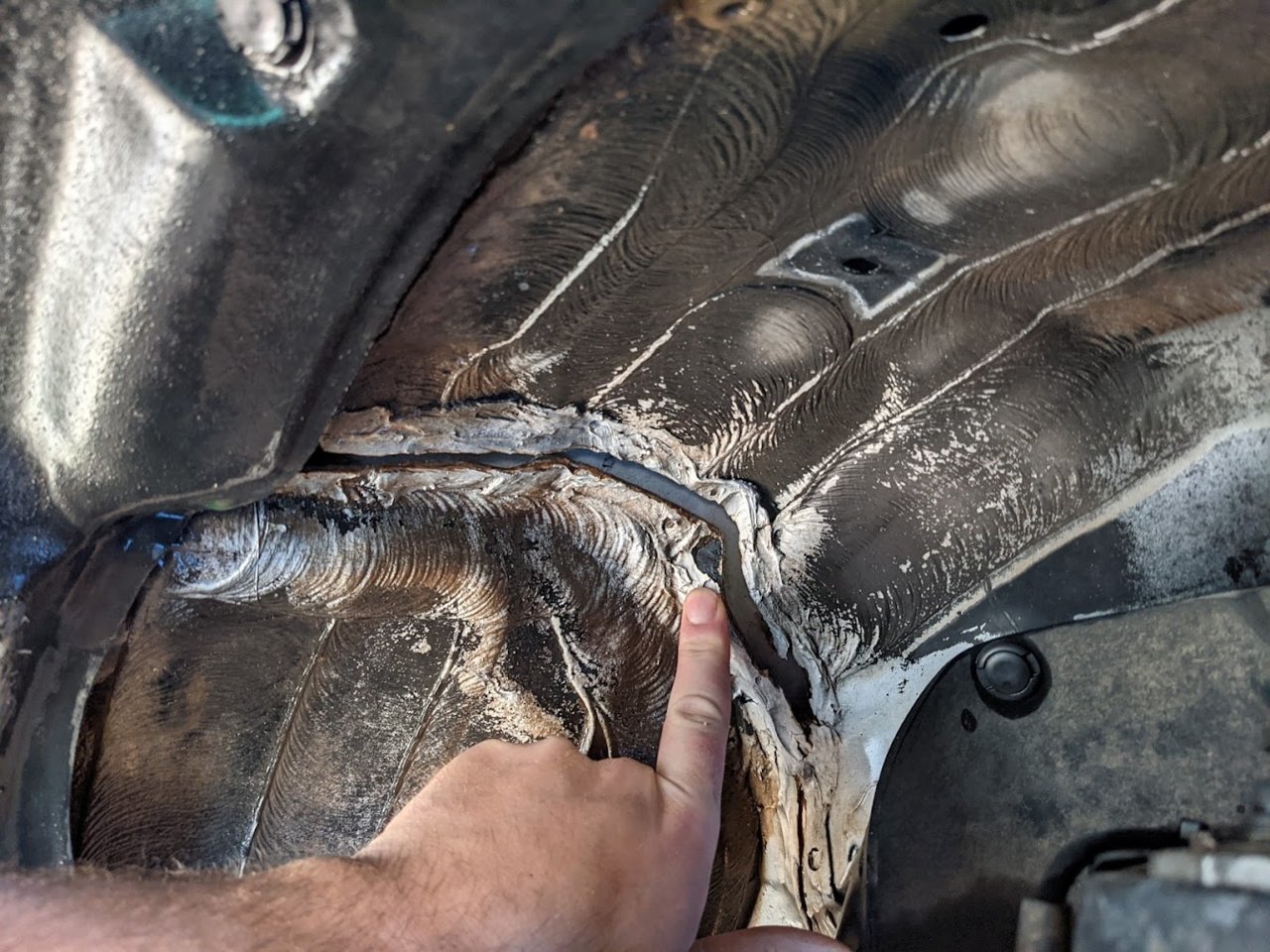

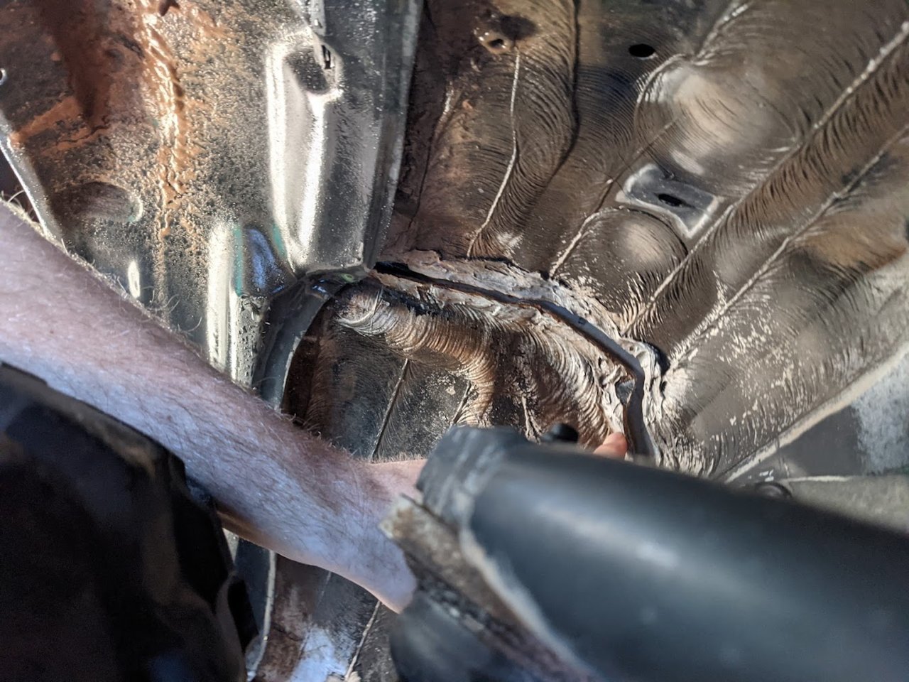

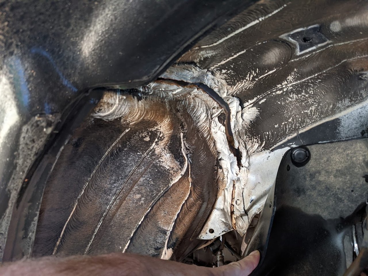

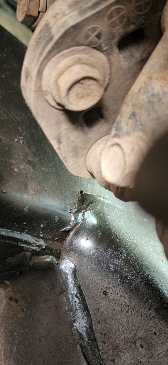

    Passenger wheelwell, top rear.
    Had a small crack for a while, but it really started to separate on a recent trip to Moab. I'm lazy and haven't pulled everything apart to see what a repair would require, but I'm a curious about a couple issues.
    • Is what appears to be white sealant/glue original? Is that how the panels were joined from the factory, or were they welded and this is from a previous repair?
    • Anyone done this fix and if so, any advice? Especially related on the best way to pull the panels back together prior to welding. Or would I be better off fabbing a sheet metal patch?

    It's less Tacoma and more mod
    Your inner fender apron is trying to fall off, you're gonna want to tack that back together and then slater seam sealer back on it (that's factory by the way, and flammable)

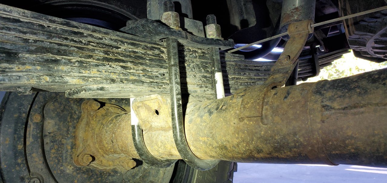

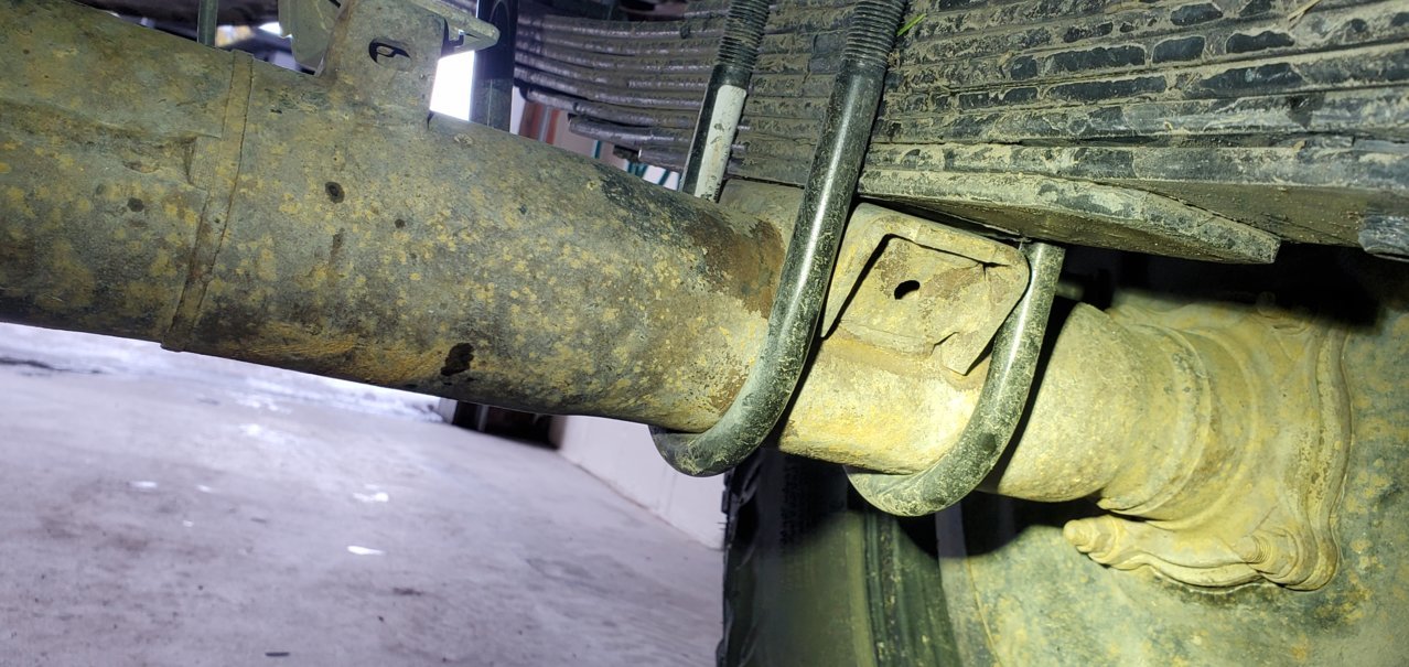

    Not a crack, but on the same spot other people have had leaks on the rear axle. Crushed the axle housing tubing under the driver leaf perch this weekend after trying to hop up and over an ice shelf.
    Time for a fabricated housing if I can get ahold of Front range offroad. Ruff stuff isn't making their housings right now since they don't have a welder to make them. And there aren't any non builder housings for an 8.4 from TG.
    Bad side
    Good side for reference

    Nice work!
    Is that a slight weep that was starting by the corner of the perch?

    No. nothing's leaking currently.
    Was likely moisture or snow from driving around prior to taking the pic

    2000 Tacoma SC 2.7 4x4 5spd

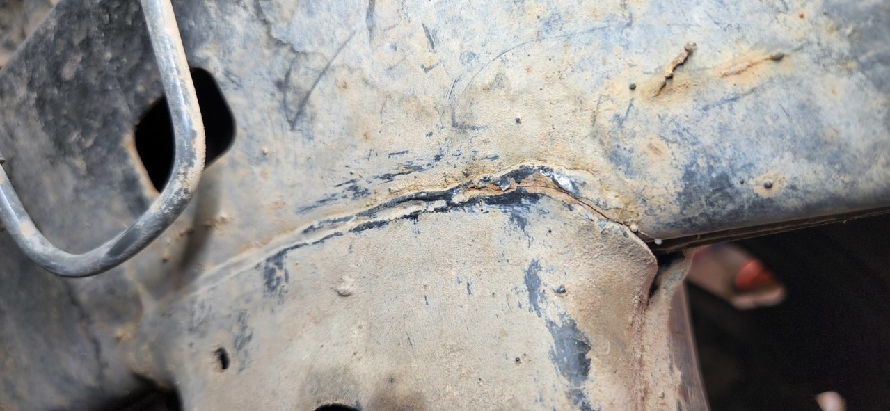

    Front subframe :|

    You don't say. How's this one look? lol

    also the passenger side.
    Yeah something fishy on that. Good luck on the fix man. Not an easy one but totally doable!

    Replacement shock towers/coil buckets were still available when mine was destroyed.
    Edit: These are the part numbers for my '02.
    Coil Buckets
    Driver 51501-35080
    Passenger 51502-35080

    Damn…right through the weld.
    Do you think you could grind into the crack, clean it up and re-weld?

    I still maintain that just plating the top doesn't solve the issue. It keeps the coilover from cracking that part, but clearly the whole bucket is getting hit harder all around and more so then the driver side one.
    So I think plating the whole thing is the best way to do it. Similar to what you, Ryan, and I did.
