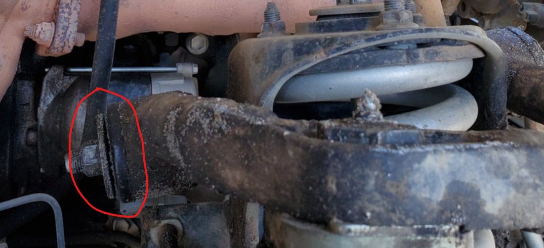

    Could be the photo, but looks like the UCA bolts isn't tightened all the way down onto the UCA arm?

    Washer is concaved they always look like that but good eye

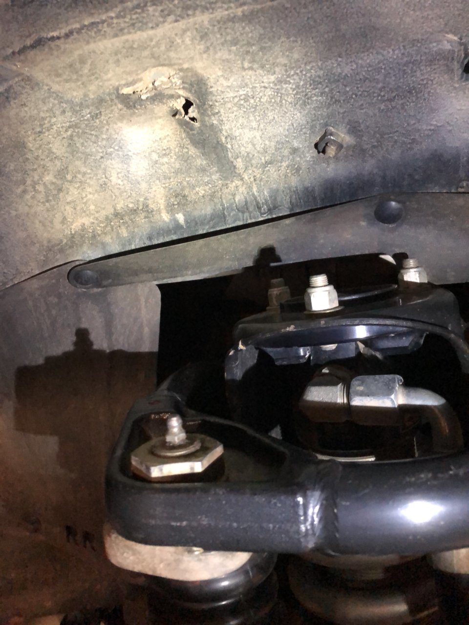

  7. May 11, 2022 at 11:36 AM
    #347
    Digiratus
    Digiratus Adventurer
    Mar 26, 2010
    #34006
    23,858
    Roaming the PNW
    The RedHead

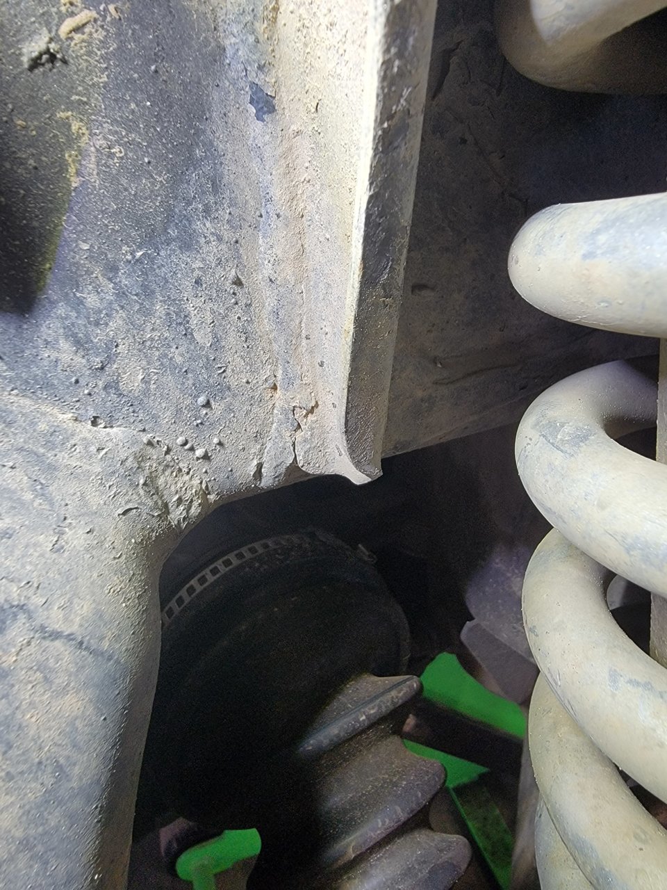

    2002 XtraCab TRD 4x4 SCv6 AutoTrans With Lots of Mods ADS COs w/Compression Adjusters Camburg Uniball UCAs Whiteline Lower Control Arm Bushings Kartek 7" Limit Straps Plastics Guy Front Bumpstops Total Chaos Sprindle Gussets Custom Alcan Springs +800 lbs +3" ADS 10" Stroke Triple Bypass w/Resi Rear Shocks Custom Rear Shock Relocate All-Pro U-bolt Flip w/Timbren Bumpstops 4.88 Nitro Gears ARB Front Locker ARB Twin Compressor Black 17x8 Konig Countersteer Type X 285/70r17 Falken A/T3w Gunmetal 16x8 SCS Ray10s 255/85r16 Maxxis Bighorns Limited Edition (Relentless) Elite Front Bumper Smittybilt X2O 10K Winch Diode Dynamics SS3 Sport Selective Yellow Fog Lights in the Bumper Diode Dynamics SS3 Pro 4,000 Kelvin SAE Driving Lights with Clear Lenses on the Bumper Morimoto D2S Projectors XB35 Ballasts + 4300K Bulbs Badland Sliders FrankenFab Tire Carrier Swingout bumper w/kitchen BudBuilt Front & Bellypan Skids BAMF Rear Diff Skid Dometic CFX 55im Fridge/Freezer Alpha II Hardshell RTT Badland Custom Bed Rack Denso 210-0461 105 amp alternator Dual Northstar 24F AGM batteries BlueSea 7622 ML-ACR Battery controller Peak DBI Dual Battery Voltage Monitor Haltech IC-7 Display with Mako Dash Insert Haltech Elite 2500 Standalone ECU Magnuson MP62 Supercharger w/URD 2.2" Pulley Doug Thorley Headers Denso 650cc Fuel Injectors Aeromotive Stealth 340 Fuel Pump TransGo A340F Reprogramming Shift Kit OEM ECU Delete Full A340F Trans Control with the Haltech 2500 ECU 2.5" Magnaflow Hi-Flow CAT Magnaflow 18" Muffler w/Vibrant Resonator 13WL Brake Calipers with OEM Rotors & Pads Braided Steel Brake Lines Kenwood TM-71A Dual Band Ham Radio STI-CO Flex Whip VFH/UHF 1/4 Wave Antenna Midland MTX275 GMRS Radio w/Roof Mount Antenna Pioneer DEH-P9400BH HU Alpine Amps & Type R components (F) and coaxials (R) Wet Okole Seat Covers Weathertech Digital Liners Deck Plate Mod 1" Diff Drop Carrier Bearing Drop
    OEM weld terminus. A lot like the cracks found on the LCA tabs.

  10. May 16, 2022 at 5:25 PM
    #350
    Squeaky Penguin
    Squeaky Penguin [OP] Nothing Ventured, Nothing Gained
    Apr 5, 2012
    #76340
    10,101
    Brett
    Steamboat Springs, Colorado
    '01 4WD, SR5, TRD & '13 TRDOR AC
    Lots of dust and custom dents, Check Build
    Not sure how well I could get them to work with the TC gussets, but I could try.
    Anyways, drivers side was worse. Welded them all up and will keep an eye out.

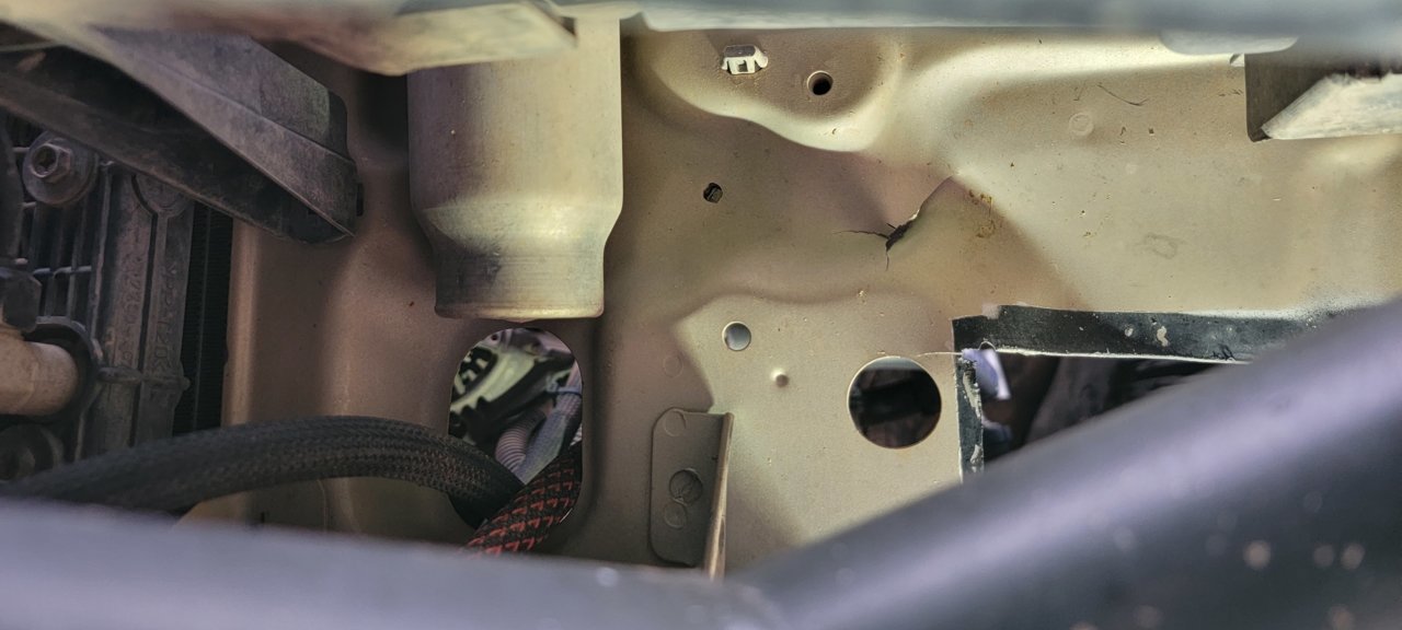

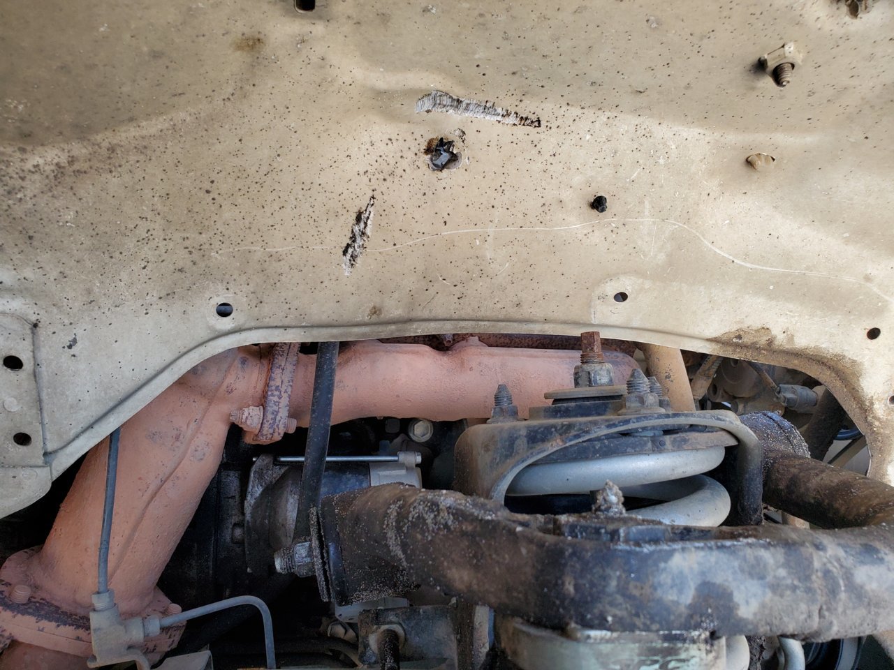

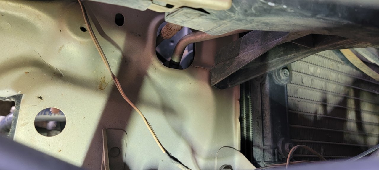

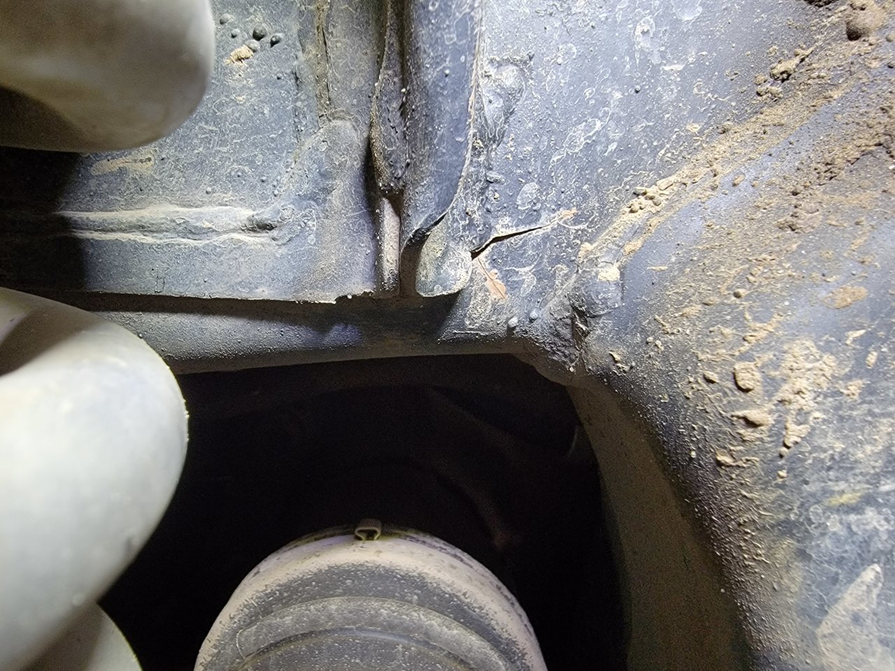

    May have smacked some boulders a little to hard. I'm guessing this is part of the core support. How do you guys fix cracks, just stop drill holes at the end and run a bead up the crack?
    Passenger side.
    Driver's side
  12. Jun 22, 2022 at 7:03 AM
    #352
    cynicalrider
    cynicalrider #NFG
    Jul 25, 2012
    #83399
    17,204
    Jersey
    01 SR5 TRD 4x4, '23 Bronco Wildtrak, 2017 HSQV FE350
    Drop bracket lift and booger welds
    I figure I will just let the core support go until I need to make one out of tube. :rofl:

  13. Jun 22, 2022 at 12:50 PM
    #353
    Squeaky Penguin
    Apr 5, 2012
    #76340
    10,101
    Brett
    Just looks like the normal fatigue cracks starting in your core support.
    You can try stop drilling and welding those up, but you'll be chasing them forever at this point.
    chrslefty[QUOTED], Wulf and TMFF like this.

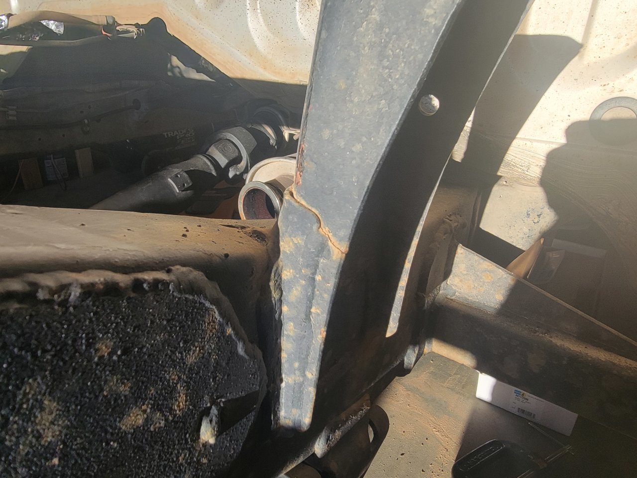

  14. Oct 4, 2022 at 8:53 AM
    #354
    turbodb
    turbodb AdventureTaco
    Feb 9, 2016
    #177696
    8,582
    Dan
    PNW
    2000 Tacoma Xcab 4x4 SR5 V6 TRD
    AdventureTaco

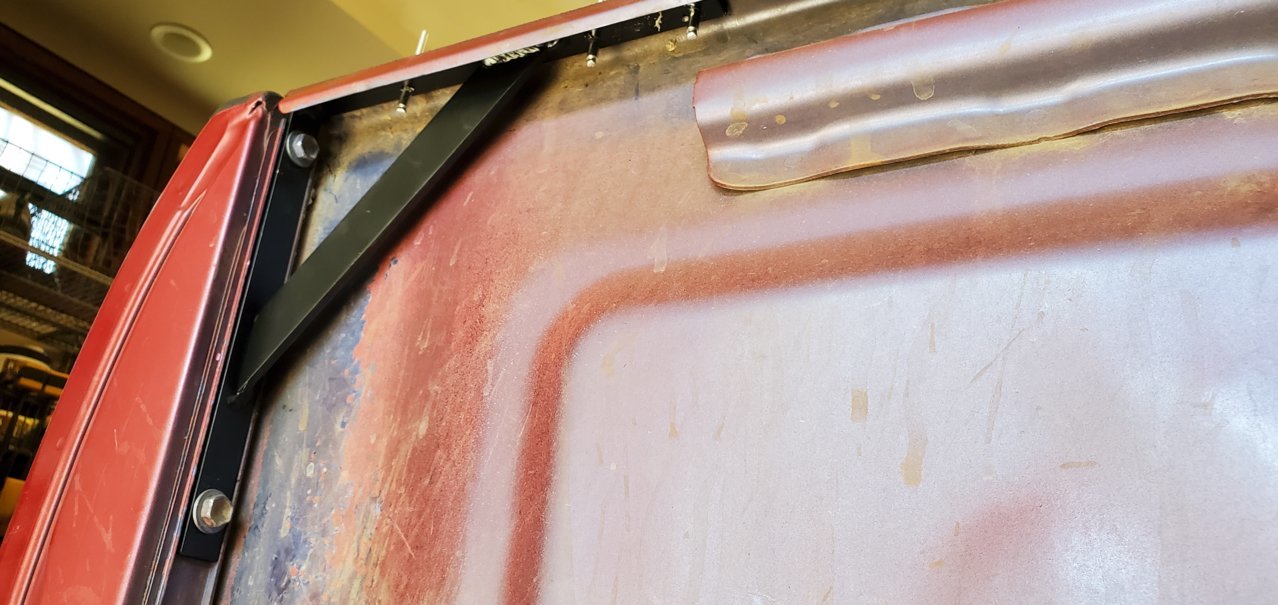

    Just a short, 16" crack in the bed...
    Used some angle and the original flange as a force spreader; should hold up well I think.
  15. Oct 4, 2022 at 11:07 AM
    #355
    hp415
    hp415 Well-Known Member
    Apr 16, 2021
    #362922
    157
    Paul
    1999 excab taco v6 TRD 5spd
    Woahhhhhh. Would bed channel stiffeners help to mitigate this? I know its the other end of the bed but may add more stability?
  16. Oct 4, 2022 at 11:23 AM
    #356
    Digiratus
    Mar 26, 2010
    #34006
    23,858
    Roaming the PNW
    The RedHead
    It may help to slow it down but I doubt it would prevent it altogether. Mine's starting to split in the same spot and I have the bed reinforcements for the tailgate area.
  17. Oct 4, 2022 at 11:34 AM
    #357
    Reh5108
    Reh5108 Well-Known Member
    Feb 18, 2013
    #97832
    5,805
    Idaho
    2004 SR5 4X4 2.7L Extra Cab
    OME lift, 4x sliders, Demello rear bumper, custom front bumper, Engo 9000lb winch
    Pretty sure you could install manufactured bed stiffeners on the other end. I made my own and they're the same triangle design I used by the tail gate.
    chrslefty likes this.
  18. Oct 4, 2022 at 11:45 AM
    #358
    betterbuckleup
    betterbuckleup Well-Known Member
    Jun 26, 2017
    #222483
    4,832
    Ian
    Concord, CA
    2000 Tacoma SC 2.7 4x4 5spd
    Don't know of anyone that makes a product for that end of the bed. I think making your own is the only way to go for that side.
    Either doing it how turbodb did or something like this
    The bed starts to split up there when you rack up some offroad miles with something mounted to the bed rails. I.e. RTT rack/topper
