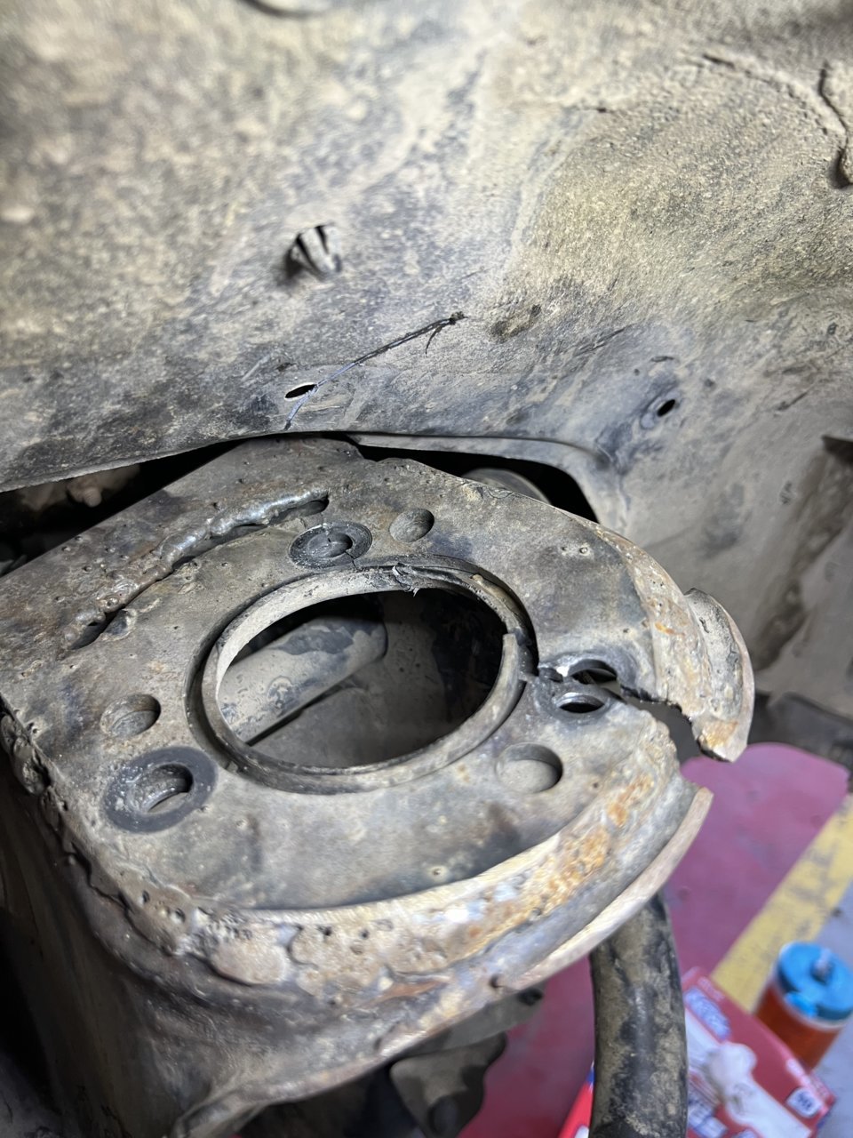

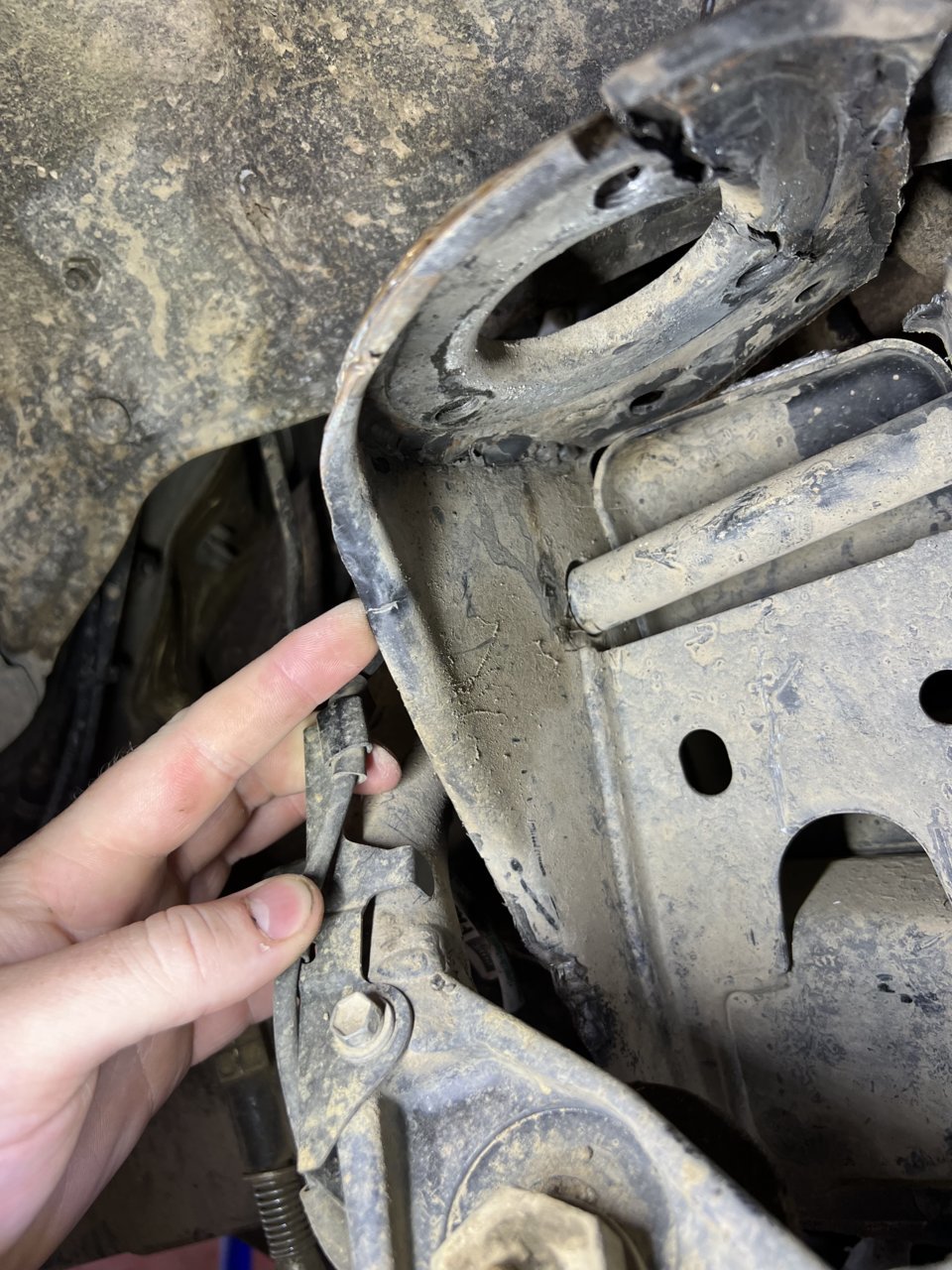

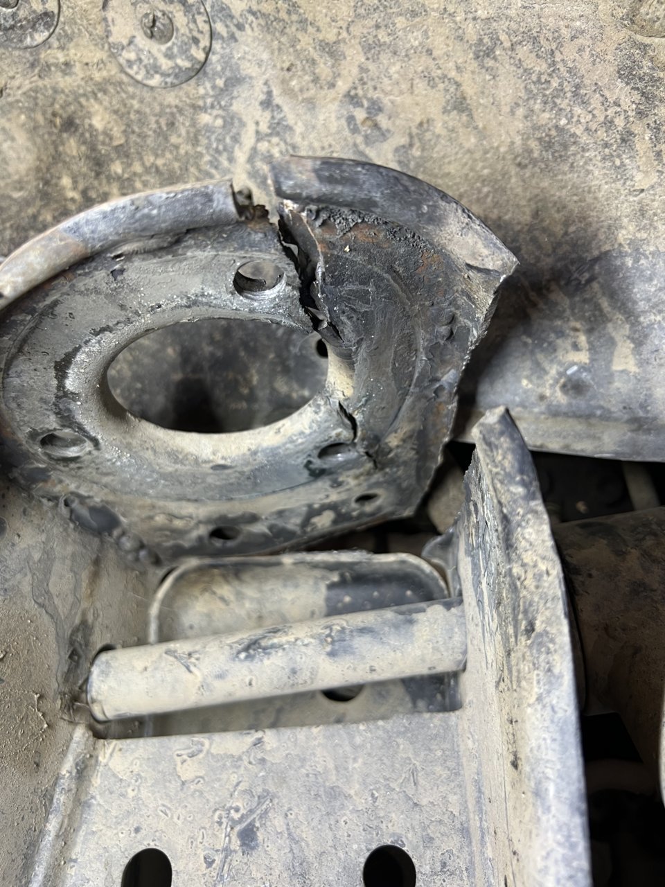

    Update on this since it’s my problem now. Rear side has a small crack as well in last pic

    Looks like the passenger side. What is/was your coilover setup?
    This is fixable. It's a lot of effort though.

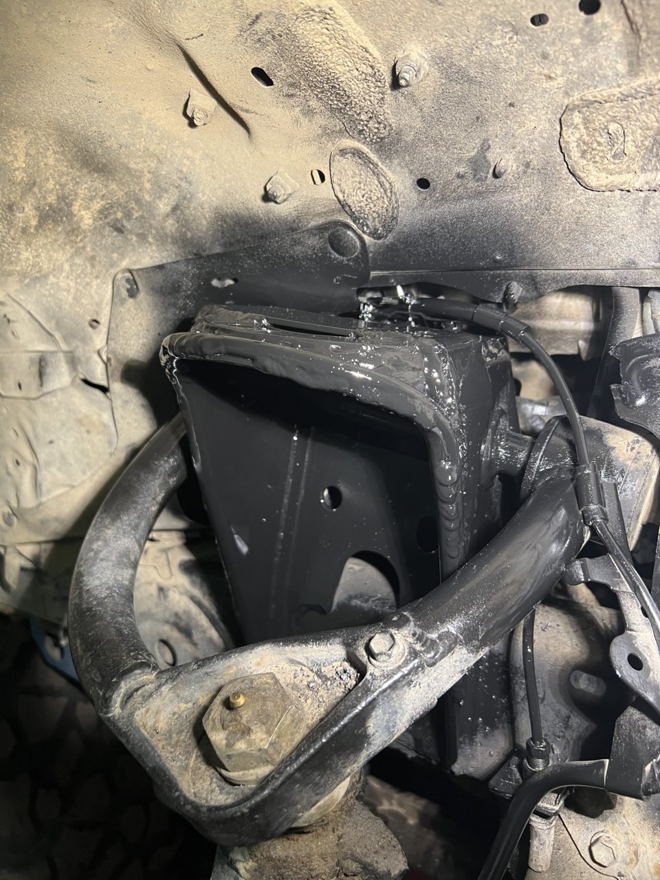

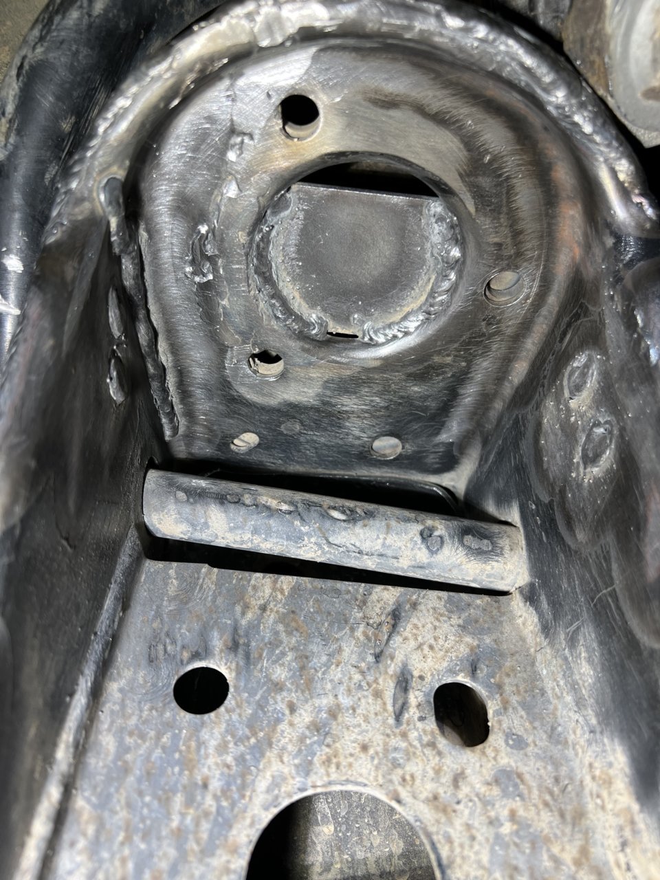

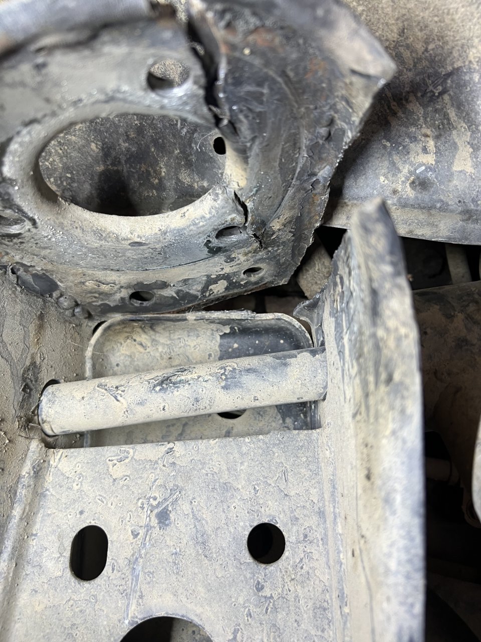

    It is @theesotericone 4 runner that I bought and am in the process of repairing.

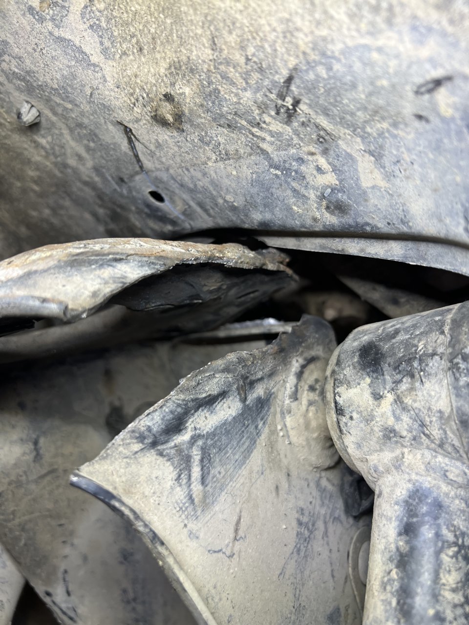

    I’ll drop a bunch of pics when I am on the computer but the driver side has a crack forming on the side as well and the top of the stock bucket is cracked in half at the same spot but the top reinforcement plate is not cracked. I am welding up all cracks and welding a 5/16 steel rod in the lip around the outside and maybe plating the sides or I am tempted to running a strap over top of the whole thing.
    Started tearing it apart yesterday and I’m currently deciding on how to plate it. both sides have all cracks welded up and the rod welded in place.

    '01 4WD, SR5, TRD & '13 TRDOR AC
    Lots of dust and custom dents, Check Build
    Nice work!
    Be curious how that holds up for you vs replacing the whole bucket.

    Yep time will tell. Part looked like 500$ and it says discontinued now so it would probably be harder to track down.
    Really I’m just too impatient to order a part and I don’t want to weld up that back side it seems like a huge pain.

    currently thinking run a strap over it and I have some room where I can plate it on the inside so I’ll see what I can do there as well

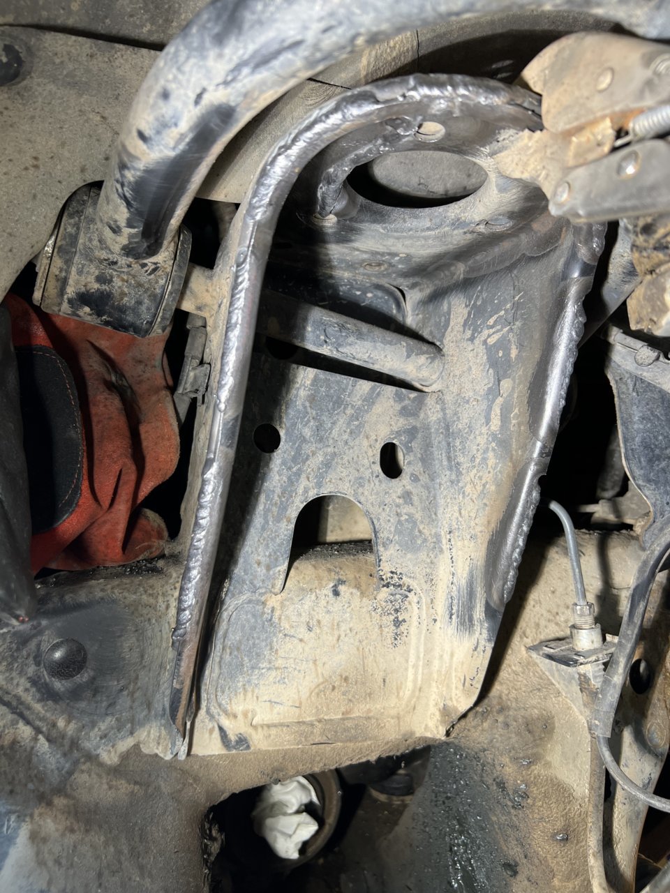

    @theesotericone ran straps on and off as well I believe between the trail gear straps breaking.
    I plan to order kartek to go back it unless someone else has another recommendation.
    I’ll set it on the ground tomorrow to flex it out but should be all done for now. Ran straps over the top and tapered the ends so I could get as much weld on the front as possible because the back was hard to get a good angle for a decent weld. They are also plug welded from the inside and welded on the top from the inside.
    Passenger
    Driver

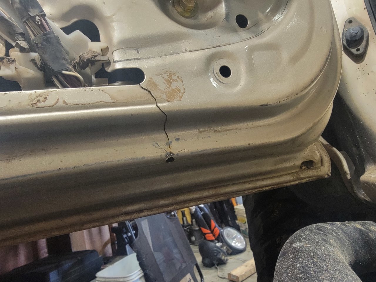

    Evidently my steering rack doesn't want to be attached.
    And just for fun, here's one from inside the door. :facepalm:
