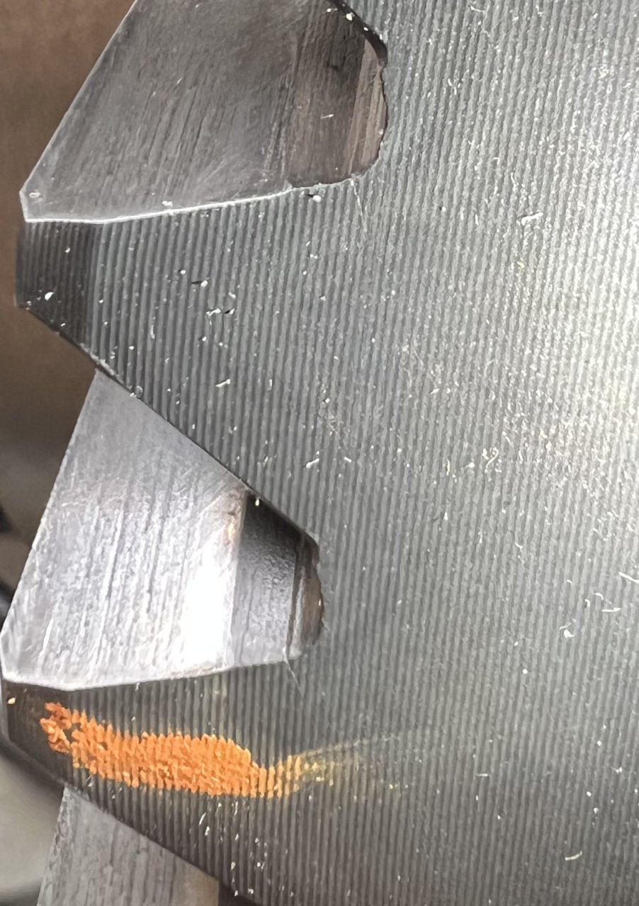

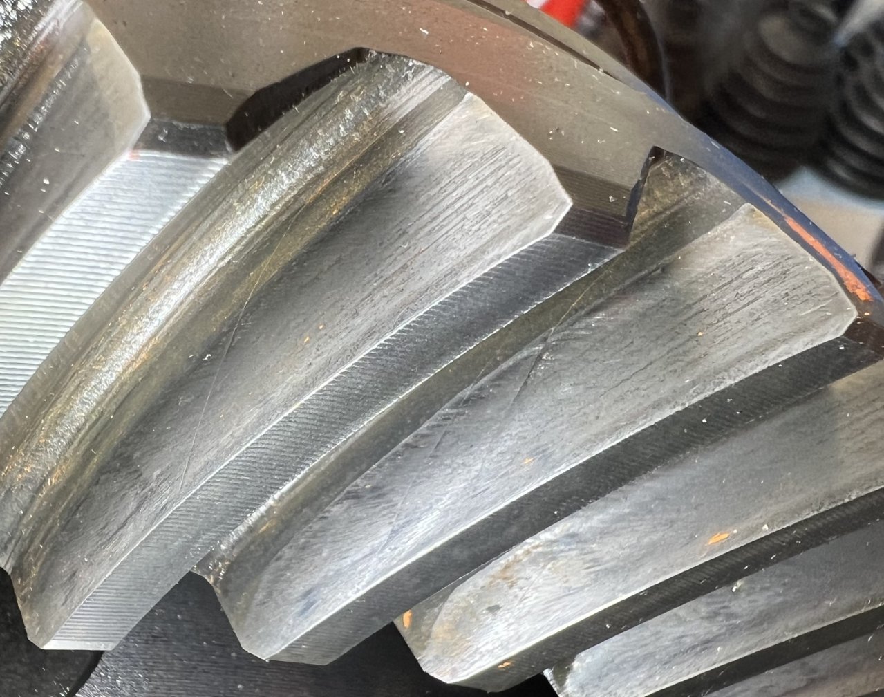

    8” rear cracking. 5.29s arb and 35s. Stock shafts still look fine.

    Did you just decide to pull this and inspect it or did you have any symptoms?

    Seal was leaking. I was welding up a couple skid plates on it and decided to pull it and reseal with rtv. After I put on the rtv I was spinning the pinion and came across two tight spots next to each other. Pulled it back apart and this is the only thing I found.
    I never keyed in on vibrations from it but it has been 4 months since I got it over 50 because the tires are so unbalanced from loosing a few beads.
