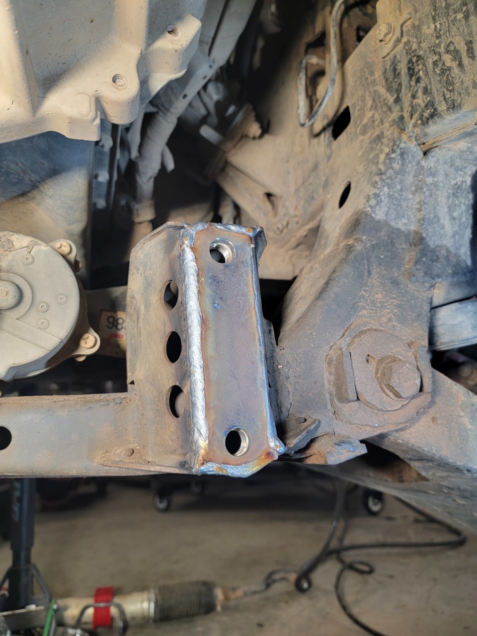

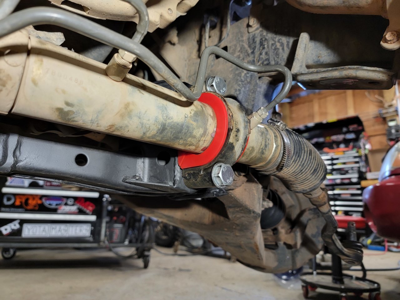

    Steering rack mounts hopefully fixed. The flat spot for the D bushing wasn't very flat anymore cause the bolts were pulling out, so I replaced it.

    surprised the whole mount wasn't fucked. Thing is pretty flimsy.
    Think at one point Eric made a full one out of 3/16. Maybe. Or that might have been Jerry.

    I looked over the rest of the mount and didn't see any other issues. :notsure:
    Hopefully it doesn't just rip it apart now that everything else is more solid.

    Drop bracket lift and booger welds
    There was a company that was making a billet D mount IIRC too but it wasn't cheap.

    I'm not sure about that. Mine was all sorts of bent. I hammered it back relatively close before reinstalling.

    Seems that people either rip off the mount onto the frame for that side of the rack, or the D shaped clamp

    I think you’re the exception to the rule :p
    The OEM mount may not be the perfect design, but seeing how the mount can deform (which you just replaced) I don’t think a $120 billet clamp is the right solution.
