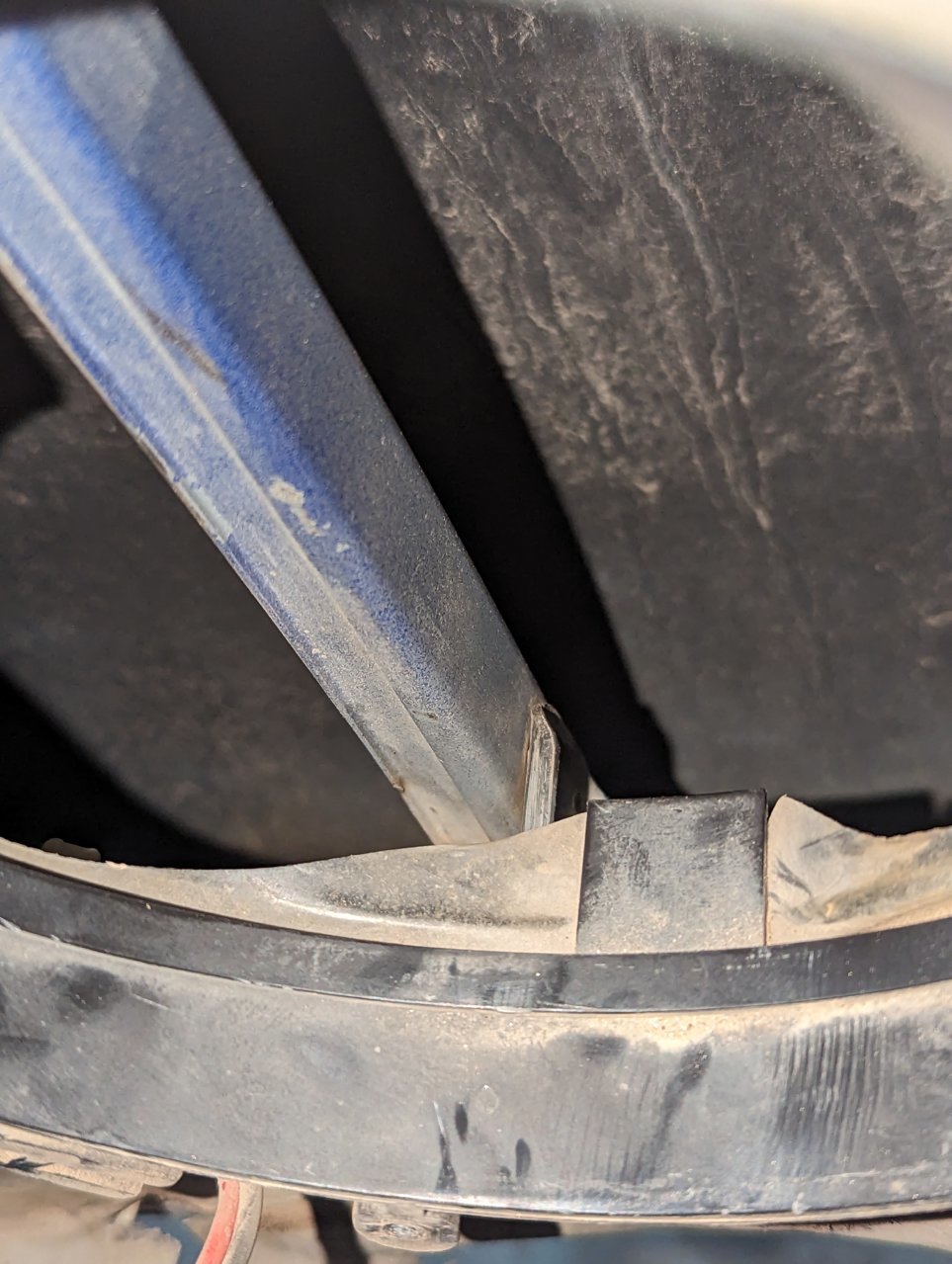

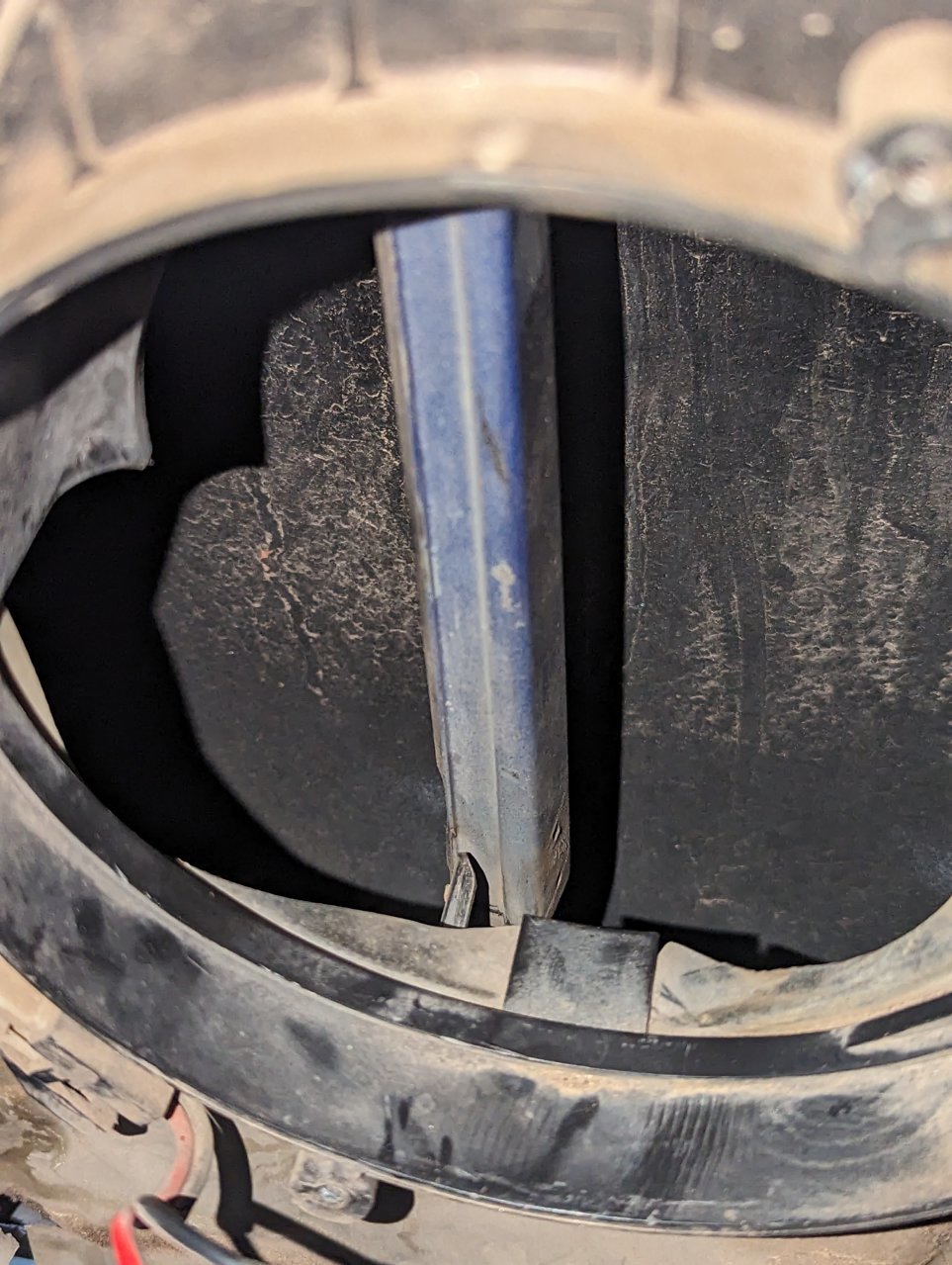

    Busted the welds that hold the window track to the door. As you'd imagine it makes a ton of noise if the window is not rolled all the way up into the window frame
    How it's supposed to sit:
    Reh5108 likes this.

    That makes a lot of sense, probably the case on mine, I just always figured the window tracks had plan in it and just rattled when it wasn't all the way up.

    Before I opened it up I was thinking I just needed to tighten the bolts that hold the glass in to the regulator but was unpleasantly surprised. I'll do my best to throw a weld on there and see if it lasts any amount of time lol

    I bet mine is snapped off, its got a real bad rattle when its cracked. slightly better when all the way down, but still a knocking style sounds on the inner or outer door panel.

    Threw some booger welds on it and it's quiet and smooth. Hell yeah! What was I doing again? Oh yeah back to my stereo install :homer:
