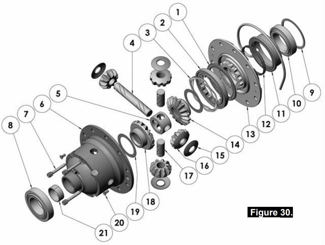

    I had an air leak on mine that was blowing air back into the diff housing and pushing gear oil out the breather when I used my front locker.
    Sent it back to ECGS. #13 had to be replaced because the seal housing (11) had ended up digging into it. Not sure why the seal housing O-rings in front of it failed, but maybe I got a poorly assembled one from the factory or something.
    Glad I had the ECGS warranty on that one.

    Dang I better pull mine apart sooner rather than later. I was hoping to get away with replacing the O rings (12) and maybe seal housing (11) and bonded seal (1)
    Sounds like the same symptoms, blowing air and gear oil out of the breather. Sometimes it will still lock up but the compressor still cycles more than normal. Only two trips and maybe 150 miles on it since it started so hopefully it didn't tear too much up. Hopefully I can figure it out myself since it is outside of 5 years from ECGS and they already replaced a broken rear for me even though they shouldn't have.

    If the gear oil is sparkly coming out, that would be my guess as to what it is.

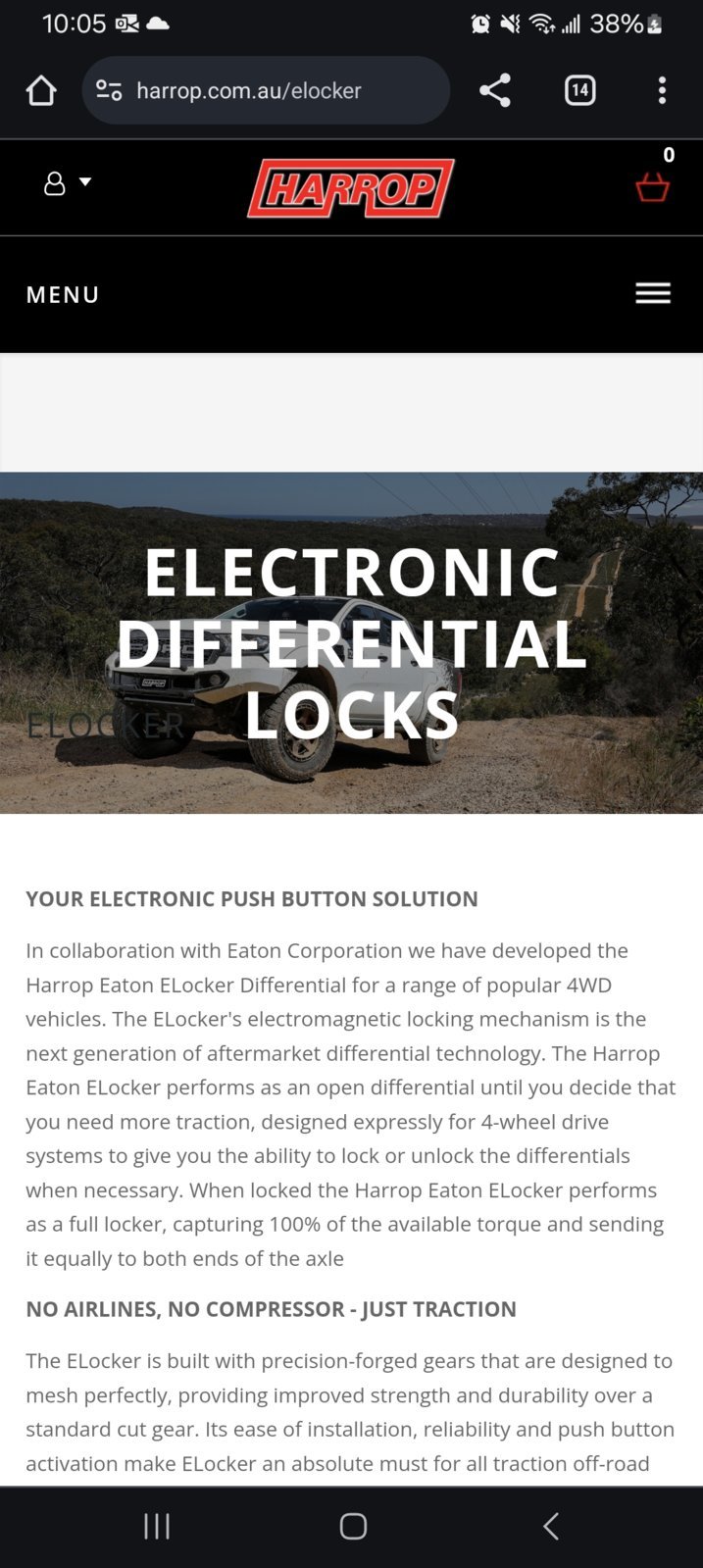

    Eaton and harrop are the same.

    One is etched Eaton and the other is etched Harrop. How are they the same?

    Because they are made in collaboration. Harrop designed it and Eaton produces. No matter who's box art you buy, it's the same product.

    I call it Eaton because that's what it's branded as over here. I would hate for someone to try and import a Harrop because someone misled them.

    The white/blue box didn't say Harrop on it.
