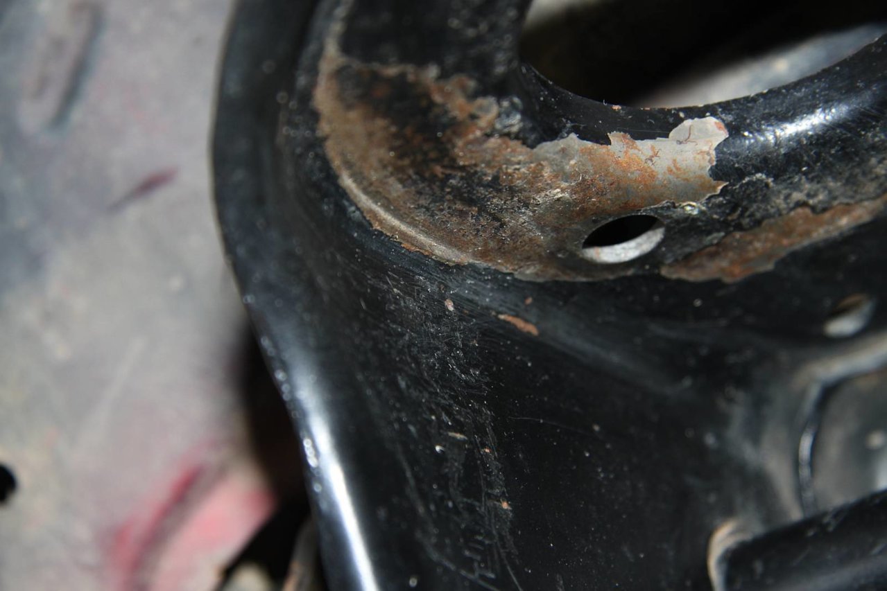

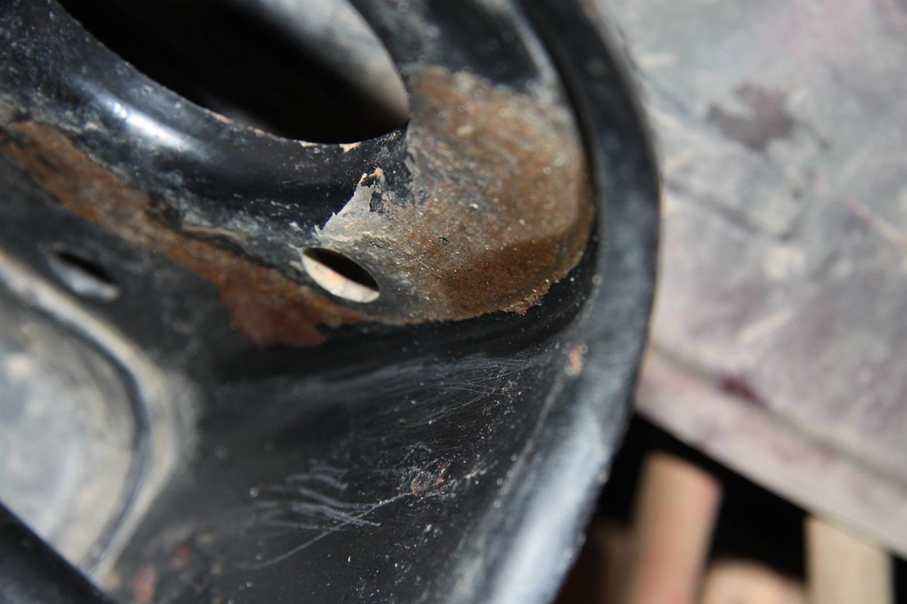

    That is my intention. It is interesting that all of the reports I've seen of this failure has been on the passenger side.
    https://www.tacomaworld.com/threads/broken-coil-bucket-tower.432018/#post-12457136

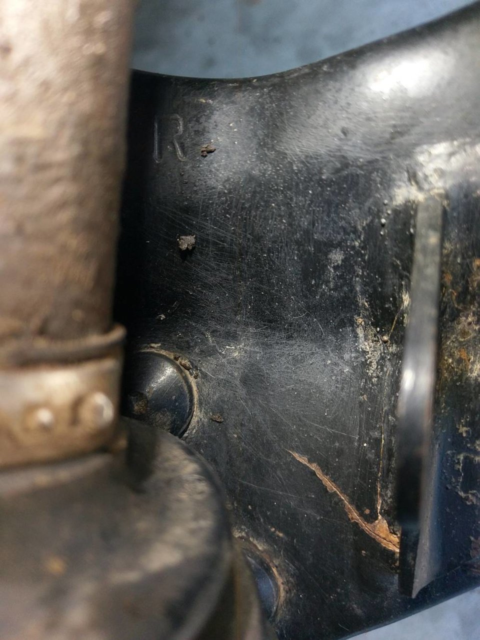

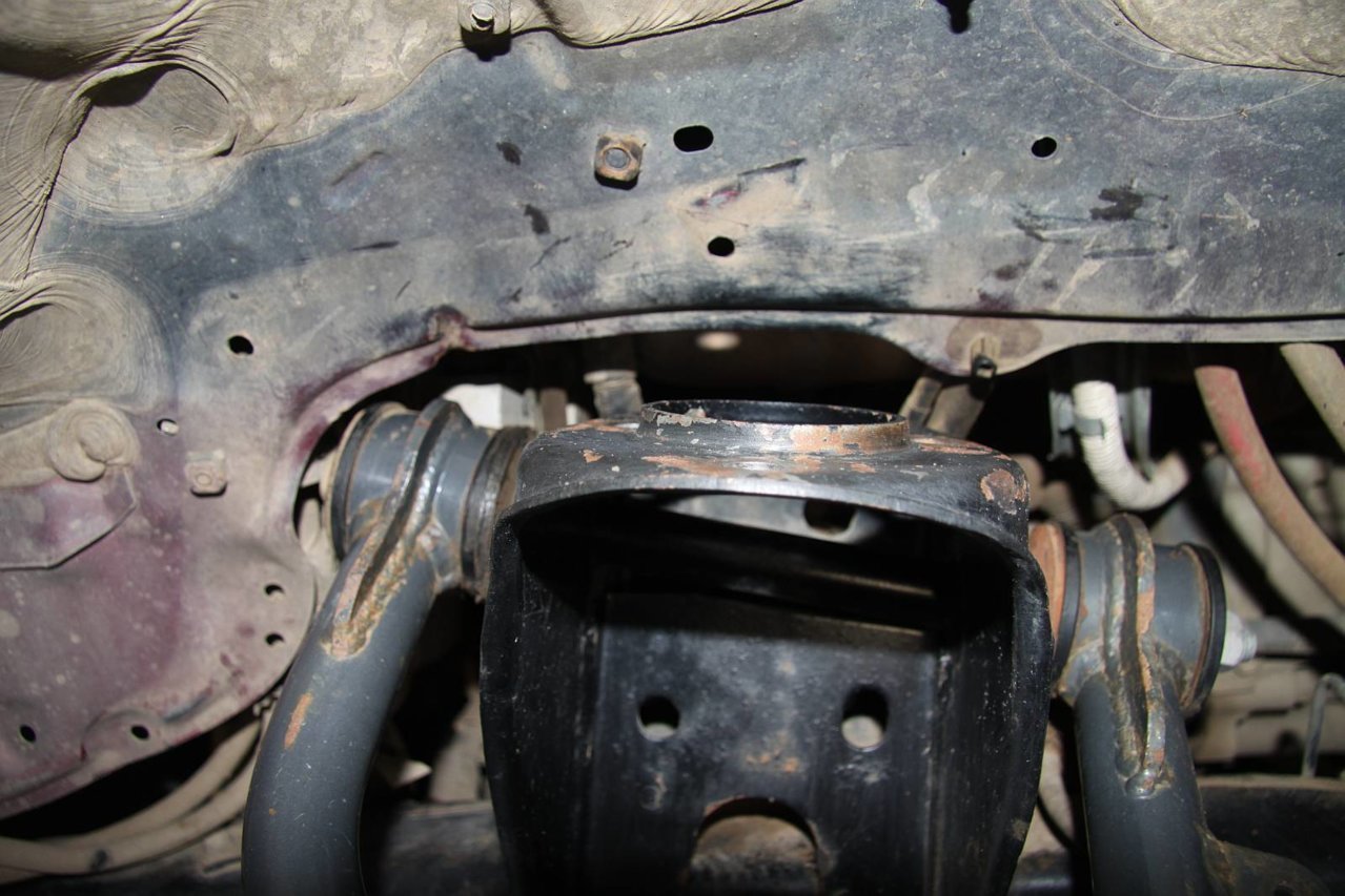

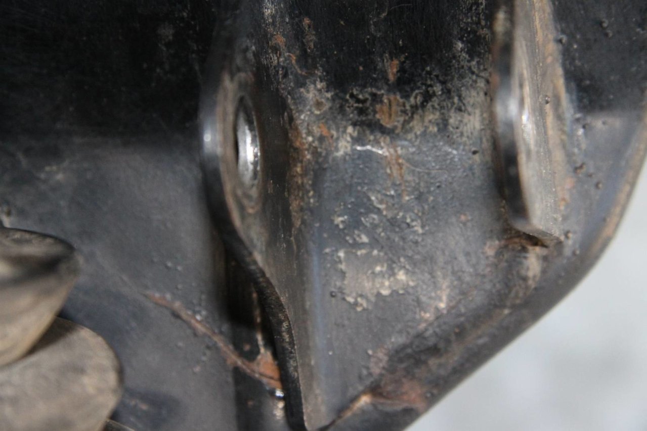

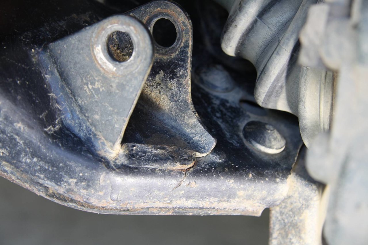

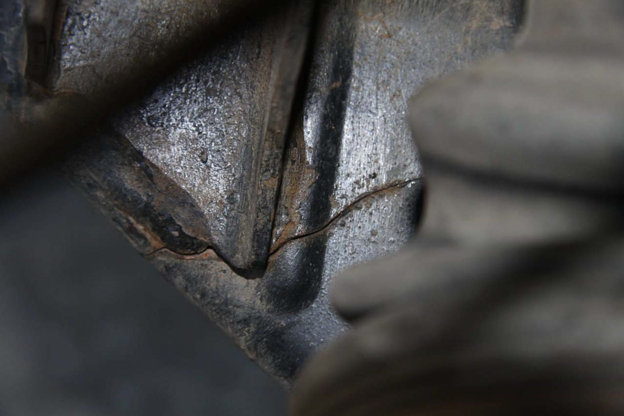

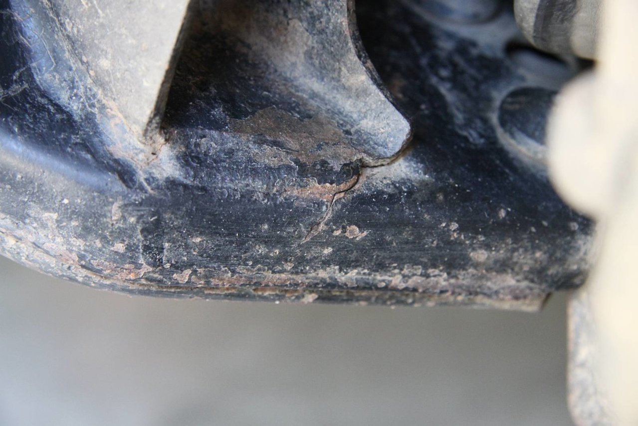

    Cleaned up 18 years of crud to do a more thorough inspection. Both LCAs have damage where the lower shock mounts are welded to the arms.
    Driver side:
    Passenger side:
    Brett @Squeaky Penguin the driver side coil bucket is intact and has no cracks that I could see. But there are definitely lots of signs that it is flexing. A lot of the powder coating has flaked off. I think it might be from the metal deflecting.

    Those LCA crack looks familiar! Interesting on the coil bucket.
